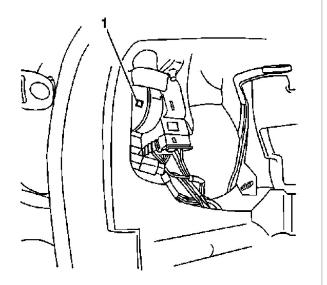

Since I got the car I would get it started and you'd have to try to turn sometimes for 10-15 minutes and then finally it would just turn over all the way and start. just finished repairing the brakes got it all done went to start it again and it wouldn't start, all day! I let it sit overnight recharged the battery and it still won't turn over at all won't even go out of the lock position generally the security light Will be flashing this time it's not it's not on at all help!

I probably didn't explain it right in my question, the key doesn't turn. My steering wheel isn't locked. The shifter doesn't move and battery is fully charged. Normally I just keep trying to turn it and it will release and allows me to turn over and start.

Thanks for the video it helps. it looks like the ignition key tumbler need to be replaced due to wear which is common.
1 Disconnect the battery.
2 Remove the radio.
3 Drill a pilot hole through the plastic housing with a 1/8 inch drill bit.
4 Drill a larger hole at the pilot location, and slightly into the ignition switch lock cylinder surface to break the release button retaining spring using a 1/4 inch drill bit.
5. Use a magnet and remove the retainer tab (2).
6. Grasp the ignition switch lock cylinder and remove it from the switch housing.
