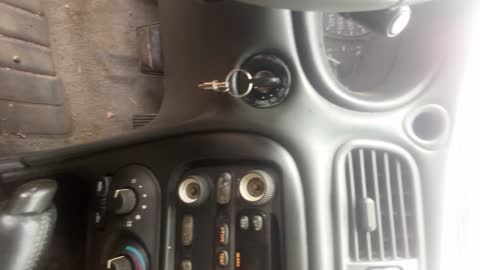

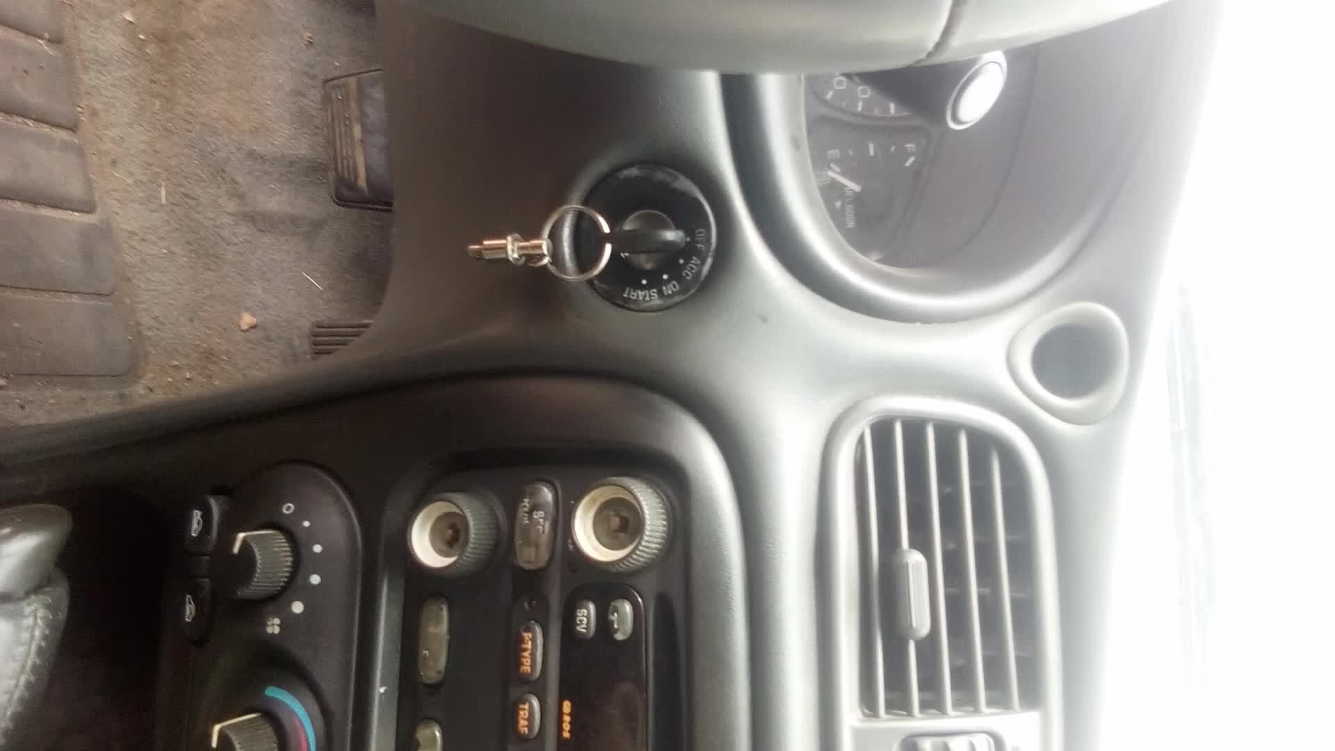

I probably didn't explain it right in my question, the key doesn't turn. My steering wheel isn't locked. The shifter doesn't move and battery is fully charged. Normally I just keep trying to turn it and it will release and allows me to turn over and start.

Not much to show but here's a short video.
Sep 3, 2025 at 4:36 AM
  • 55,224 POSTS

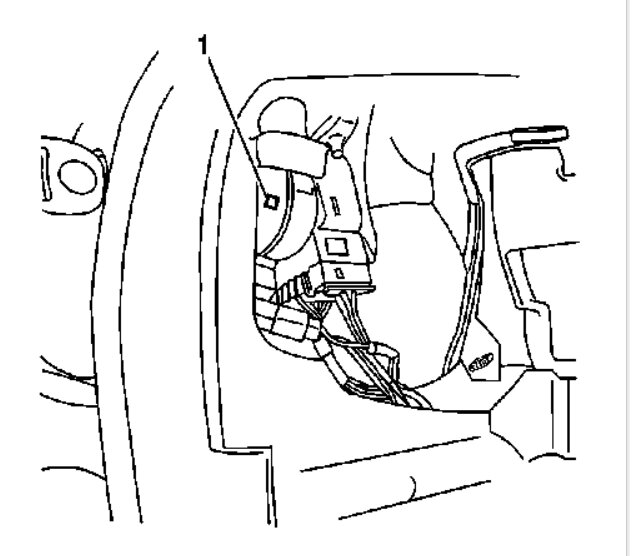

Thanks for the video it helps. it looks like the ignition key tumbler need to be replaced due to wear which is common.
1 Disconnect the battery.
2 Remove the radio.
3 Drill a pilot hole through the plastic housing with a 1/8 inch drill bit.
4 Drill a larger hole at the pilot location, and slightly into the ignition switch lock cylinder surface to break the release button retaining spring using a 1/4 inch drill bit.
5. Use a magnet and remove the retainer tab (2).
6. Grasp the ignition switch lock cylinder and remove it from the switch housing.
