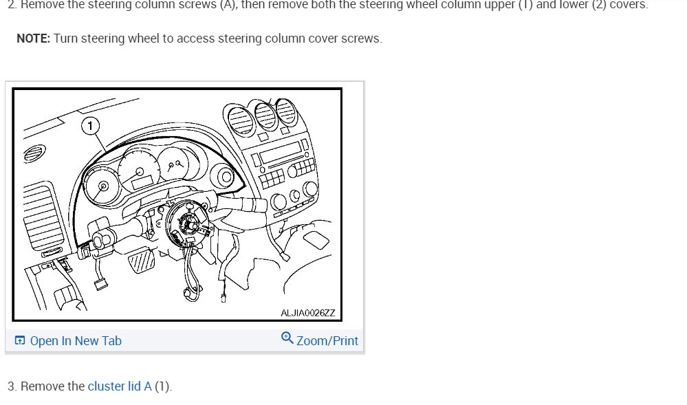

I have hardly any power from a stop until about 15mph then all the power comes back. Once I hit about 40 MPH the key light on gauge cluster comes on, the car jerks slightly, speedometer drops to zero, and the RPMs shoot up as if the transmission suddenly shifted to lowest gear while I’m going 40 MPH. Please help any advice will do.
Aug 9, 2023 at 11:35 AM
  • 55,802 POSTS

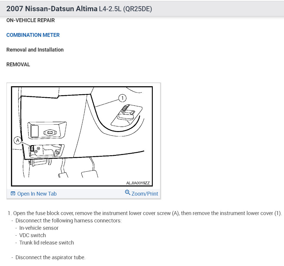

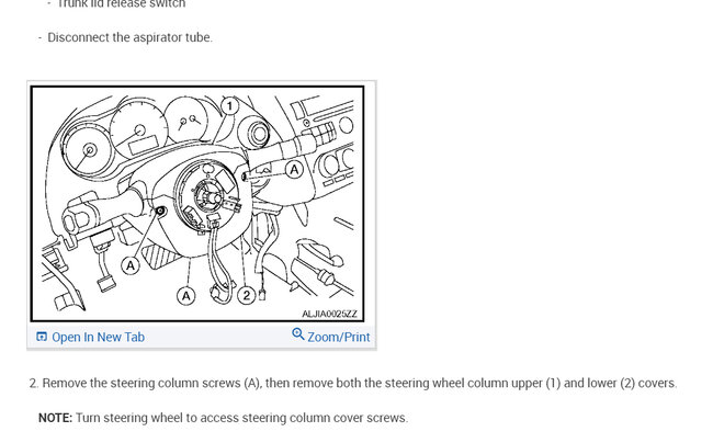

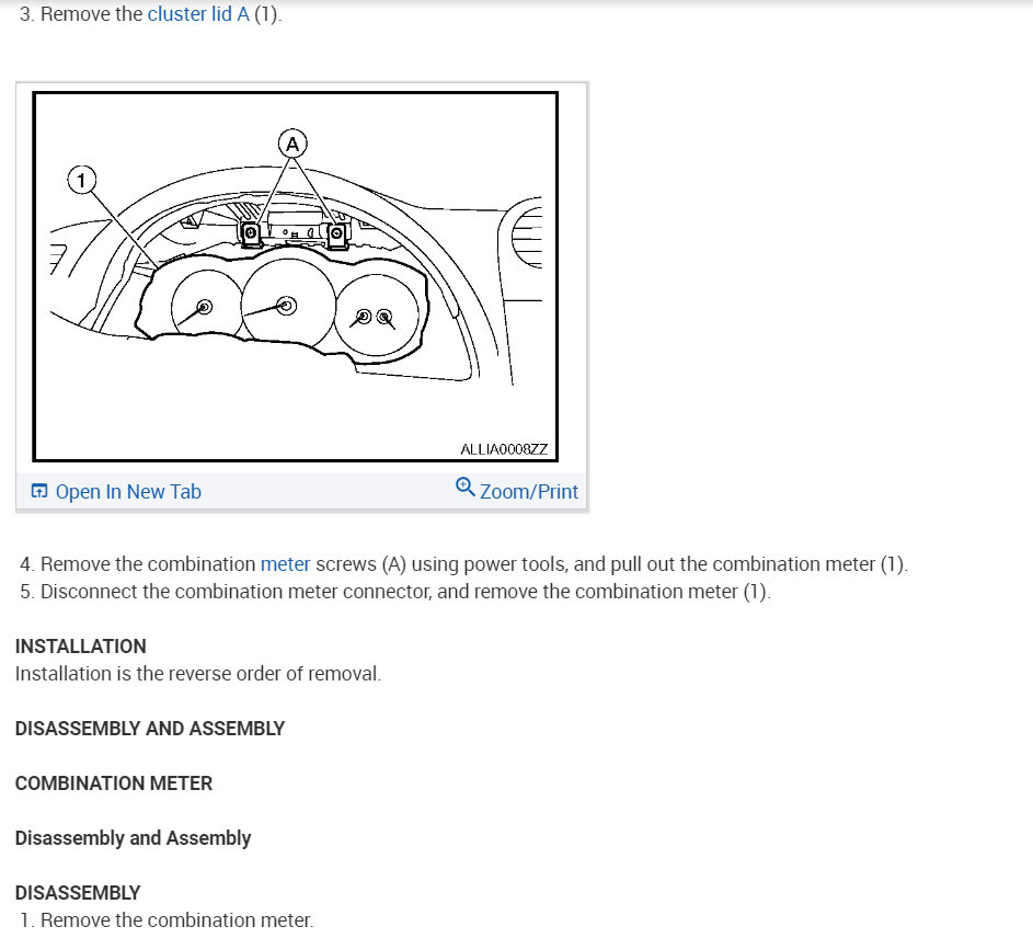

I have seen the IPC (instrument panel cluster) short out and cause this problem, but to be sure let's do a CAN scan. You can get a CAN scanner (Controller Area Network) which will work on most cars from Amazon.
here is a video to show you how:
https://youtu.be/u-4syLc-ifQ
Here is how to change out the IPC in case a code comes up for it. Check out the images (below). Please let us know what happens.
