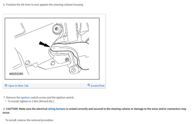

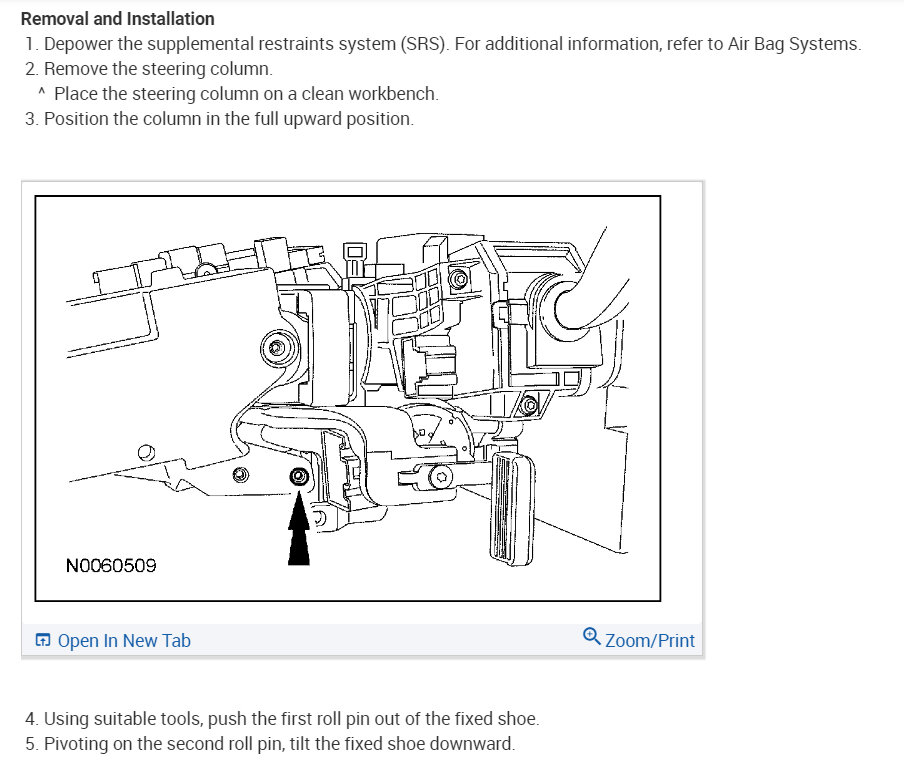

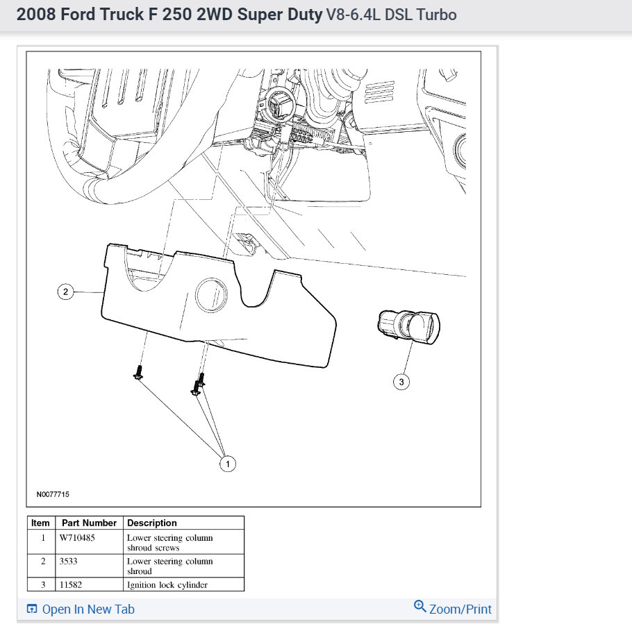

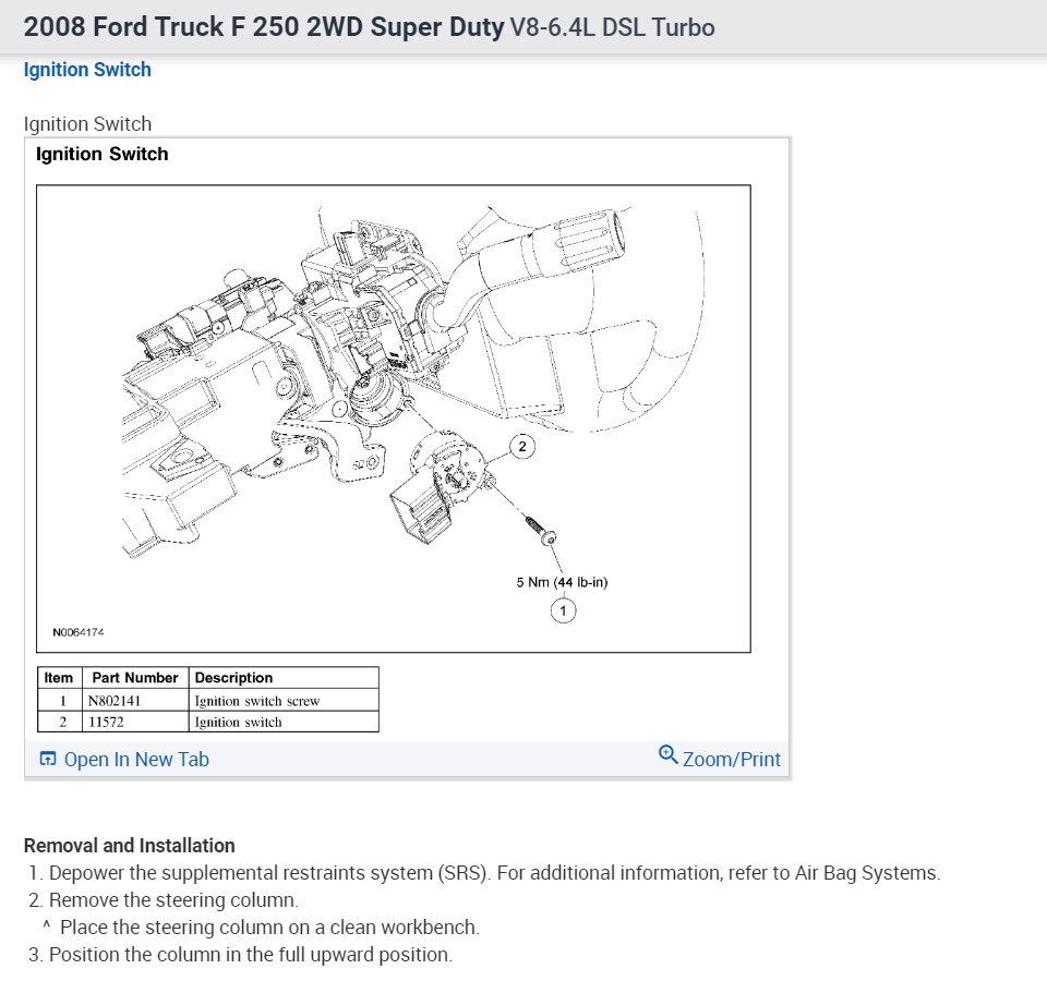

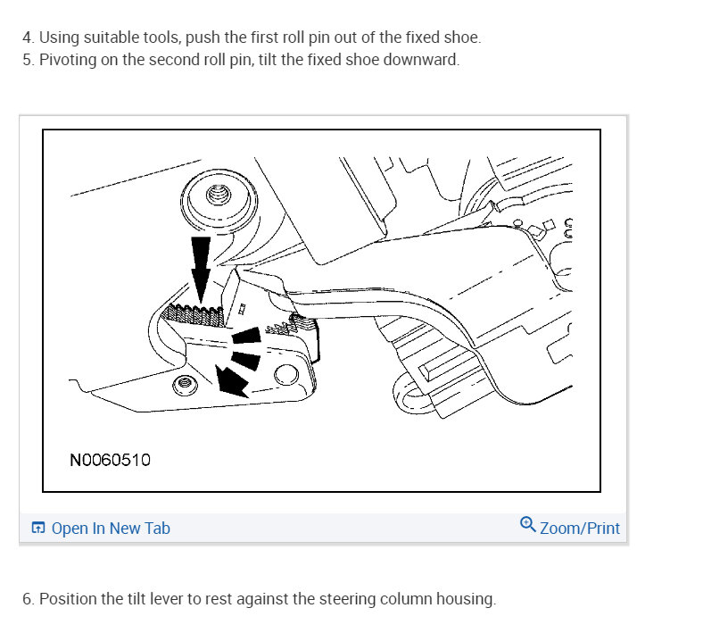

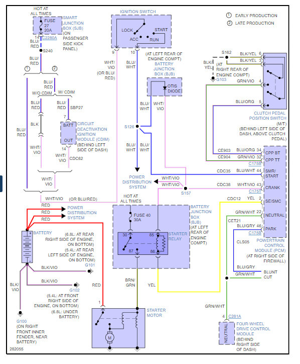

I just finished installing a new used engine in my truck listed above power stroke. When I turn the ignition key to start and let go it stays forward and is cranking so I have to manually turn it back and it shuts the truck off. I've changed out the tumbler and ignition switch. Now I'm stuck and need some direction. Thank you
Jan 23, 2023 at 1:01 AM
  • 55,721 POSTS
Sure, the problem is the ignition switch (electrical part), here are instructions on how to change it out in the images below. If you have changed this part already, can you remove the switch and work it manually to make sure the return spring inside the switch is working? If so, check the control shaft between the lock and the switch; everything must work smoothly. Check out the images (below). Please let us know if you need anything else to get the problem fixed.

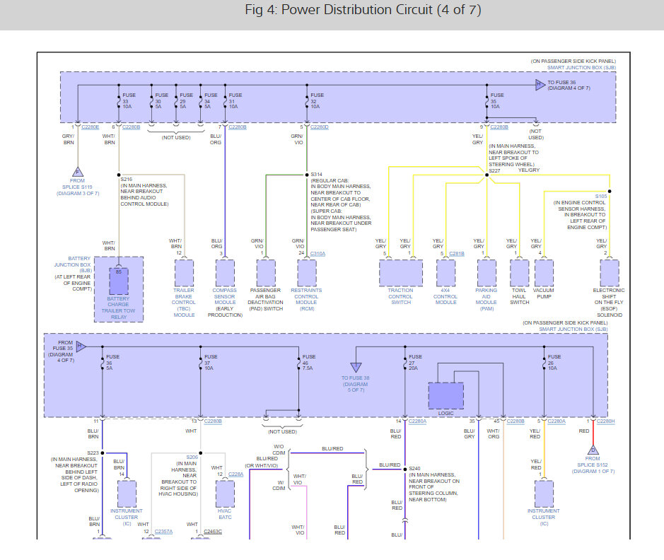

So, when I unplug the electrical connection from the ignition switch the key snaps back perfectly but when the switch has power the key stays forward in the cranking position. I also pulled the starter solenoid fuse and the key functions as it should.
Jan 23, 2023 at 6:32 AM
  • 55,721 POSTS

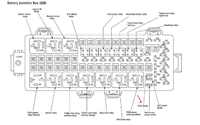

lol, I love this job, always something new. Did it act this way with the old switch? It sounds like the OTIS diode is not working. It is located in the fuse panel under the hood, left rear. Here is the starter wiring diagrams so you can see how the system works. Here is the location of the diode. Please let me know.

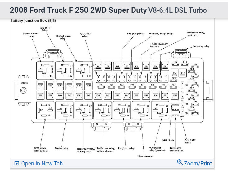

Do you have a power distribution wiring diagram you can send me? The fuse box on the passenger side kick panel. Is that DIODE fuse you circled for diesels?

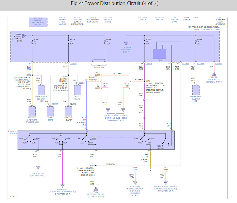

Did you find the Diode? here are the wiring diagrams for the ignition switch. The fuse panel is the same for the diesel engine truck. Let me know, this is a good one!
