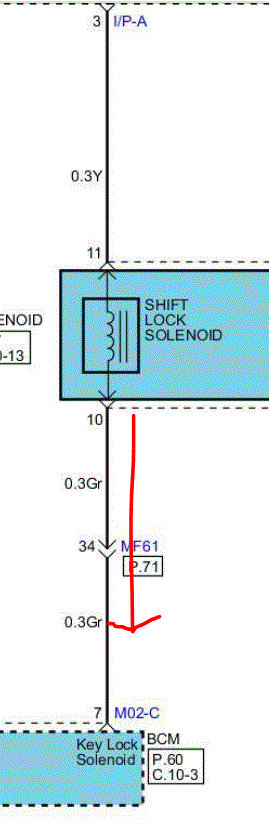

Unable to turn key to remove it the from ignition switch. So, I disconnected the cable to the battery to keep from draining my battery. Only then will the key come out of the switch. Won't turn pass axillary position.
Jun 17, 2020 at 8:49 AM
  • 110,251 POSTS
I'm trying to understand. The key will come out of the switch when the battery is disconnected? Is the shifter lever engaging fully into park? Can you hear the park interlock actuator click when you press the brake pedal?
If you look at the attached pic, it shows how the interlock and ignition work together.

Yes, the key will come out once battery is disconnected. Yes, the shift lever seems to engage fully into park. But not sure about any sound from the actuator. I'll check on it on the morning.

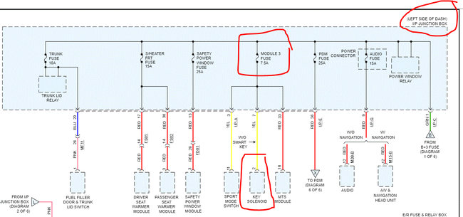

Hello, my husband just checked each fuse in the motor box, none are burned out. But, was unable to check the relays. The gear shifter and brake does make the clicking noise when it engages. What now?
Jun 18, 2020 at 3:18 AM
  • 110,251 POSTS
Okay, I have one last fuse to check and what will sound like a stupid question. The fuse is in the vehicle (see pic attached). The stupid question is this. Are the brake lights working?

Yes the brakes lights work.
Jun 19, 2020 at 12:48 AM
  • 110,251 POSTS
Okay. I know that sounds like a crazy question, but the brake switch is what releases the lock. Have you checked the other fuse I suggested? Also, is it possible to upload a video as Ken mentioned?

Thanks for your help in this matter. I'm heading to my mechanic today and he will run a diagnosis on it.

Hello, okay finally got my car back. it was the solenoid switch to the key ignition. All is good now and I was told to make sure I remove the key more slowly, in case I'm pulling it out to quickly.
