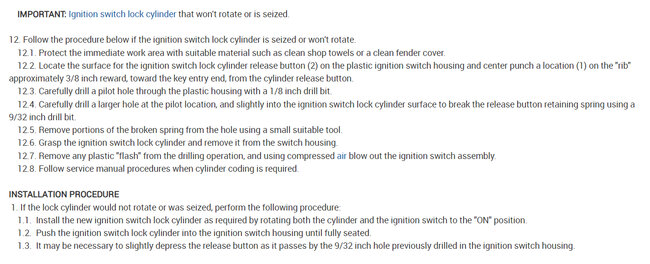

key will not turn in the ignition to on or start position?
164,000 MILES • 3.8L • 6 CYL • 2WD • AUTOMATIC
DMAC111

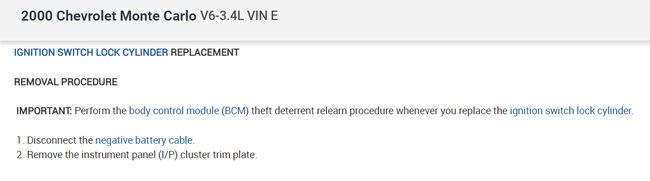

So, my key will not turn in the ignition to on or start position unless I jiggle the shifter and sometimes it takes quite some time. so, I started to put my car in neutral and the car off so that I could restart the vehicle because if I put it back into Park turn it off and take the key out I end up having to go to the whole process again and trying to get it to turn over I've been stuck now for a day haven't been able to get it to turn on.
Sep 26, 2024 at 5:17 PM
  • 55,743 POSTS

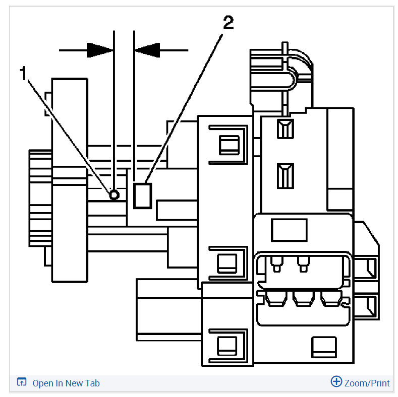

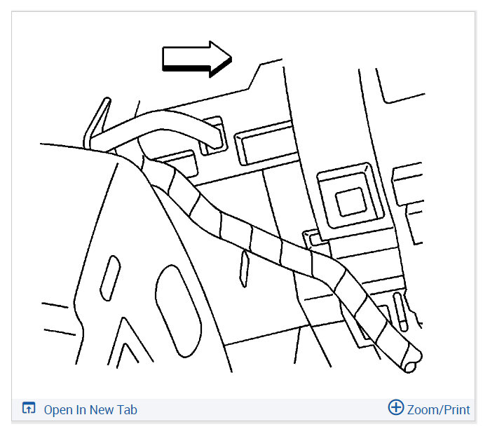

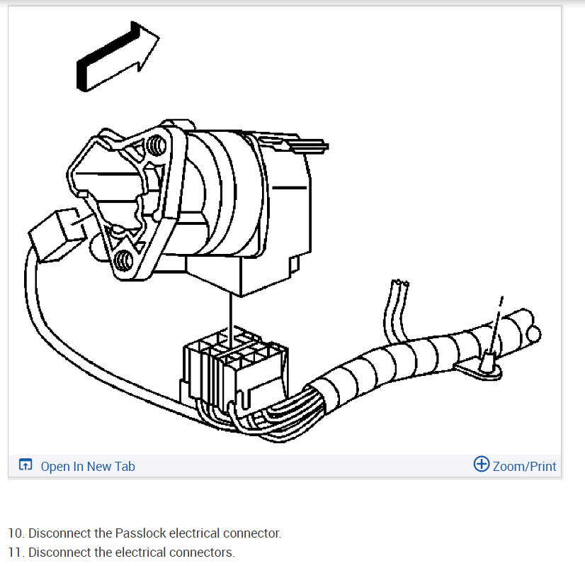

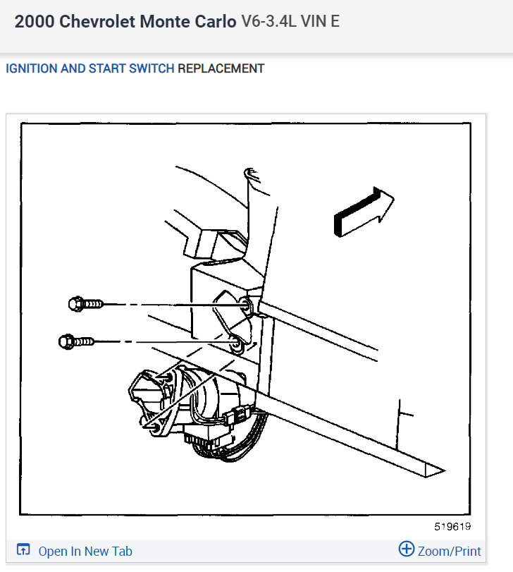

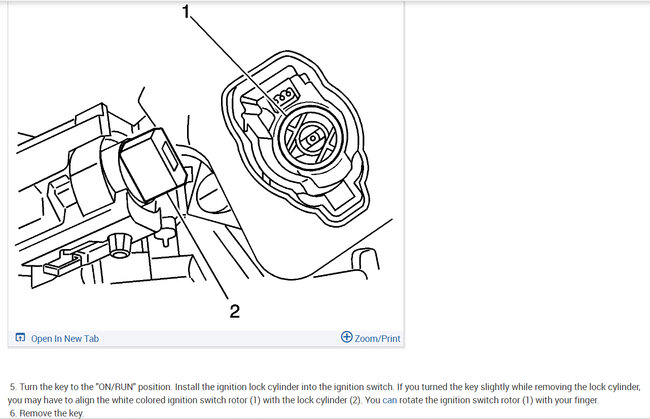

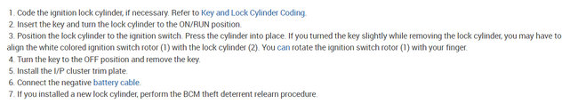

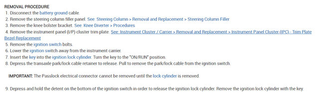

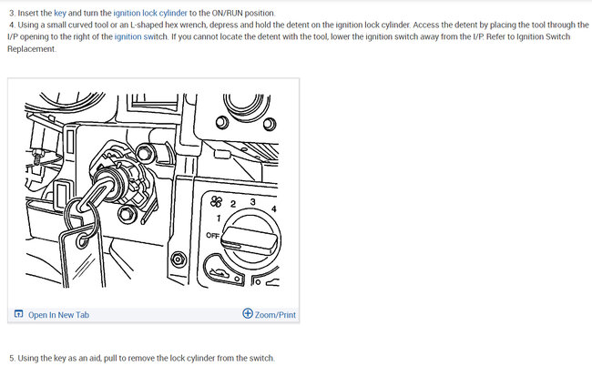

Yep, this is common when the key lock wears out, here is how to change it out, here is how to fix the problem. Check out the images (below). Please upload pictures or videos in your response of any problems so we can see what to help you with.
