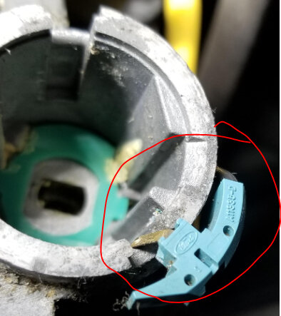

Key Ignition broken plastic piece?
2000 FORD RANGER
69,000 MILES • 3.0L • V6 • 4WD • MANUAL
ARUSHO
  • 35 POSTS

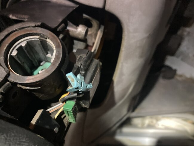

I took the ignition out and the blue piece came out of the edge and a piece was broken in there. It was a small tab that was broken off. Do you know what this is? Looks like I need to cut the wires and replace it. Thanks!
Sep 23, 2023 at 12:41 PM
  • 110,244 POSTS
I took a look at the pics you attached. I'm not 100% sure what that is. Is there anything attached to it? For example, is there any wiring to it?

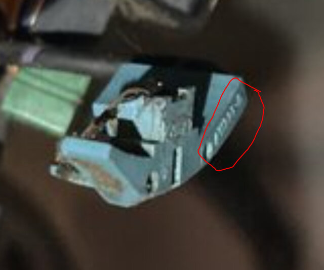

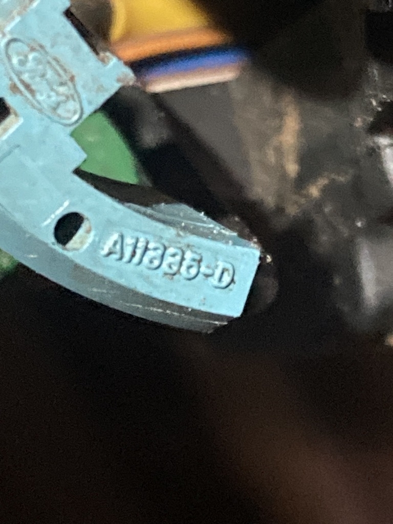

Also, if you look below, I copied a portion of your pic and circled what appears to be a part number, but I can't read it. What does it say?
See pic below.

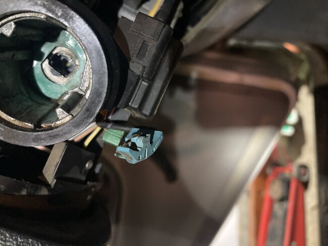

I thought I responded earlier but I don't see my message now. Here it is. There are wires going to it.

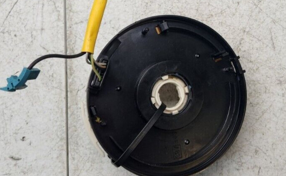

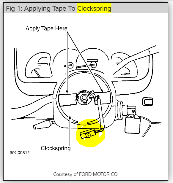

The component you have is part of the clock spring assembly. See pics 1 and 2 below. Now that I figured out the part is A11335D and not A11885D, I was able to find it.
That part should be related to the door open, or the key in the ignition indicator.
Take a look below and let me know if that helps.

That looks like it. I will have to order it somehow. Thanks !

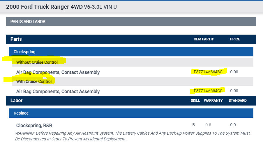

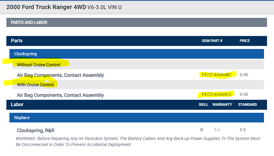

Interestingly, it can be called a clock spring, or an airbag contact assembly. If you look below, I attached the OEM part number. There are two different ones based on if you have cruise control or not.
Pic 1 shows the OEM part numbers, and pic 2 shows an example with cruise control. Simply google search Ford part number xxx.
Let me know if this helps.

I found the part, Thanks. It has No Cruise Control (Manual 5 Speed) so I will order that.
