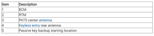

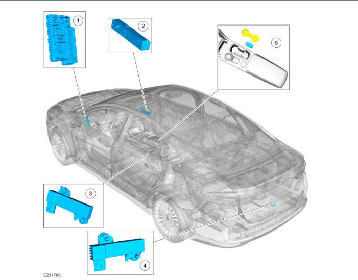

I attached two pics below. The first one identifies the PATS (passive anti-theft system) components and their locations. Pic 2 is the legend for the parts shown in the picture. Let me know what your friend was closest to when the problem occurred.
Jul 19, 2023 at 2:26 PM

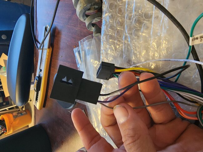

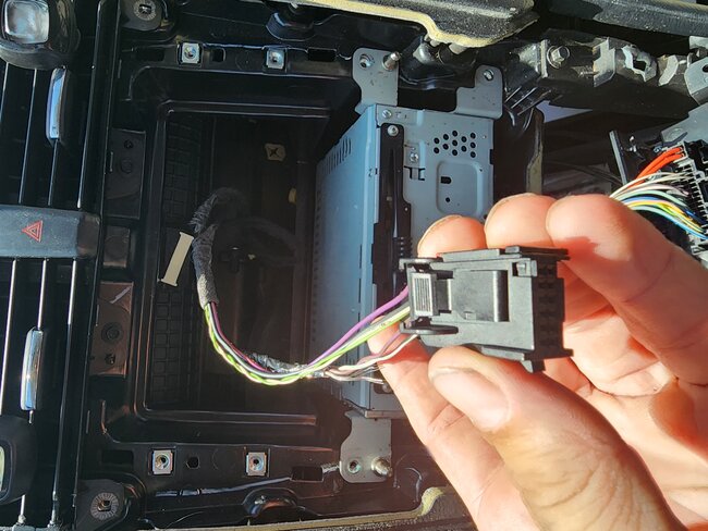

I am posting a picture of the connector that I'm sure the short is connected with. And a picture of the wire harness that was supposed to connect with. The purple wire came loose from the harness with the pin intact. My friend tried sticking it in holes on the connector that leads into the dash, and it shorted out something. Also note the connector in the dash is the one that goes to the back of my original radio screen. It's a 4-inch sync screen.

Here is what we need to do. I looked at the pics, but don't know what he plugged them into. So, we really need to start with scanning the can-bus.
CAN stands for controller area network. Basically, the different modules are tied together via a few wires. This type of scan will retrieve codes regardless of the module storing them. If I had to guess, I would say there is either an issue with the body control module or the PATS.
