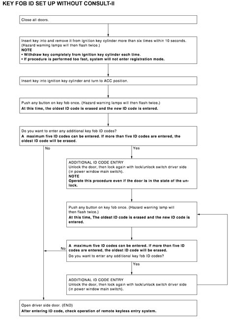

I want to see if there was a way to program this key fob. I don’t know if it’s the original key fob.

Take a look through this link and let me know if it helps:
https://www.2carpros.com/articles/how-to-re-program-a-key-remote-fob
____________________________________
If you have one of the original key fobs, follow the directions in the attached pic. They are specific to this vehicle.
Let me know if it helps.
