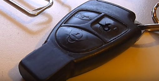

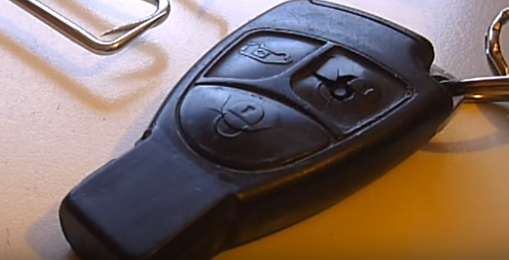

Couple questions to start. Do you have an optical key? Pictured below. It doesn't have to be exactly like this one but is it this style?
If you do, do you have a second key? Can you try the other key and see if it turns in the ignition? I suspect you may have two issues but let's start with trying the other key and see if it turns the ignition and then does the engine start? If it doesn't start, what does it do? Does it crank and not start or just not do anything when you turn the key? Thanks

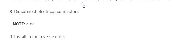

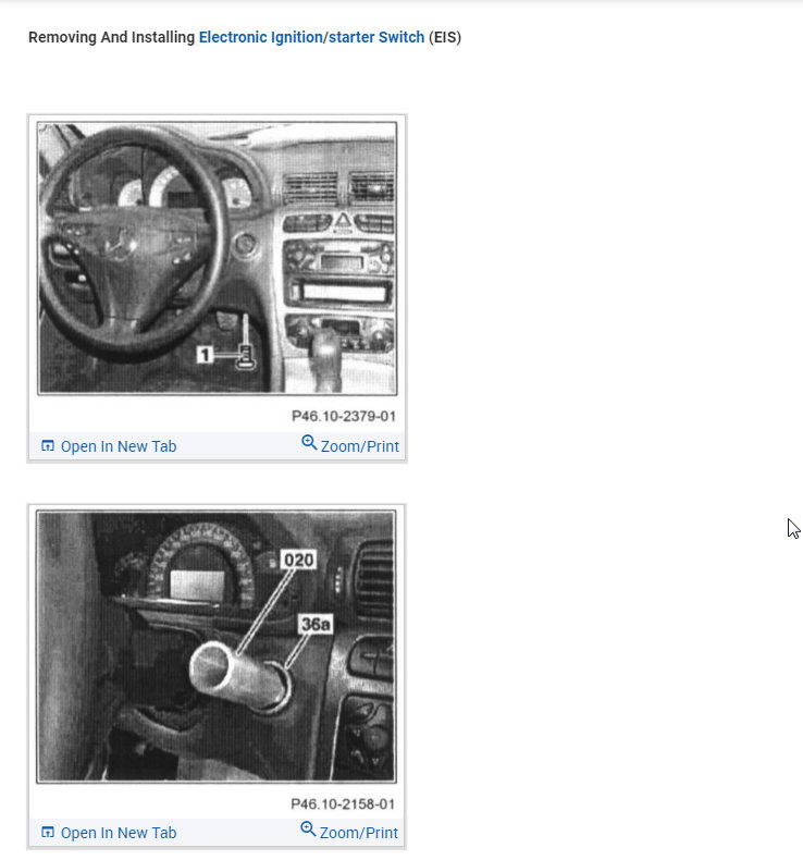

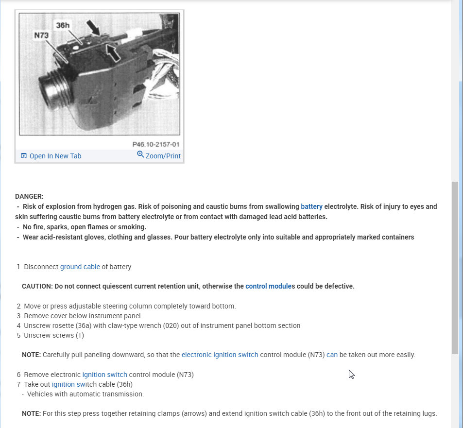

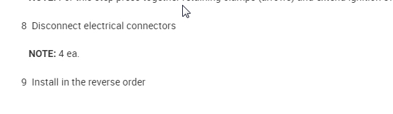

Based on this info, I would suggest replacing the switch and retesting to see if it is now operating. Thanks
