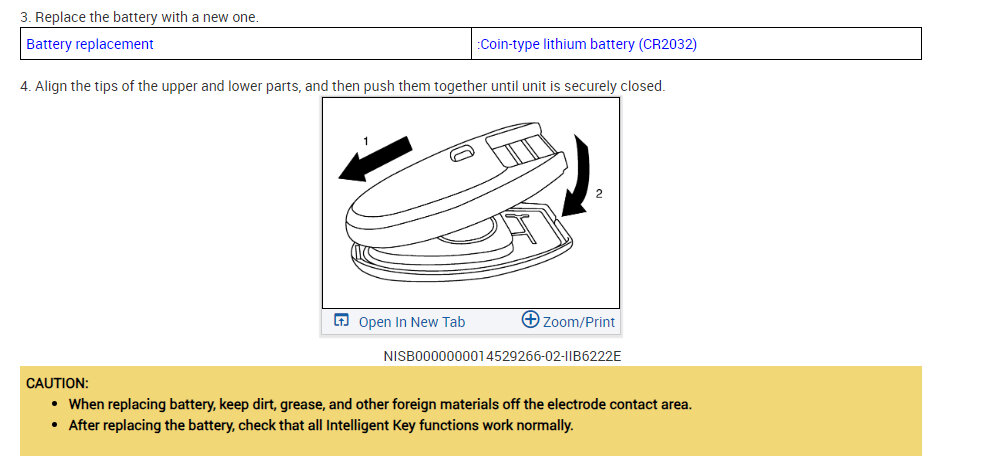

HI,
After changing my car battery, the key fob is not detected sometimes, or it takes a while when I'm in the car. I'm assuming a battery change in the fob itself would help? But maybe it needs to be reprogrammed and I'm not sure how to do it.
May 5, 2024 at 9:14 AM
  • 110,244 POSTS

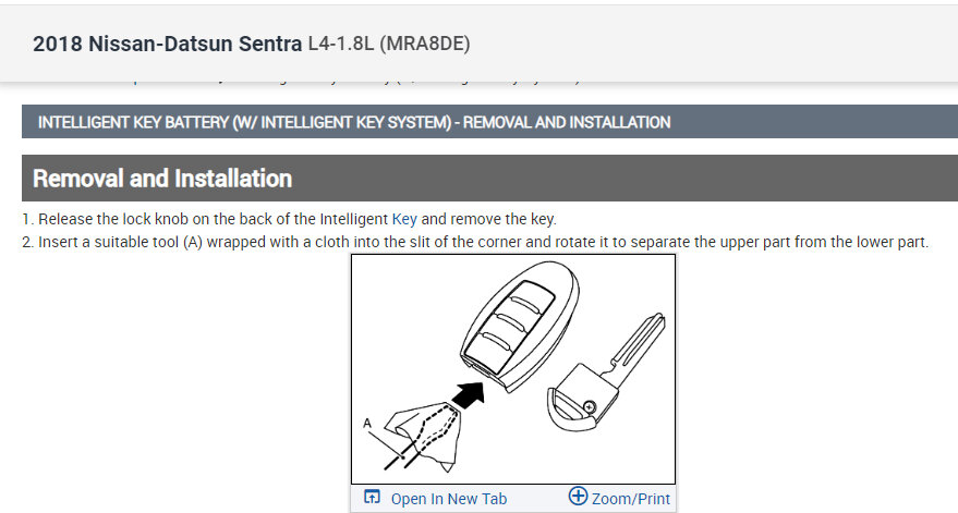

If you removed the battery, it shouldn't affect the programming for the FOB. The first thing I would check is if the battery in the FOB is weak or failing. That is my first suspect because if it was a programming issue, it wouldn't work intermittently.
I attached the directions for battery replacement below. Take a look and let me know if you have questions.
