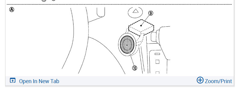

Hi guys, I recently started having issues with my key fob and push button start, the issue is I have to hold the fob up to the push button in order for it to start, before I never had to do that, I replaced the key fob battery and it made no difference, I tried a resetting procedure and it did nothing, the key fob won't lock or unlock the vehicle at all, nor will any of the dome lights come on anymore even if I try to manually turn them on, it also doesn't display the normal things on the dash like it did like low tire pressure (I have a tire with a slow leak) I can't find anything online about it except the receiver is possibly bad, is there any thing I can try to do to get this back to normal? Thanks!

Here is the location of the NATS AA so you can check it out, I have seen these fail before.
NATS Antenna Amp.
The ID verification is performed between BCM and transponder integrated into Intelligent Key via NATS antenna amp. when Intelligent Key backside is contacted to push-button ignition switch in case that Intelligent. Key battery is discharged. If the ID verification result is OK, the operation of ignition switch is available.
