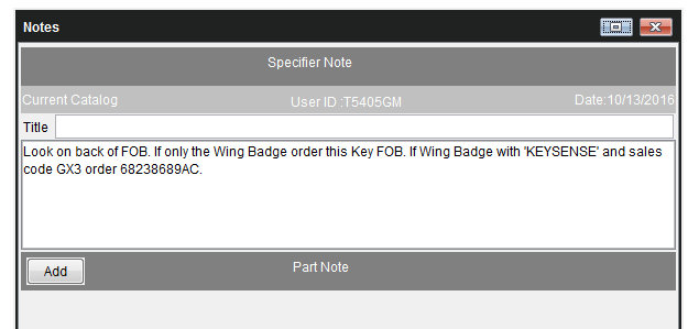

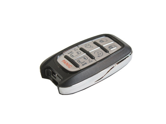

It appears that is the correct key for your vehicle. Here is a picture from the manual of it and it is the same.
However, you will want to make sure this part number is correct as well.
You need to order 68217832AC or if on the back of your current key it says "KeySense" then you need to order the part number shown below in the attachments.
Please let us know if you have other questions. Thanks

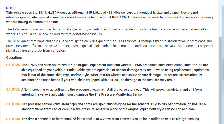

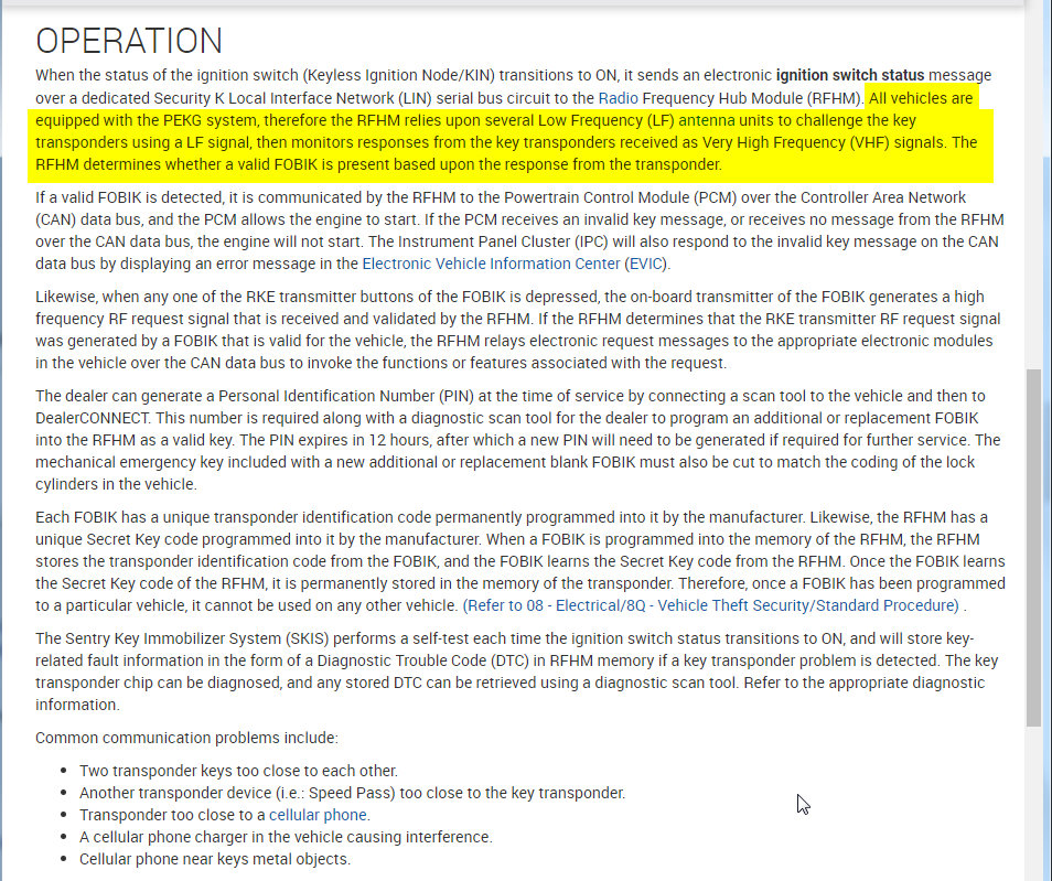

This uses what is called a VHF, Very High Frequency.
These hertz frequencies that you are naming (433 or 310) are used for the tire pressure monitoring system and not the key.
Please see the info below.
