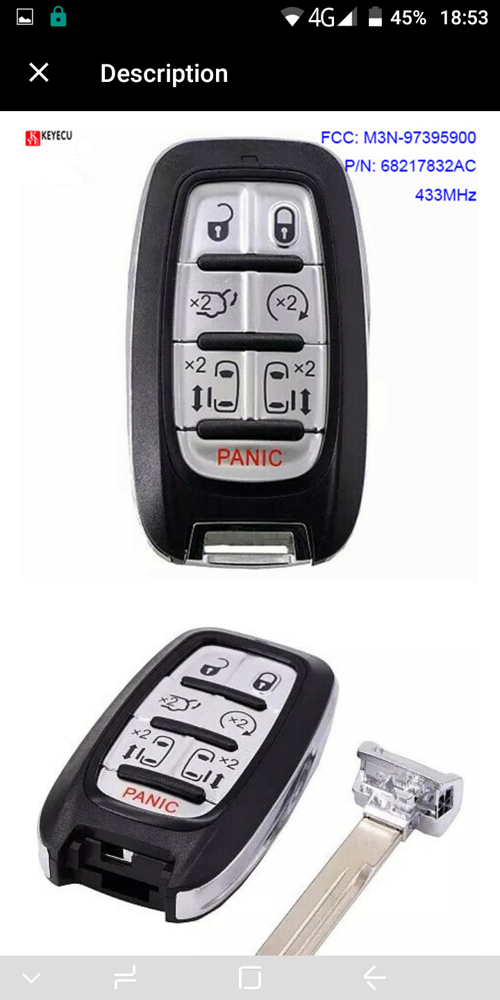

Unfortunately I have only one key for my car. I would like to add a second key and to buy a one as a photo. Is it okay for my car? It is key 433MHz. Is it okay?

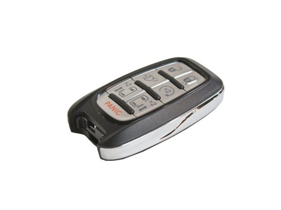

It appears that is the correct key for your vehicle. Here is a picture from the manual of it and it is the same.

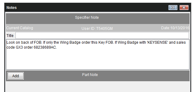

However, you will want to make sure this part number is correct as well.
You need to order 68217832AC or if on the back of your current key it says "KeySense" then you need to order the part number shown below in the attachments.

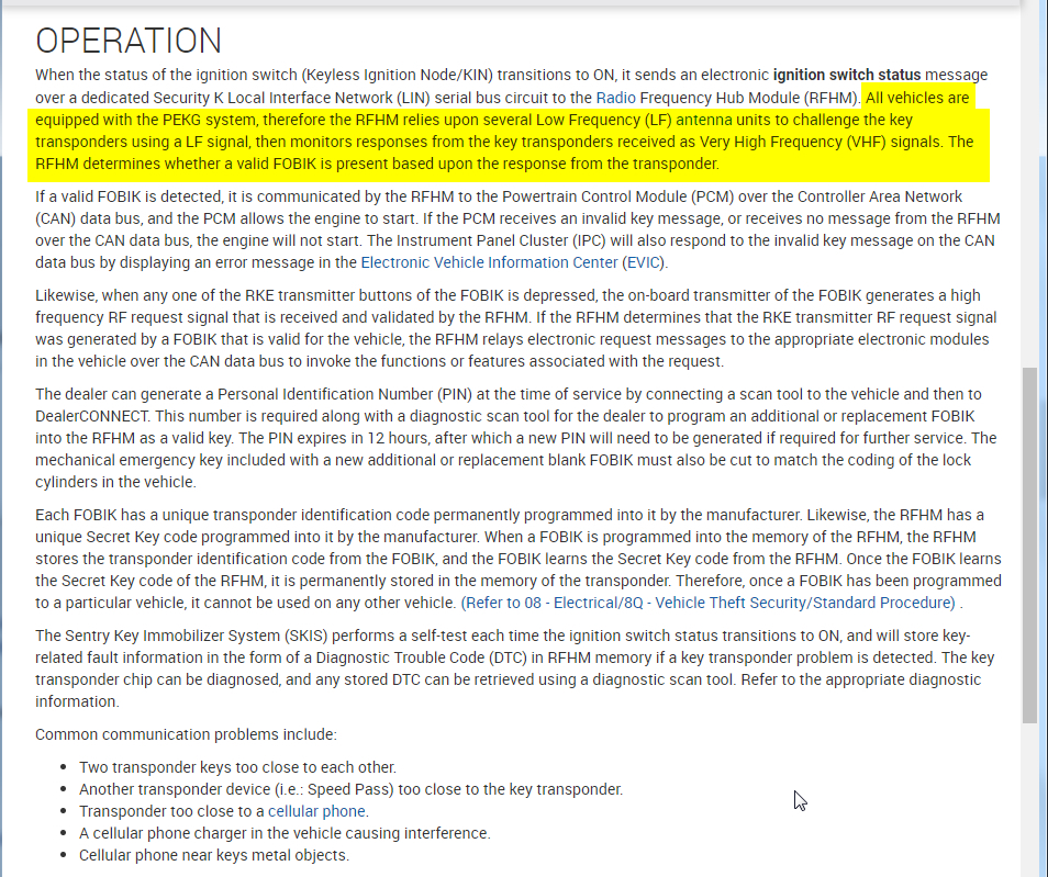

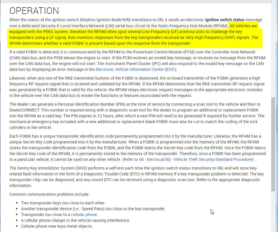

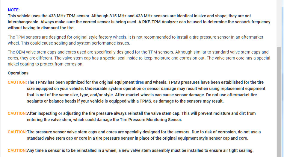

Thank you for your reply, but I am not sure if I well described my question. I would not like to buy the key from official Chrysler shop. There is not part number. I am asking about radio frequency of this remote key. For eg. is it 433MHz or 310MHz?
May 4, 2021 at 4:36 AM
This uses what is called a VHF, Very High Frequency.
These hertz frequencies that you are naming (433 or 310) are used for the tire pressure monitoring system and not the key.
Please see the info below.
