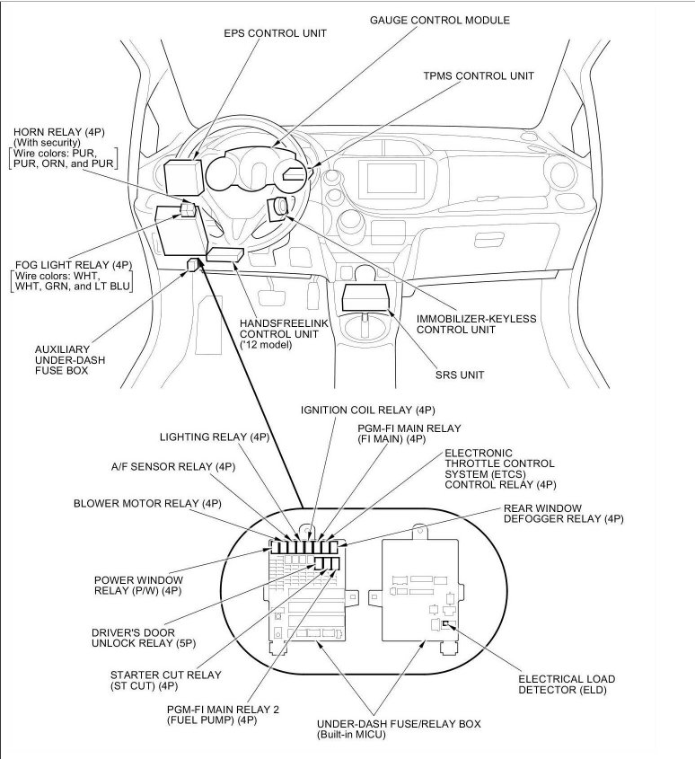

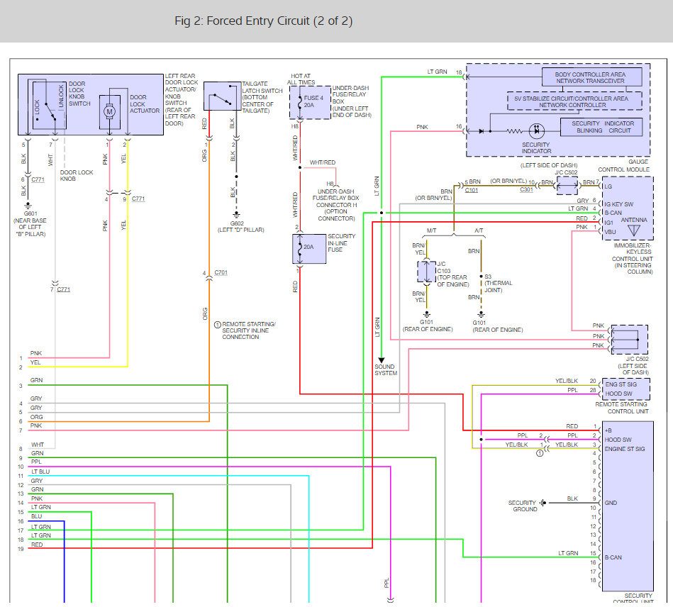

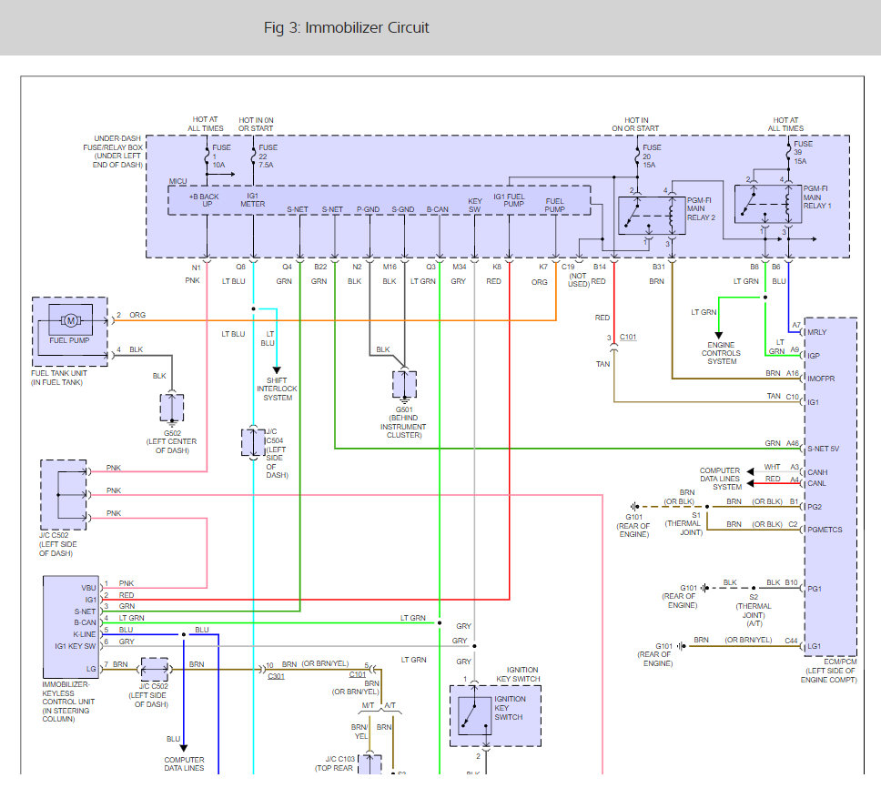

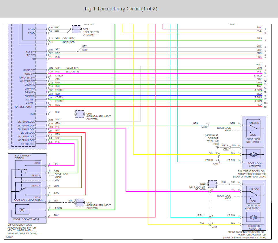

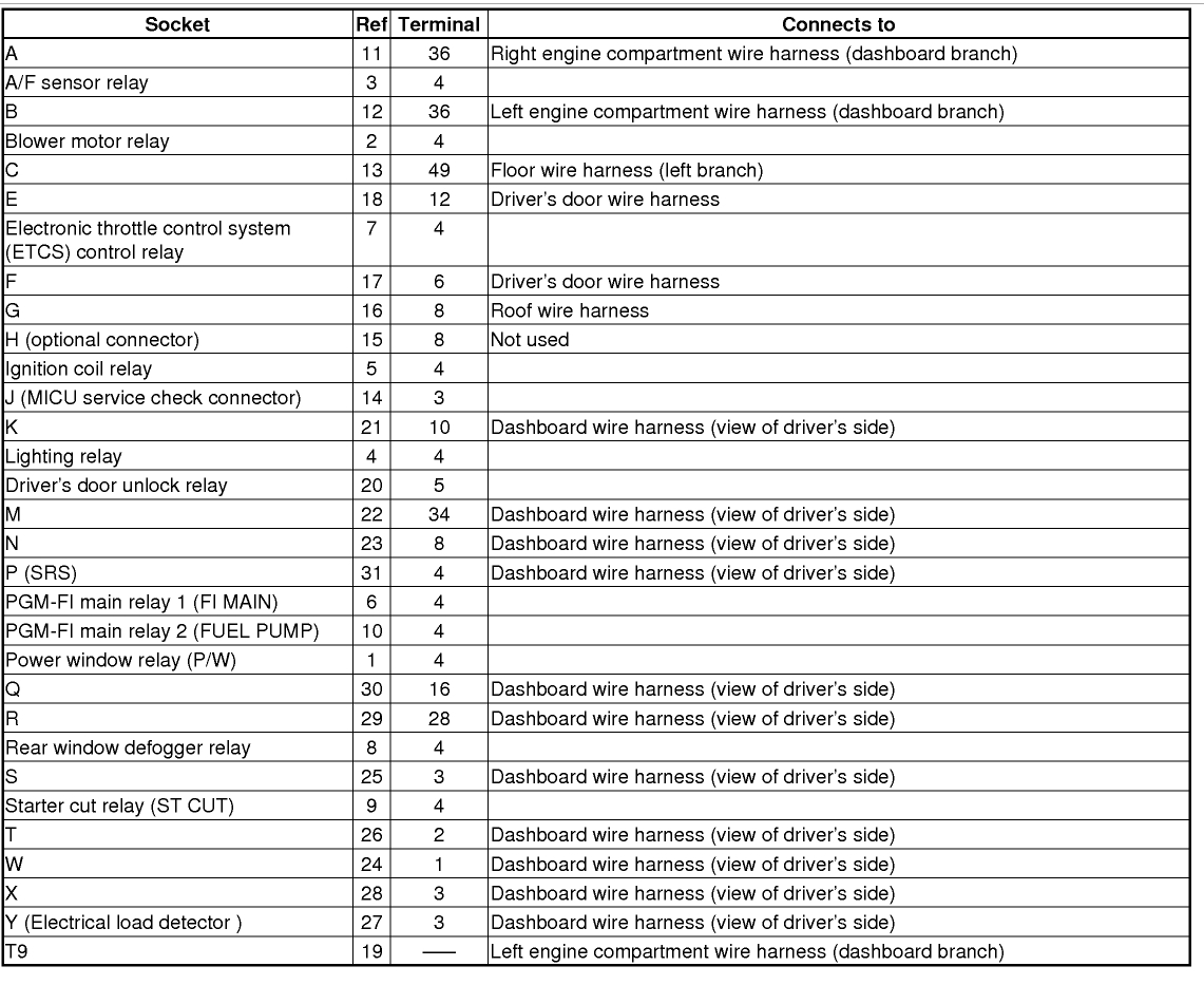

My smart key will not open the doors. also, my lock/unlock button inside car will not lock or unlock the doors either.
I have replaced the key fob battery still does not work.
Aug 12, 2017 at 3:09 PM
  • 55,423 POSTS

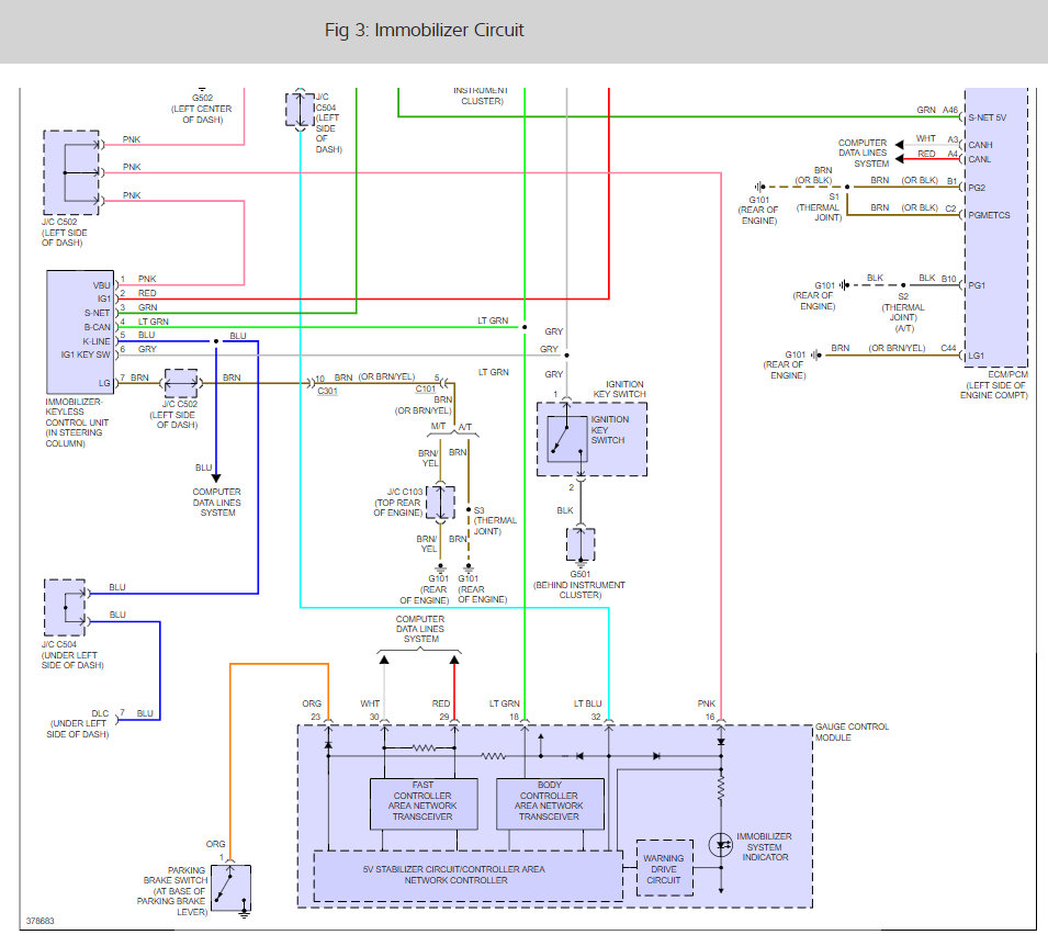

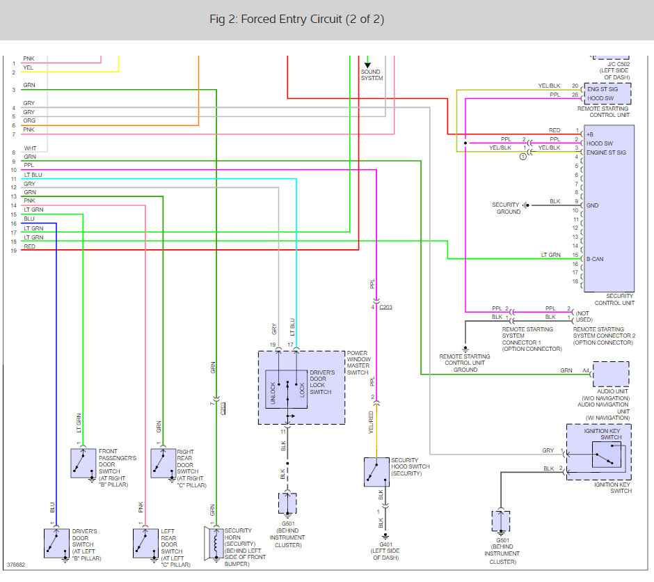

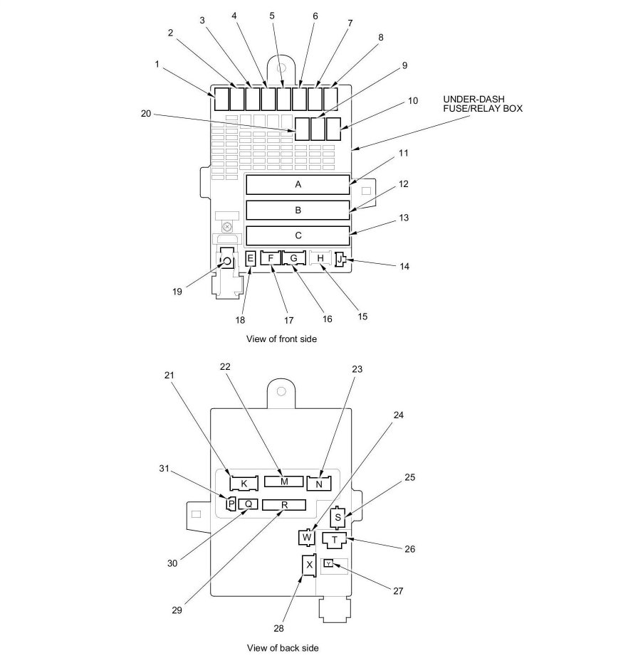

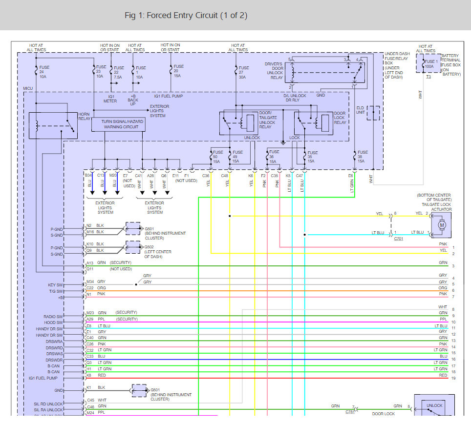

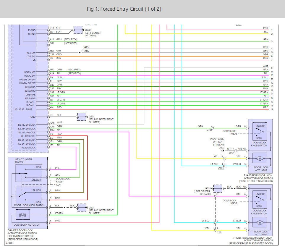

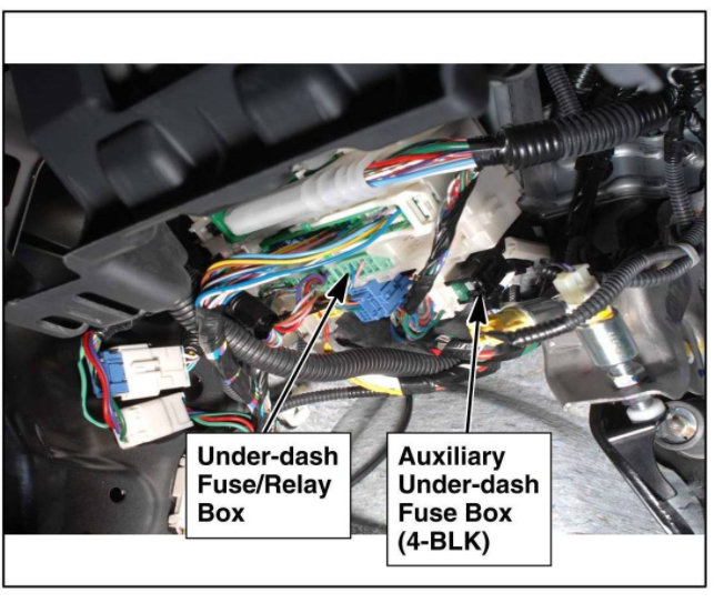

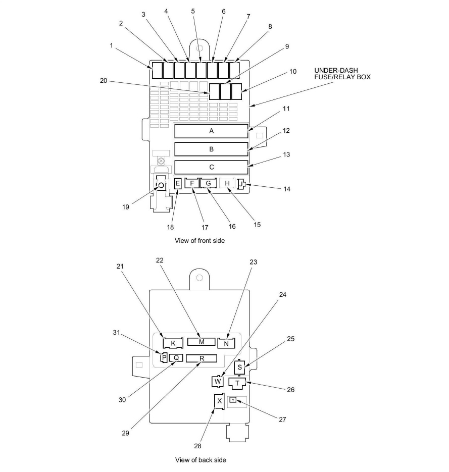

It sounds like you have a fuse that is out, Here is a guide and some diagrams (Below) that will help us find the problem.
Please run this test and get back to us we are interested to see what it is.
