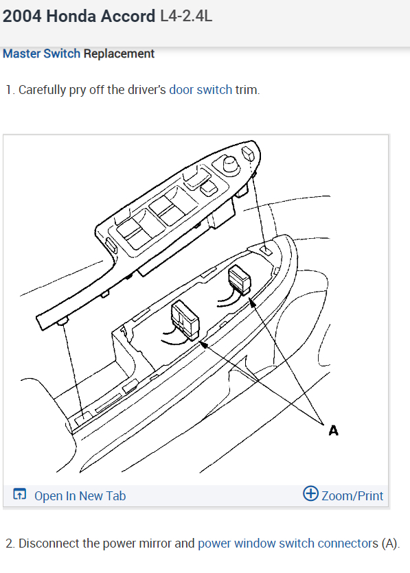

Key fob stopped working after replacing the window master switch?
2004 HONDA ACCORD
300,000 MILES • 2.4L • 4 CYL • 2WD • AUTOMATIC
SIYAM MOHOMMAD S
When I change window master switch stop working key fob.

These cars have many different types of master window switch, did you get the same part number? If so, the switch is defective and needs to be swapped out. It masters if it is a 2 or 4 door and trim levels as well, here are the four different parts numbers.

I was by from Amazon 2 master switch but nothing I'm not sure with trim level.
VIN JHMCM56524C404986 my old one parts number 35750SDAYO2 i can't same parts.

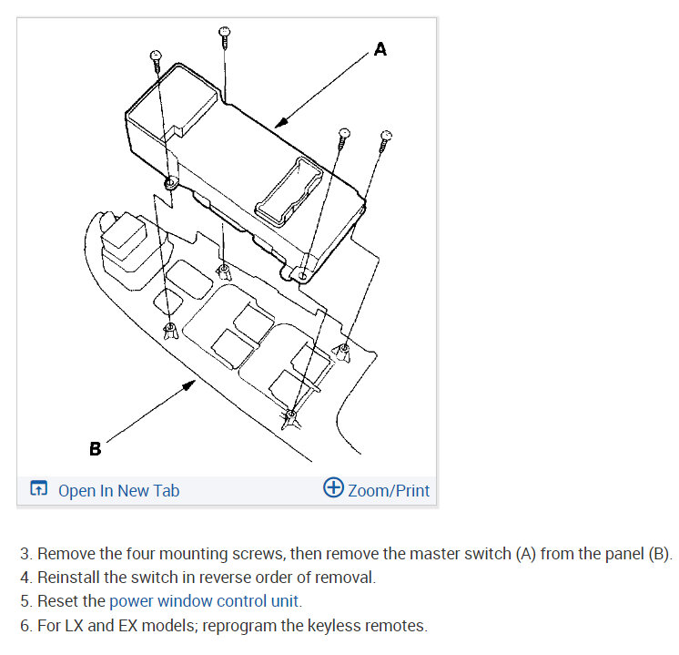

There must be another option for the window switch. I would contact the dealer for the part if you can't find the other options.
Here is the part you need:

Why this my old one problems is only driver side window not work that's why i have to replaced now old one also not work key fob.

Yep, the connects inside the switch become dirty/arched. I have seen people open them up and clean the contacts to get the switch working again. It might be worth a try.
