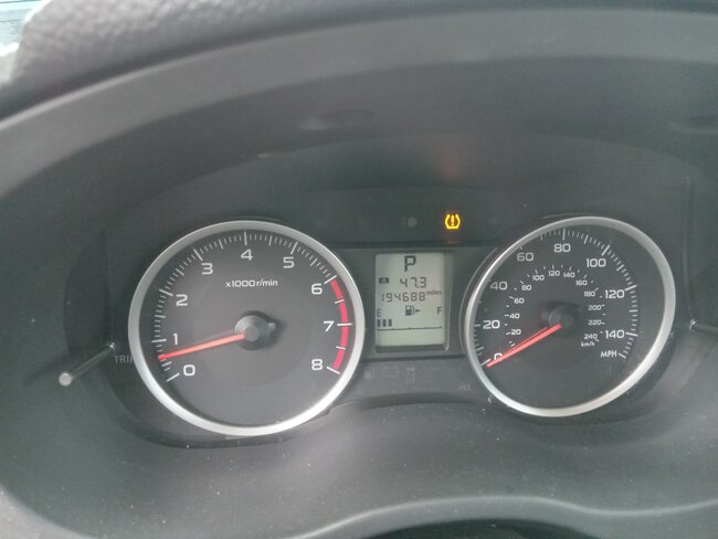

After disconnecting the battery my key fob is not working, and my tire light is on.

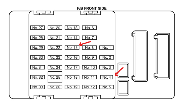

Okay, lets check the fuse #4 and #15 in the fuse panel. Here is a guide to help you and the fuse locations in the image below.
Jun 16, 2025 at 11:46 PM
JOHNSK62
Both fuses are good...

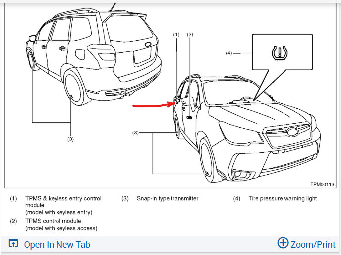

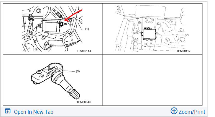

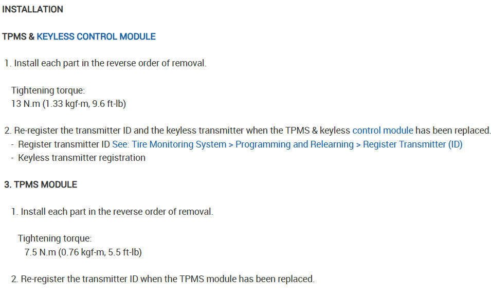

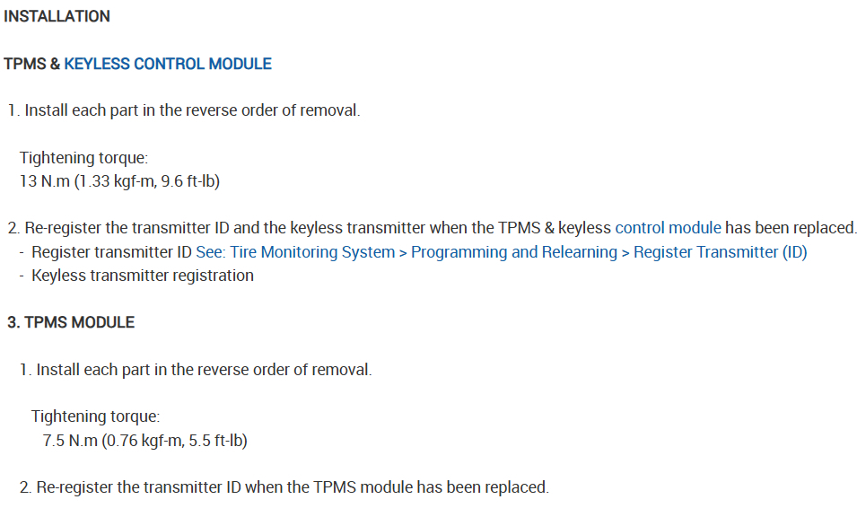

Okay, then it looks like the TPMS and keyless entry control module is out, here is the location so you can check it out. A CAN scan should help confirm it. It looks like it will need to be programmed in. Check out the images (below). Please let us know what happens.
