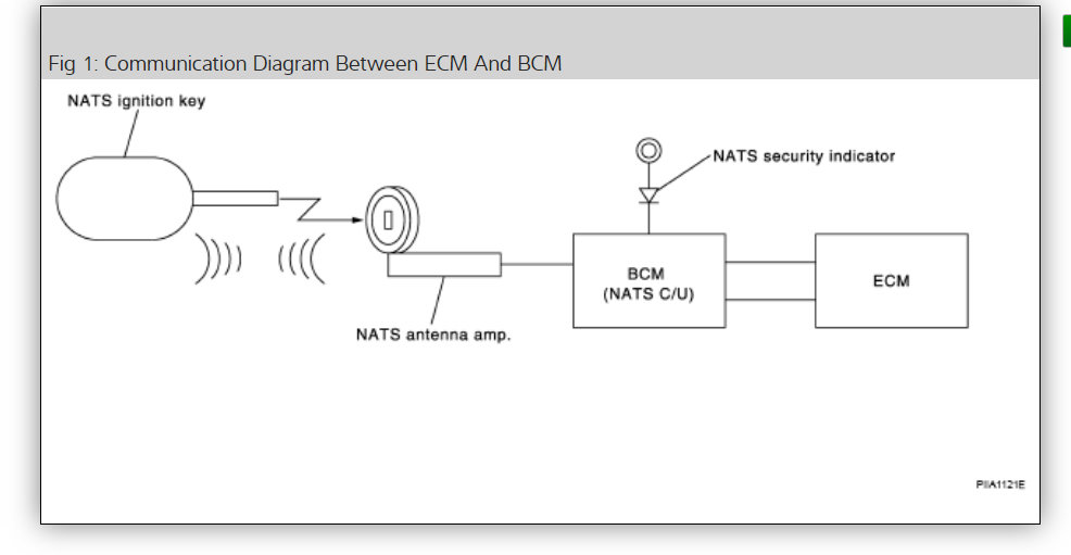

I accidentally used my boyfriend's nitro key to start my truck now my truck will not start.
Jul 31, 2019 at 4:40 AM
SCGRANTURISMO
✓ASE Certified Mechanic
4,897 POSTS

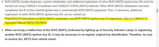

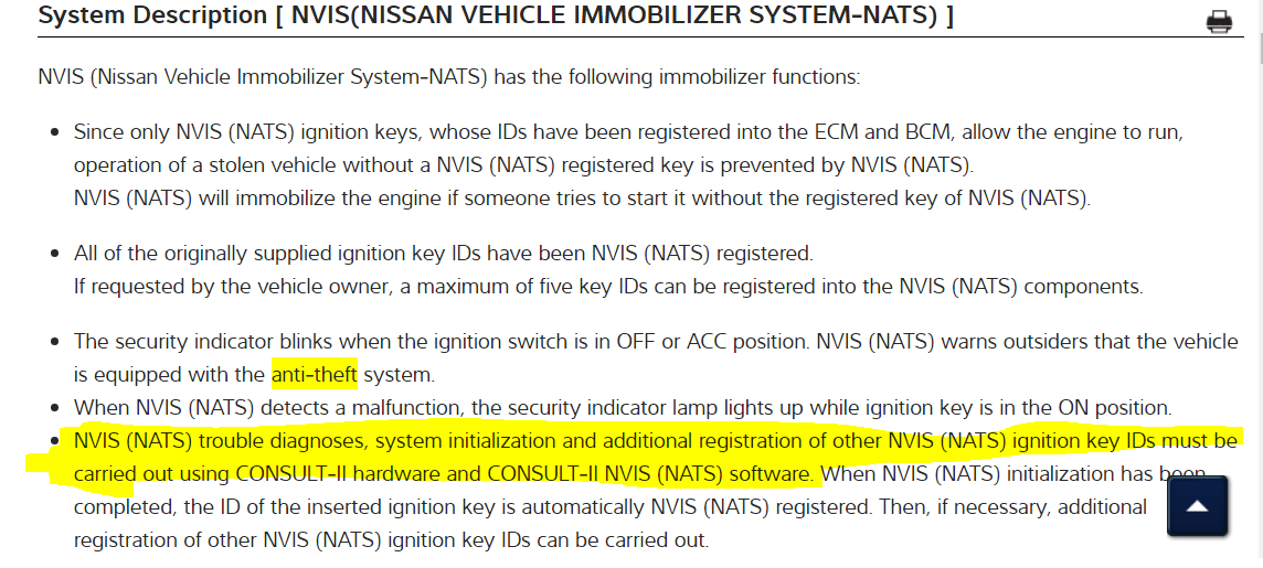

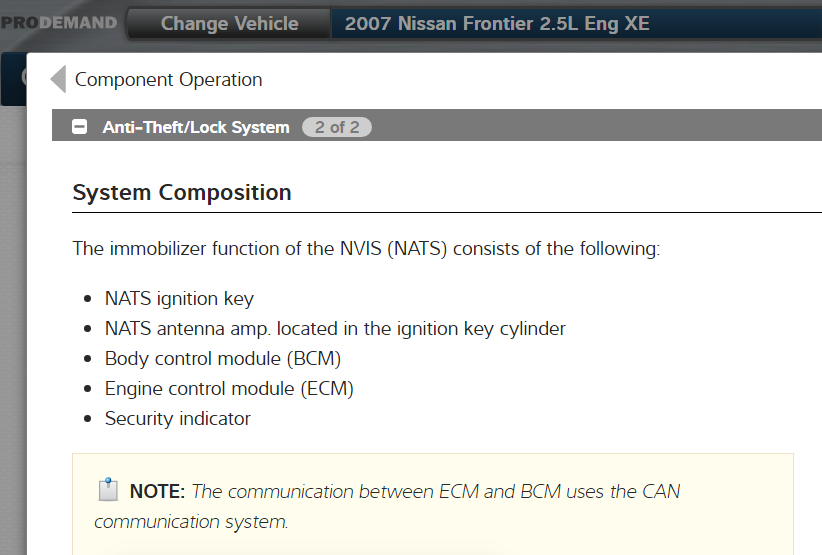

Unfortunately, anything to do with Nissans NVIS or "immobilizer" anti theft system requires the use of their scan tool called Consult 2. You will either have to take your vehicle to the dealership or a locksmith to have this diagnosed and fixed. They are the only places to have this done. In the diagrams down below I have provided the literature we have on NVIS for your vehicle. Please keep us informed as to how everything works out.
