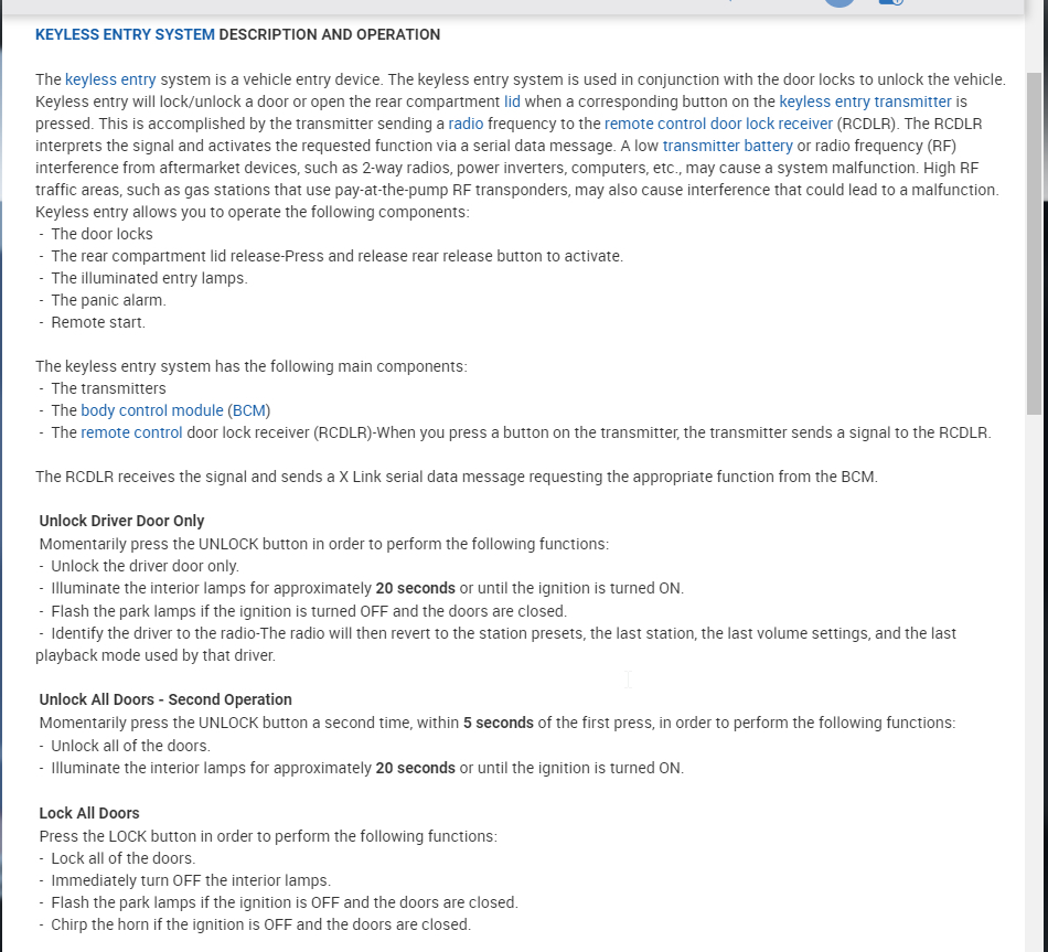

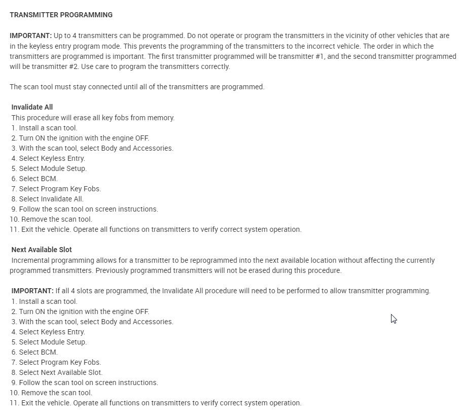

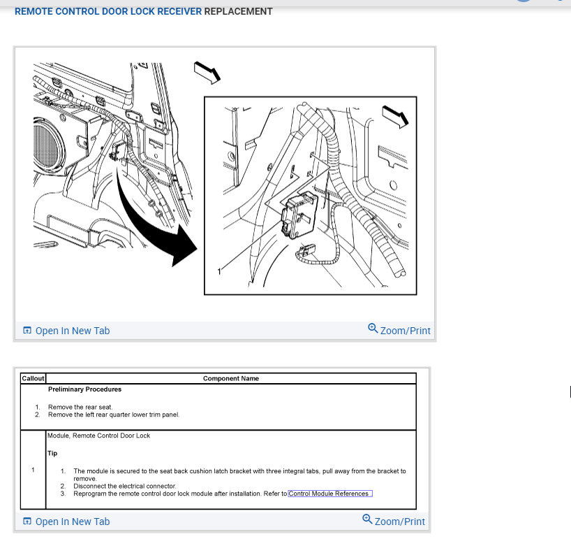

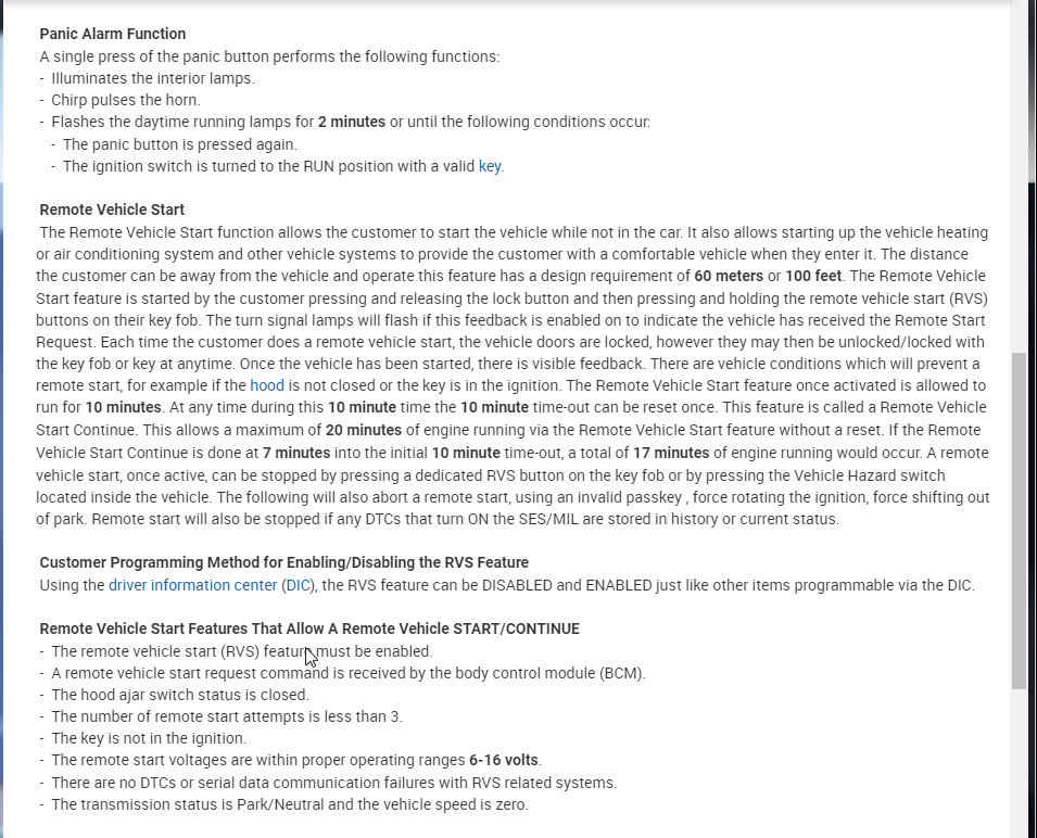

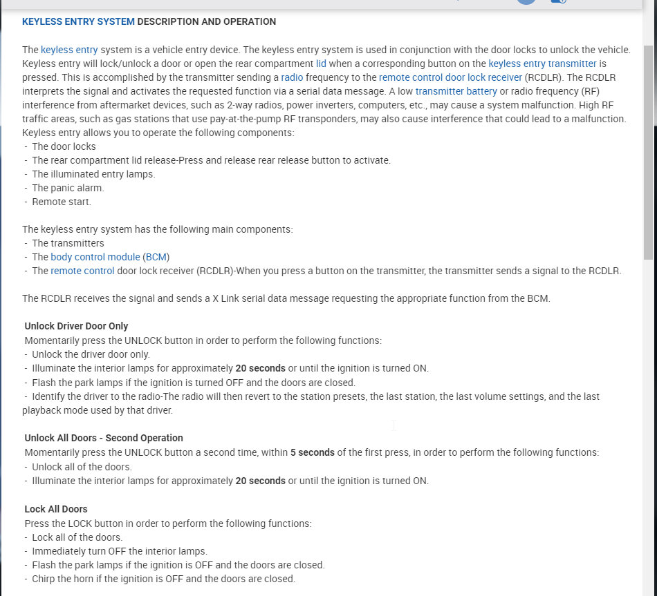

Yes. More than likely the module is the failure. However, you should have some codes to go along with that. I would suggest checking the code first because if you replace that module it requires programming.
I attached all the detail about this for your review. If you have a code let me know what it is and I can get you the testing info just to confirm.

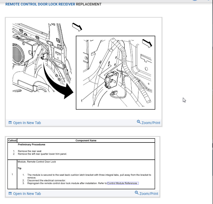

How do I obtain the code? Is it hard getting to the receiver?
Nov 22, 2019 at 1:43 AM

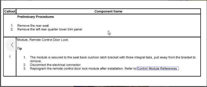

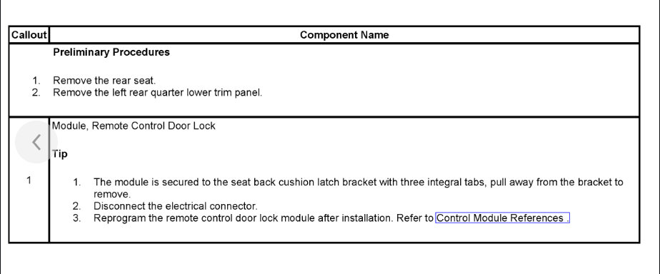

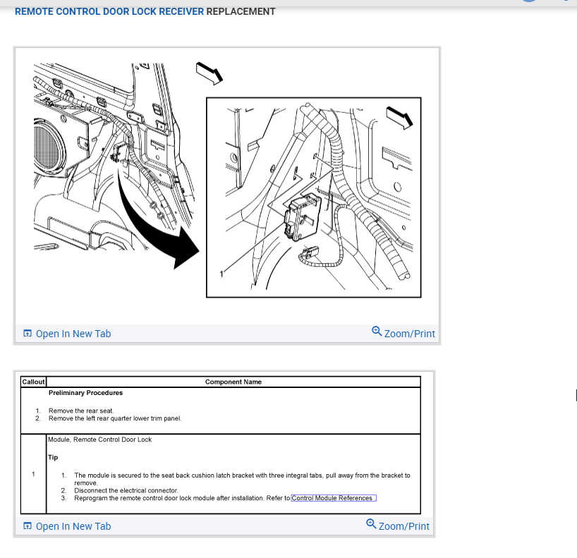

You use a scan tool to check for codes in the body controller. I attached the replacement process.
