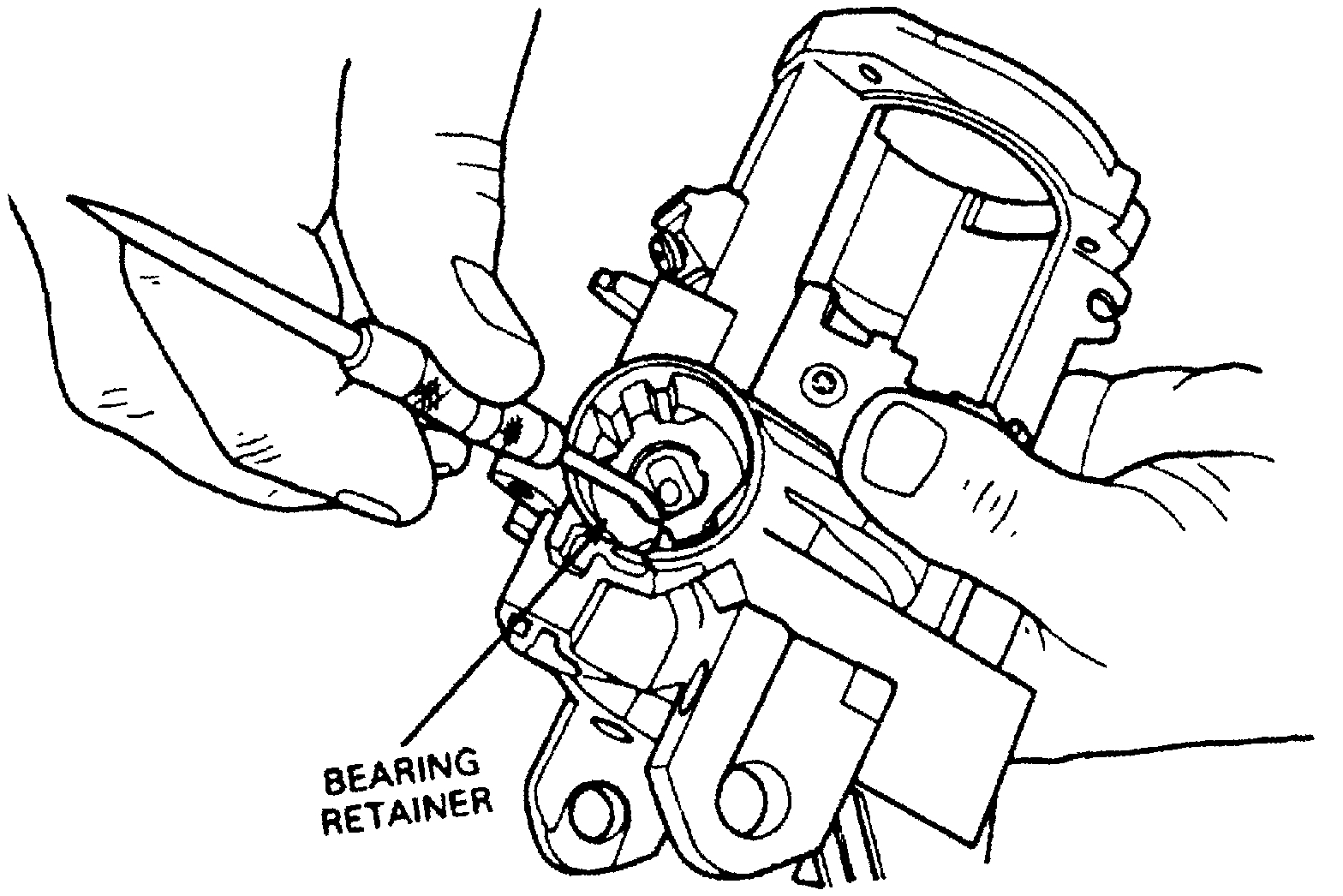

Fig. 3 Ignition Lock Bearing Retainer Removal (Less Key)
pic 1
9. Remove white plastic bearing retainer by inserting a suitable tool with a 90 degrees bend on tip between bearing retainer and bearing and prying upward, Fig. 3. Note position of bearing retainer prior to removal.

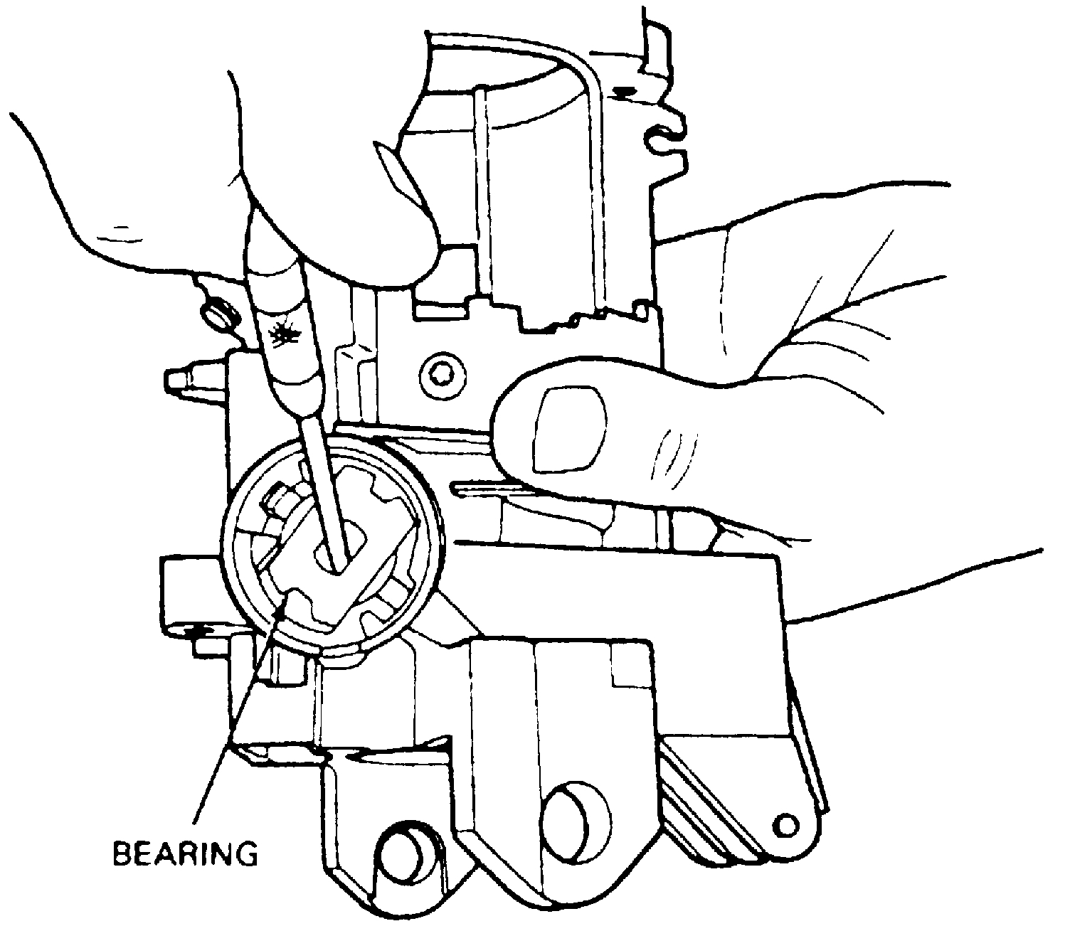

Fig. 4 Ignition Lock Bearing Removal (Less Key)
pic 2
10. Insert tip of a suitable screwdriver into double-D slot of bearing, Fig. 4, rotate 90°, then remove bearing.

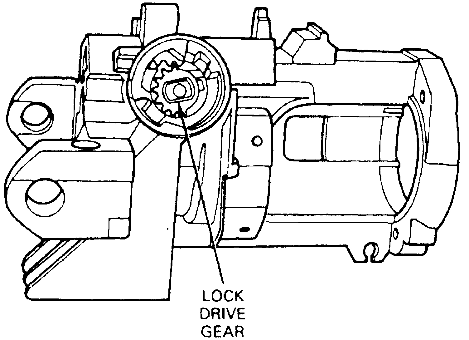

Fig. 5 Ignition Lock Drive Gear (Less Key)
pic 3
11. Remove lock drive gear, Fig. 5, noting relationship of lock drive gear to rack teeth.

1. Lubricate and position lock drive gear in base of lock cylinder housing in same position as noted during removal.
NOTE: Position of lock drive gear is correct if last tooth on drive gear is meshed with last groove on rack.
2. Position bearing in lock cylinder housing, insert tip of screwdriver into double-D slot of bearing, then rotate bearing 90°.
3. Press white plastic bearing retainer into lock cylinder housing, ensure retainer is in its original position, then press firmly to snap into place.
