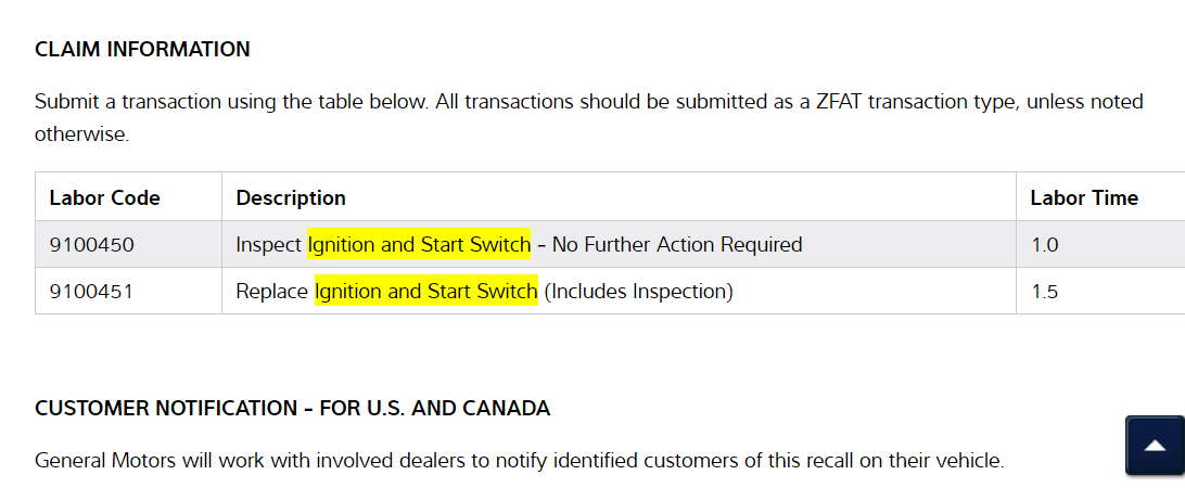

My car starts and turns off, but can't remove key.
Mar 31, 2019 at 2:32 AM
SCGRANTURISMO
  • 4,897 POSTS

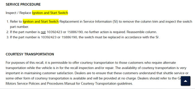

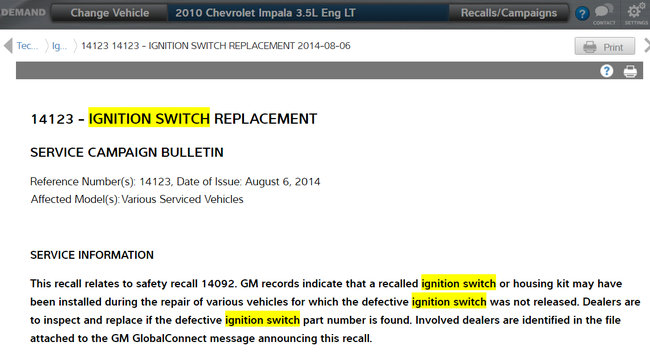

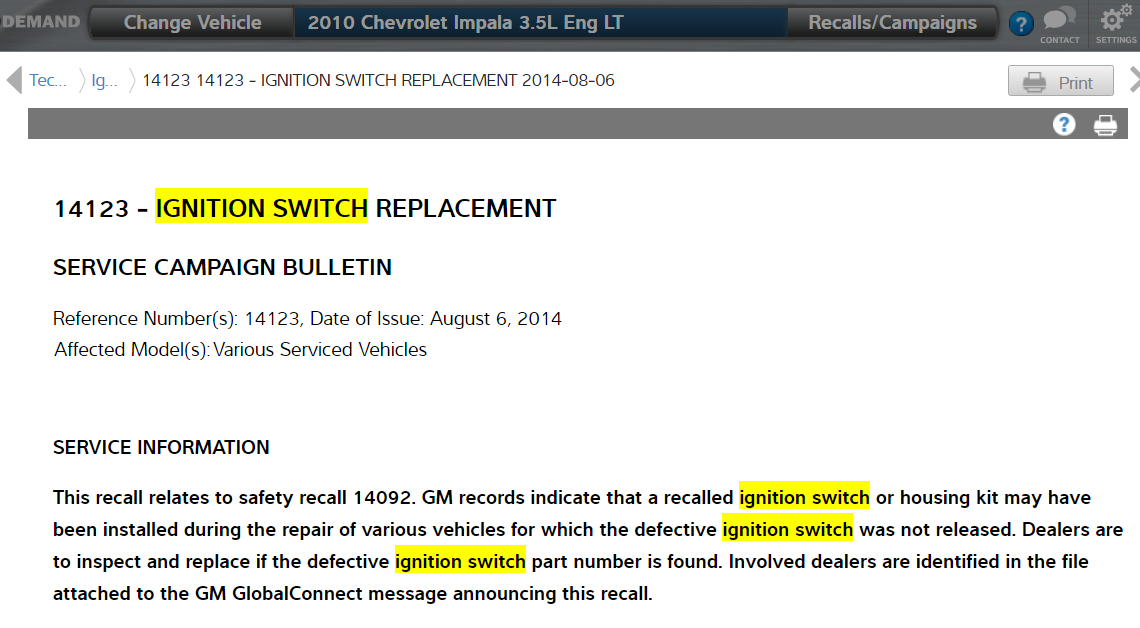

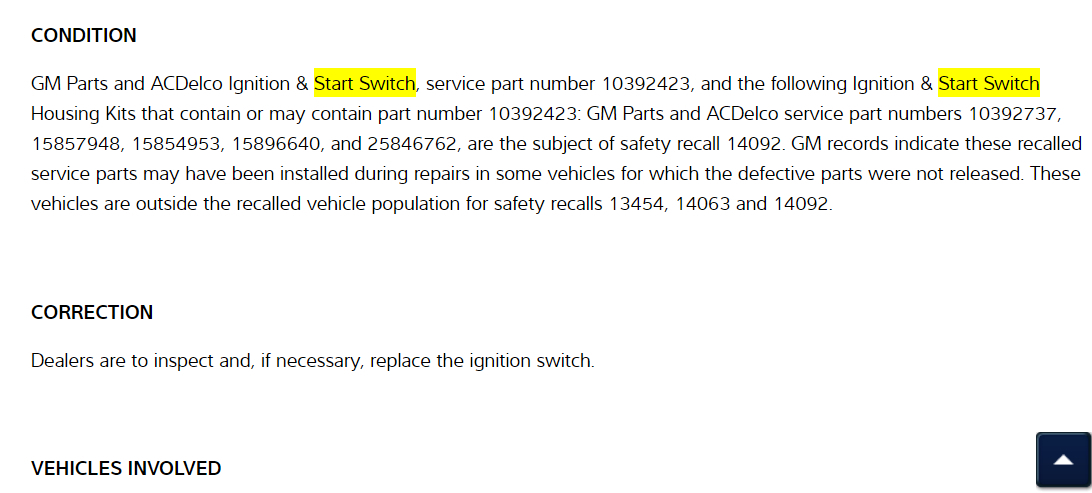

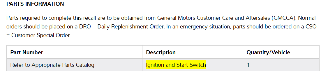

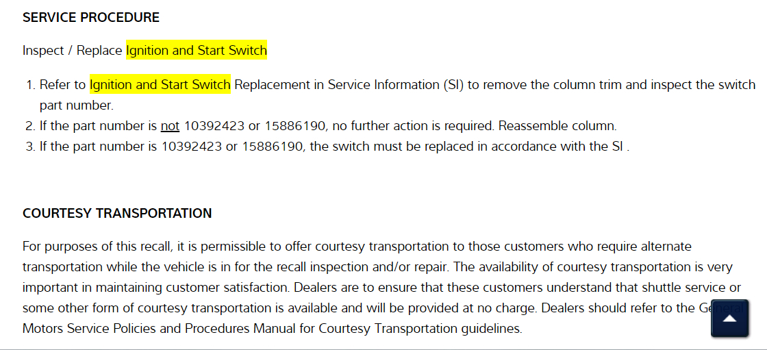

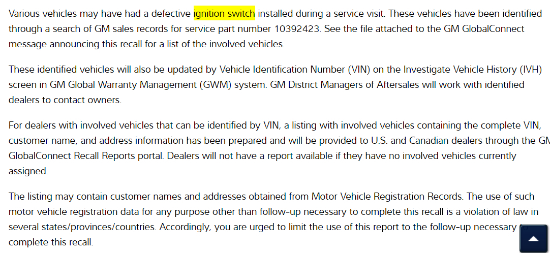

While doing a little research on your vehicle I came across this Technical Service Bulletin (TSB) for recalls being done for defective ignition switches. You might want to call your local Chevrolet dealership and see if your vehicle is one that is affected by this recall. I have included the entire TSB in the diagrams down below. Let us know how it turns out.
Thanks,
Alex
