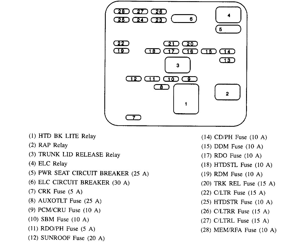

i put my key in and it will not start and says unknown driver? i turn my key to start for 5 seconds two times and it starts!!! And works fine. Then after being parked overnight i get into my car and it does it all over again.
Sep 23, 2022 at 2:12 AM
  • 55,721 POSTS
This happens when there is a fuse out (TRK REL) in the fuse panel in the rear fuse panel.
Here is a guide to help you and the fuse location as well:

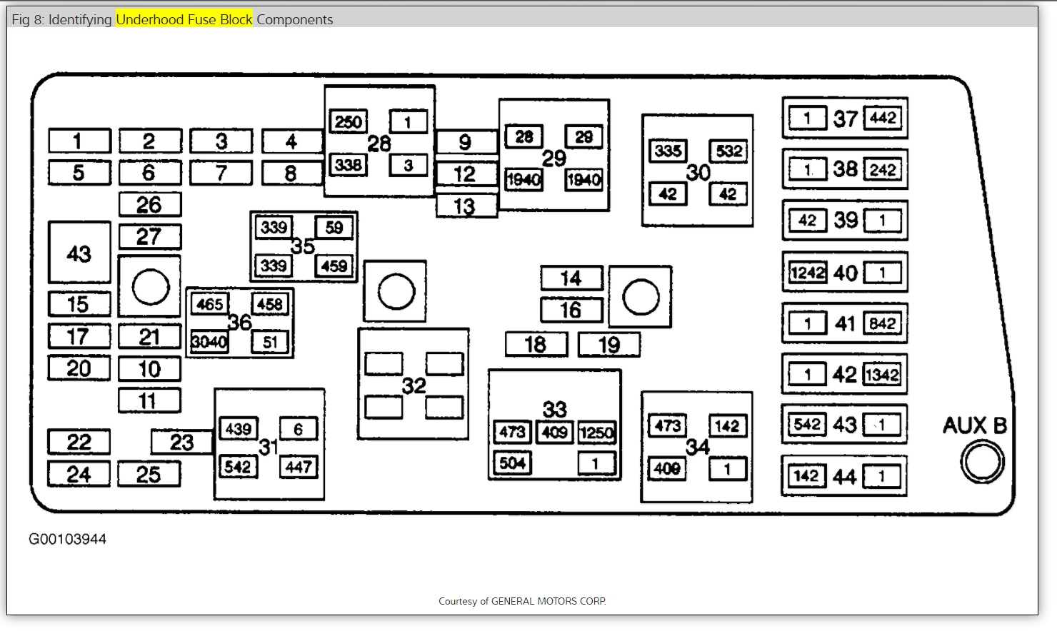

Check out the images (below). Please let us know what you find. Check the fuses under the hood and inside the car as well.
