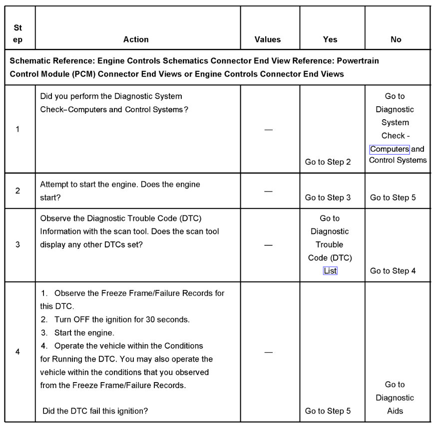

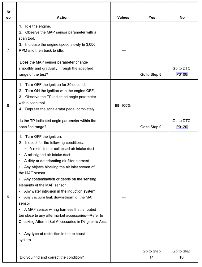

Code p0101, will not start
110,238 MILES • 4.8L • V8 • 4WD • AUTOMATIC
HEATHON1990
Replace the MAF sensor, catalytic converters are not plugged. new throttle body and throttle plate, no holes in the boot going from the breather box to the throttle body, new filter in the breather box, clear the code. it'll run fine as soon as it kicks the code it quits and won't start. I am running out of ideas, and it doesn't even kick the light on, it just kicks that code in pending, clear the code and it'll run fine for about 3 minutes no security issues.
Jun 23, 2022 at 12:47 PM
SQM
  • 6,383 POSTS

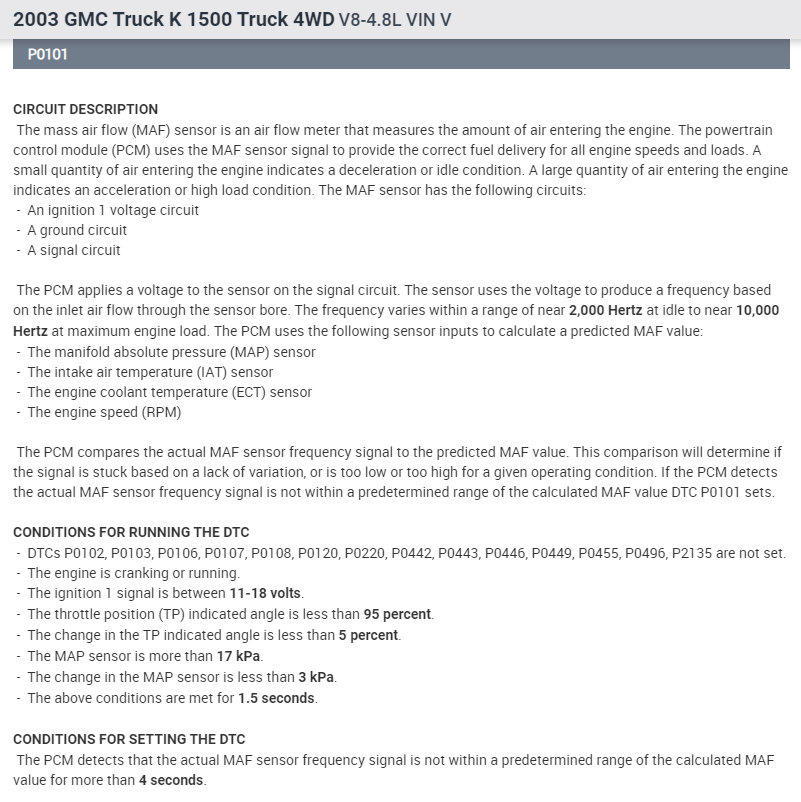

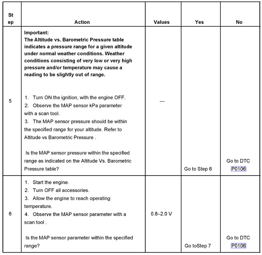

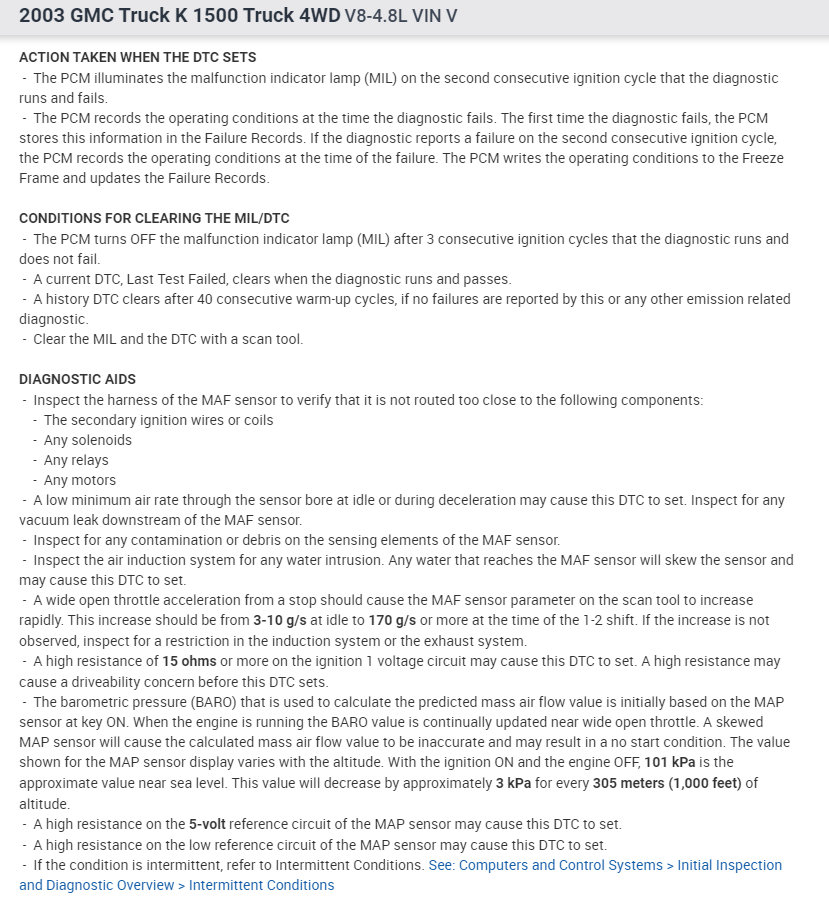

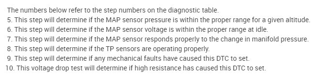

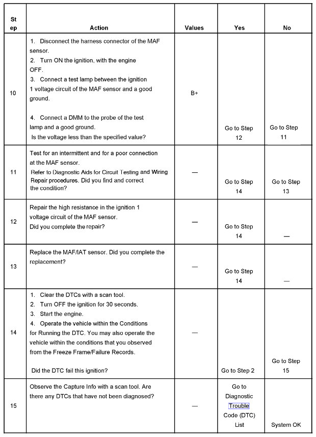

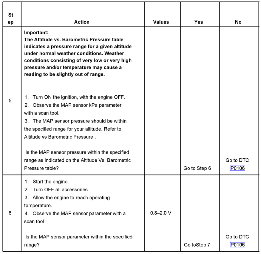

This could be due to the wiring harness for the sensor, or even the ECM.
Attached is the troubleshooting guide for the code P0101 below.
Follow those steps as it can help you determine the issue.
Let me know of any questions.
