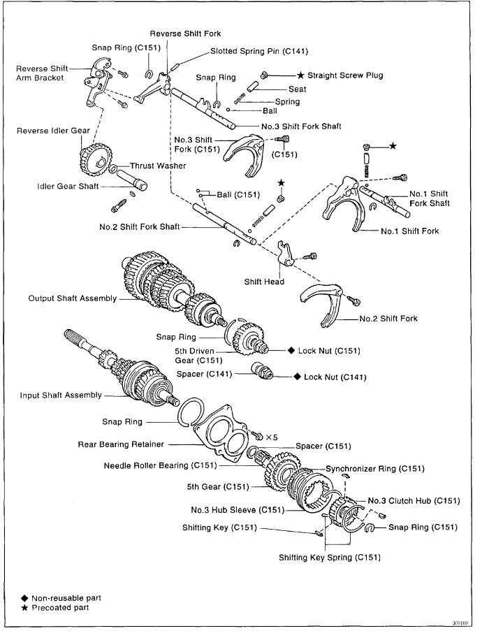

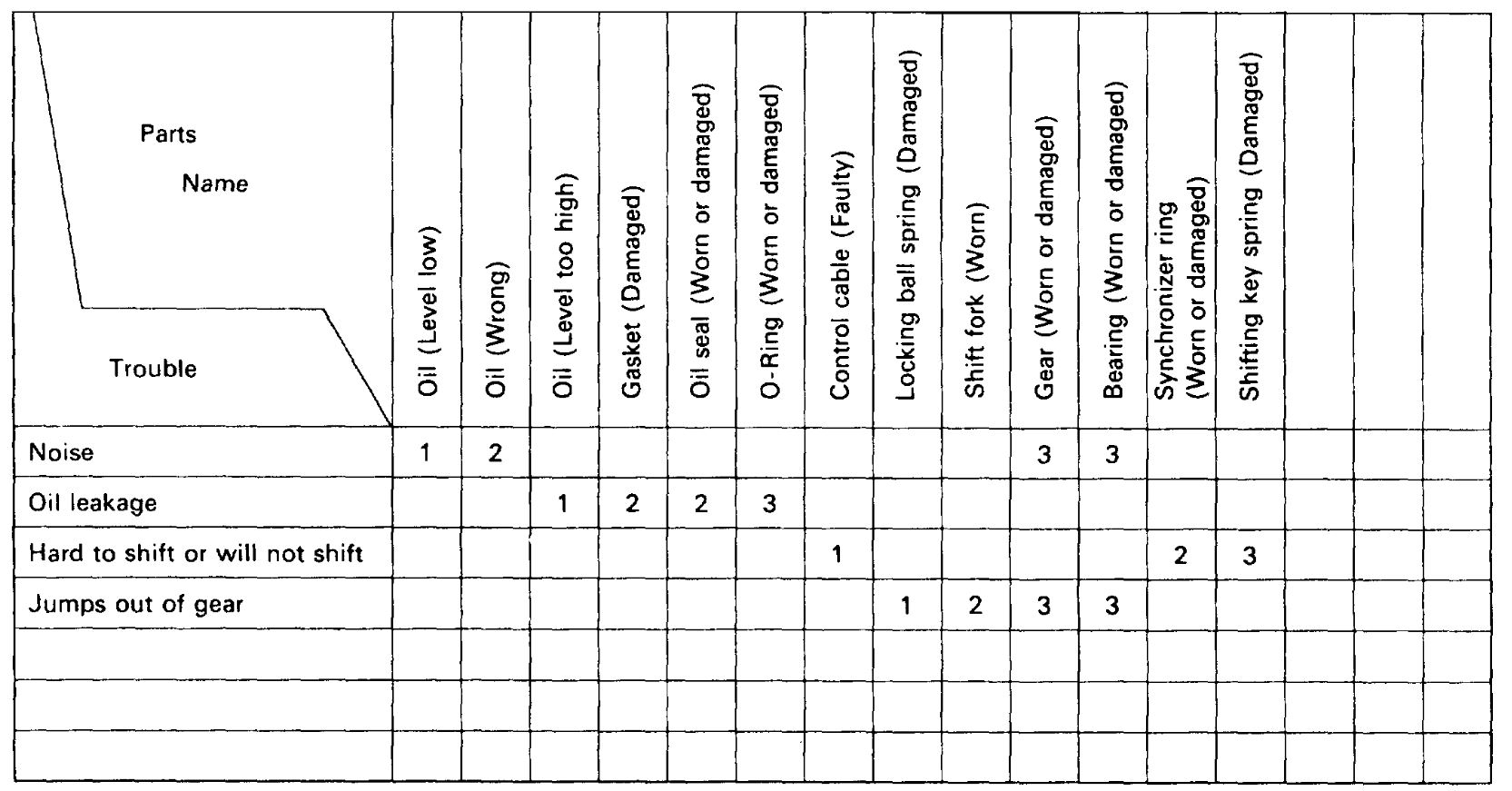

Transmission keeps popping out of fourth gear
1996 TOYOTA TERCEL
187 MILES • 2WD • MANUAL
SLOANRANDI69
Had fluid toped off and it still pops out of 4th gear.

Hi, I'm Dan.
It sounds like it is most likely an internal issue inside the transmission. Something like a worn shift fork or detent ball. I've attached a form from Toyota that shows the likely areas to check. I've also attached an exploded view of the transmissions internal shifting mechanisms.
