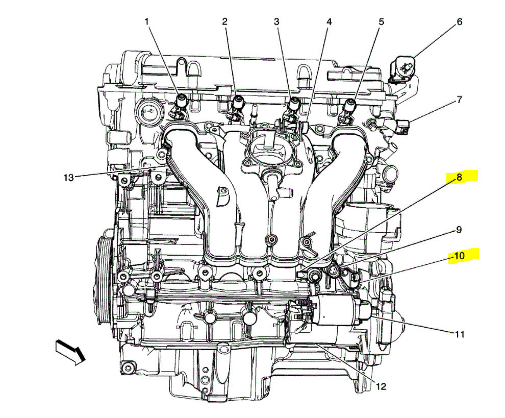

Where is the crankshaft sensor and the knock sensor located?
Nov 19, 2020 at 1:41 AM
  • 110,241 POSTS
if you look at pic 1, number 8 is the knock sensor and number 10 is the crankshaft position sensor.

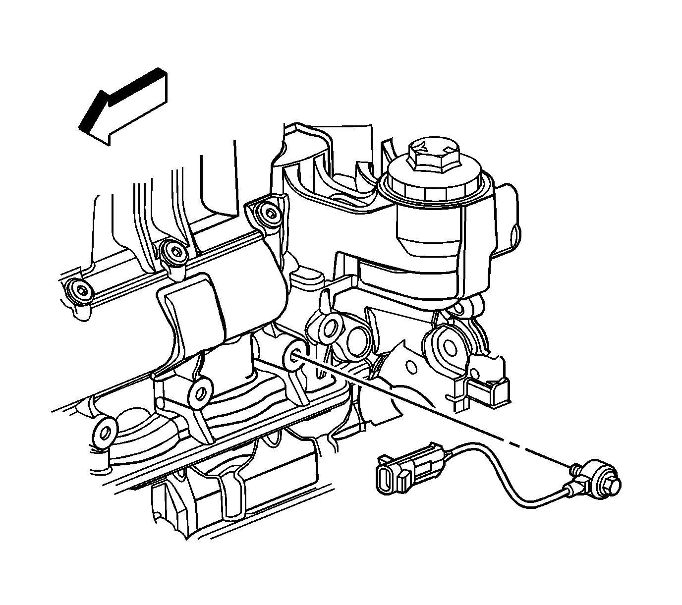

2. Disconnect the engine wiring harness electrical connector (1) from the crankshaft position (CKP) sensor.
pic 3
3. Remove the CKP sensor bolt.
4. Remove the CKP sensor.

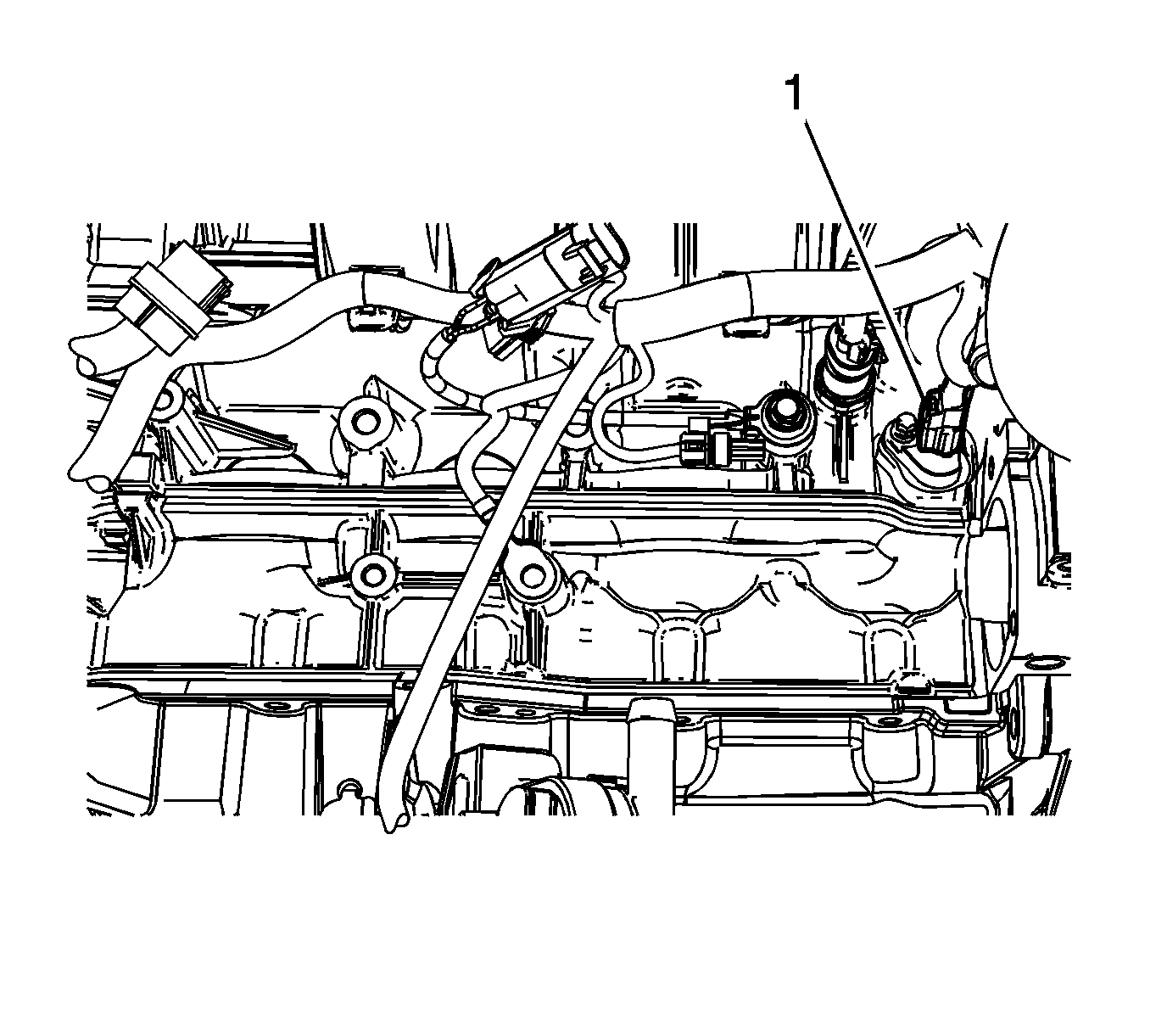

1. Lubricate the CKP sensor O-ring seal with clean engine oil.
2. Install the CKP sensor.
Caution: Refer to Fastener Caution (See: Vehicle > Vehicle Damage Warnings > Fastener Caution).
3. Install the CKP sensor bolt and tighten to 10 Nm (89 lb in).

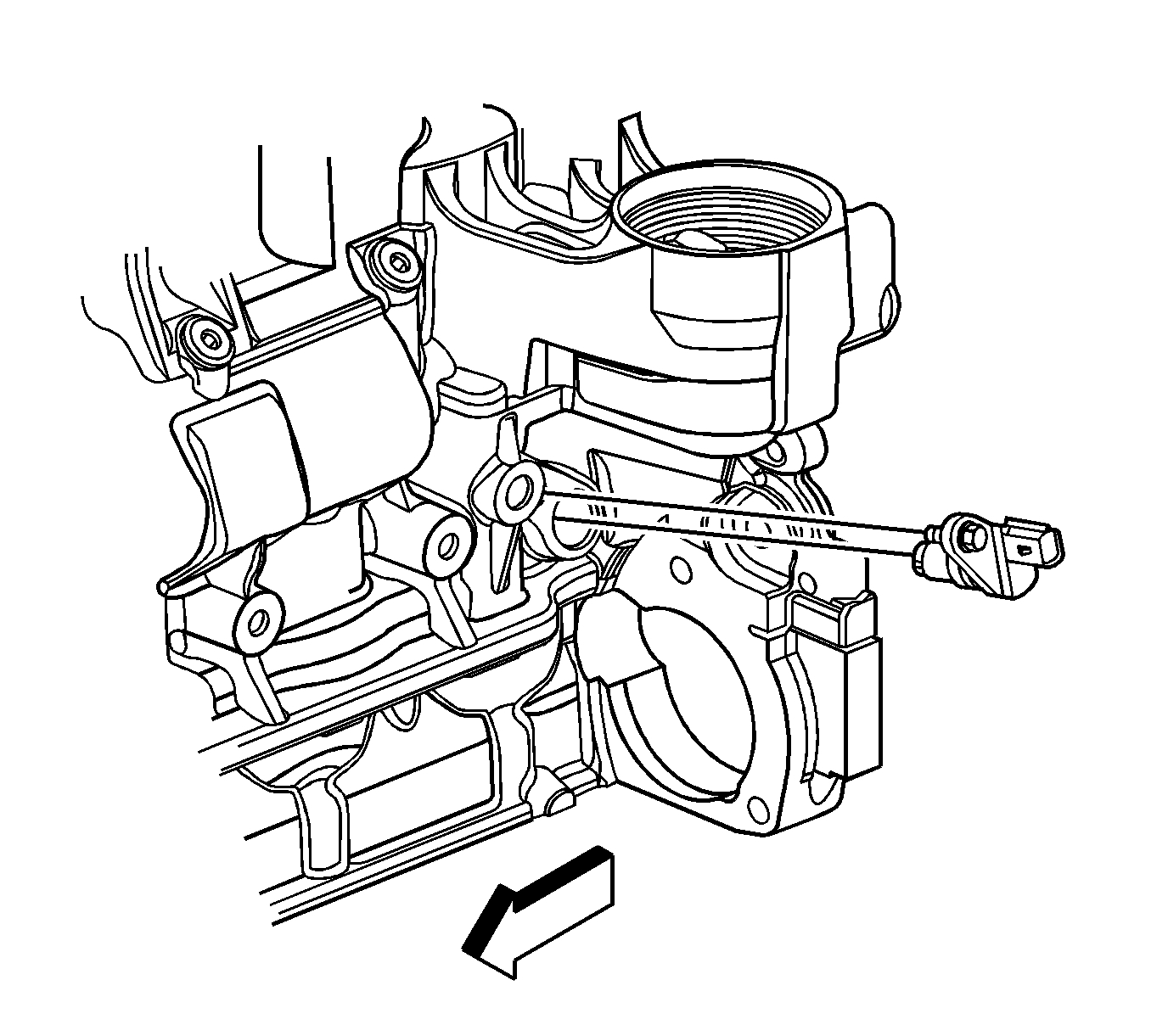

4. Connect the engine wiring harness electrical connector (1) to the CKP sensor.
5. Install the starter. Refer to Starter Motor Replacement (LAT) (See: Starter Motor > Removal and Replacement)Starter Motor Replacement (LY7) (See: Starter Motor > Removal and Replacement)Starter Motor Replacement (LE5) (See: Starter Motor > Removal and Replacement).
6. Perform the crankshaft position system variation learn procedure. Refer to Crankshaft Position System Variation Learn (See: Crankshaft Position Sensor > Removal and Replacement).

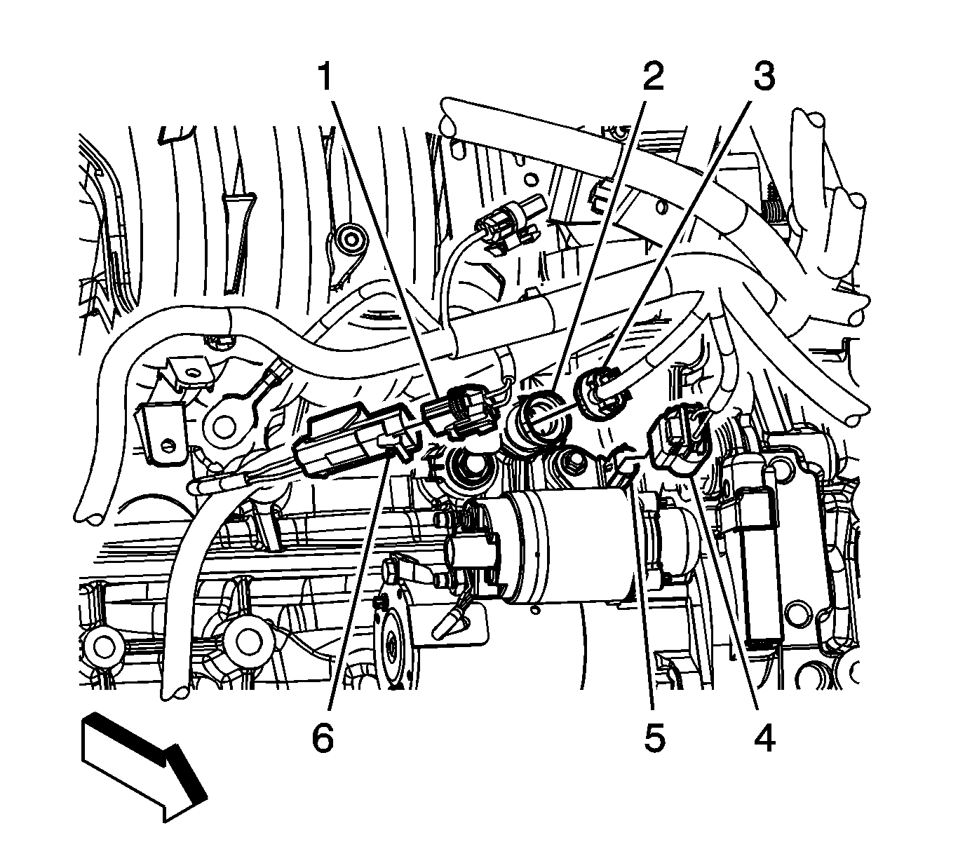

pic 6
1. Disconnect the negative battery cable. Refer to Battery Negative Cable Disconnection and Connection (LAT) (See: Battery Cable > Removal and Replacement)Battery Negative Cable Disconnection and Connection (LZ4, LY7, and LE5) (See: Battery Cable > Removal and Replacement).
2. Raise and support the vehicle. Refer to Lifting and Jacking the Vehicle (See: Vehicle Lifting > Procedures > Lifting and Jacking the Vehicle).
3. Disconnect the engine wiring harness electrical connector (1) from the knock sensor pigtail electrical connector (6).
4. Remove the knock sensor electrical connector pigtail (6) clip from the oil level indicator tube bracket.
