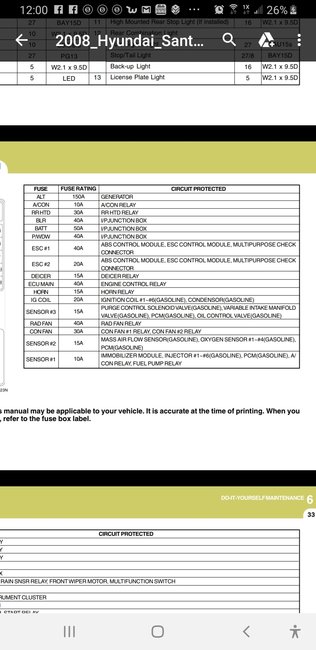

Is fuse number 25 under the hood It's a 10 amp fuse. Reasoning behind the Fuel pump is Wore out and pulling too much app. The fuse blows as soon as you turn the switch on. Put a bigger amp fuse in it will run a little while before it blows.

Never, never, ever install a bigger fuse. Due to the current draw, you may have done more damaged the wiring for the circuit and have complicated the issue.
Is this the fuse that fails?

Sensor one at the bottom of this list is the one that keeps blowing.
Jun 16, 2019 at 7:51 AM
Okay, the wiring needs to be checked from the sensor back.
The fuel pump fuse has no connection to the sender circuit.

Even though it says fuel pump relay?
Jun 16, 2019 at 7:55 AM
What says the fuel pump relay?
Jun 16, 2019 at 7:57 AM
BIG'UN
  • 19 POSTS
The fuse it keeps blowing.
Okay, that would account for the pump but not the sender. The 463,464 codes are for the sender which works on a separate circuit than the pump.
