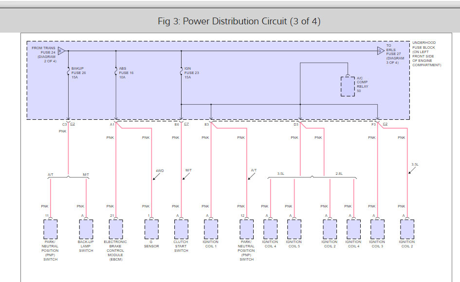

It left me stranded for hours. I go to start it and it blows fuse #23 ignition. I tried all the tricks for the ignition, even replaced the electrical component on the back of the ignition. I have not messed the other part. Thinking that might do it, nothing. Same thing blown fuse. So I am thinking bad ground, direct short. Help

That fuse power the ignition coils and clutch neutral switch. Can you please unplug them and replace the fuse to see if it still blows? It sounds like one of the coils has shorted here is a wiring diagram so you can see as well.

TREVDOG71
Yes it was the coils.
Thanks

Update: Drove the truck around the block and it is still doing it.

That fuse supplies power to the AC compressor relay and the park/neutral safety switch. Can you leave the HVAC off to see if it still does it?
