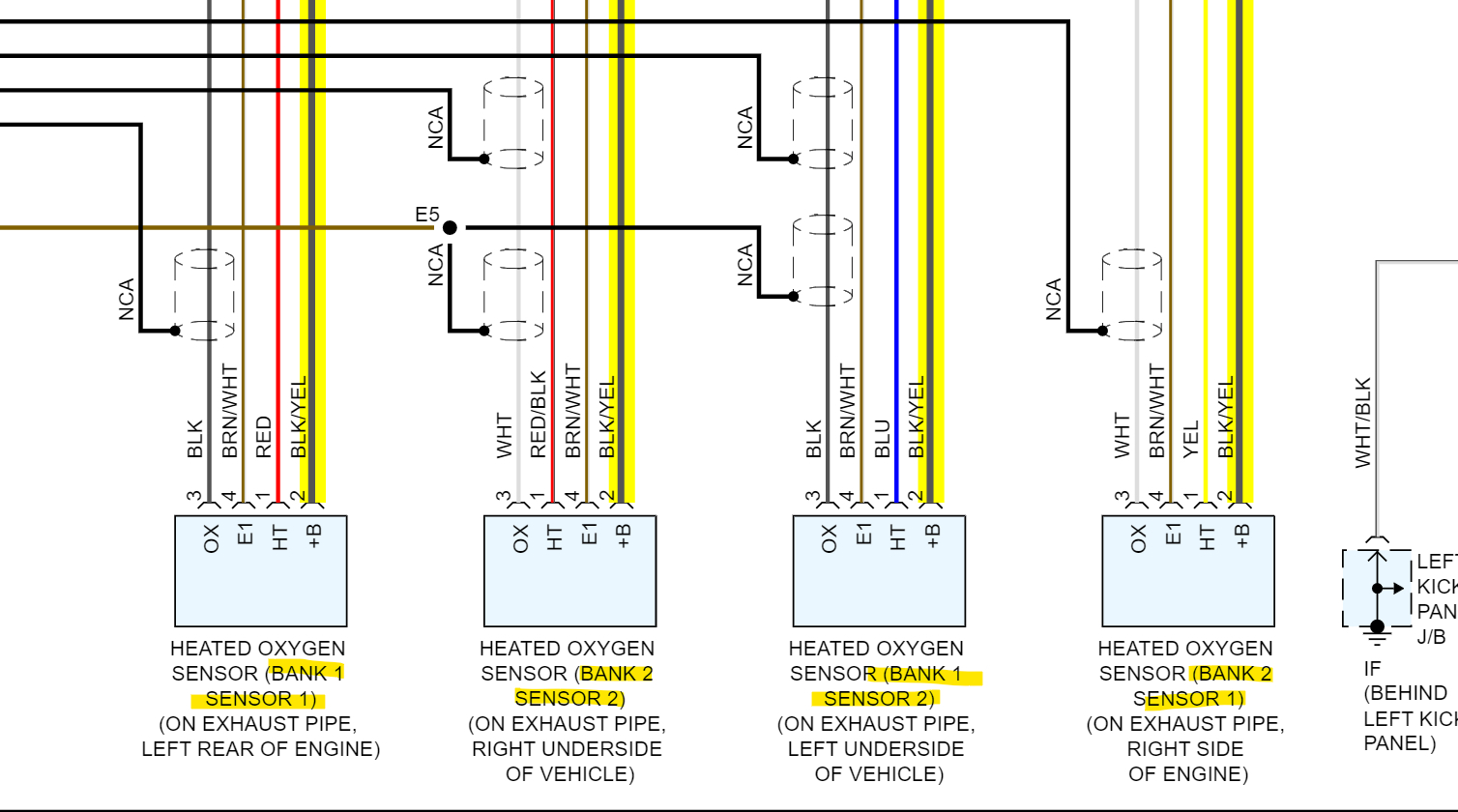

With the key Off, unplug all 4 oxygen sensors and inspect the wiring to each one, make sure there isn't a section of wire that is resting on the exhaust or has a cut in the wire insulation. All 4 Oxygen sensor heaters are on that fuse, and these are in an area where they are exposed to everything. So, start with them.

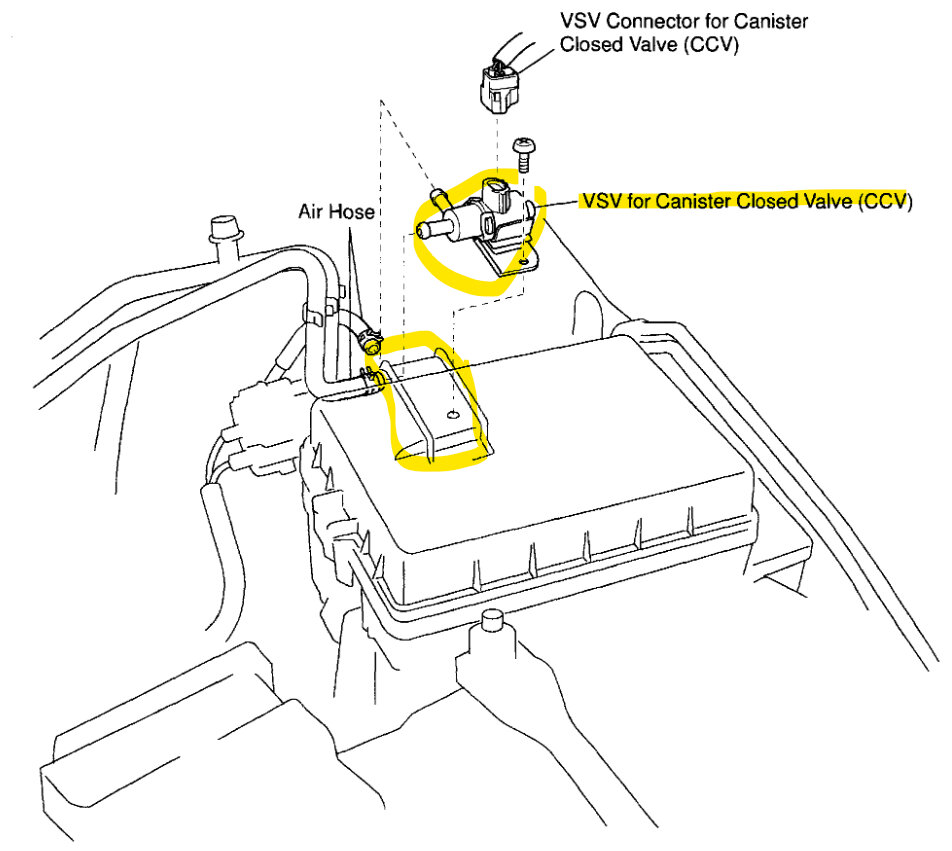

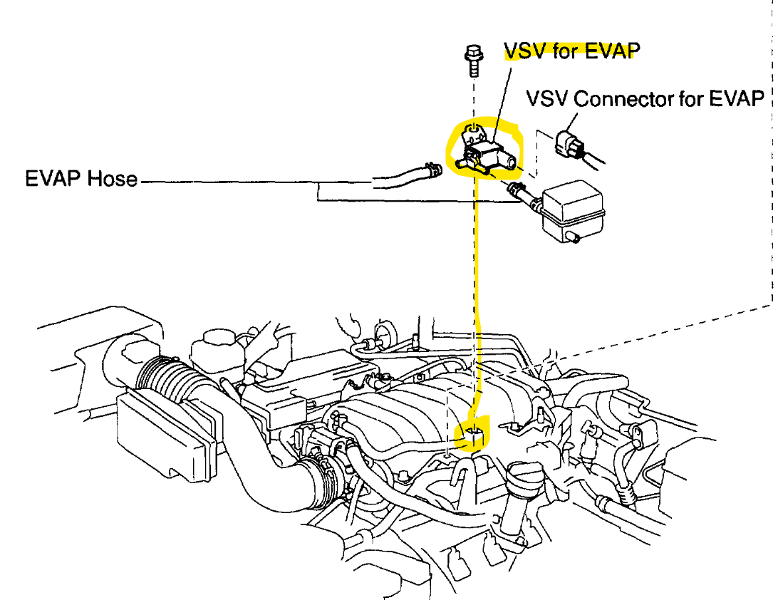

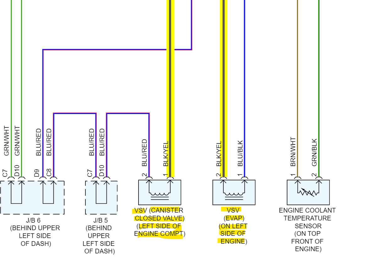

Next is the VSV Evap charcoal canister Vent valve, the wiring for it is in the 2nd diagram, and its location is in the 3rd. It looks to be near a fuse box in the engine compartment. Also notice any wiring issues going to the Vent valve, the next is another Evap system valve or solenoid (VSV EVAP). This is under the engine cover in the 4th diagram. The wire colors for it are also in the 2nd diagram.

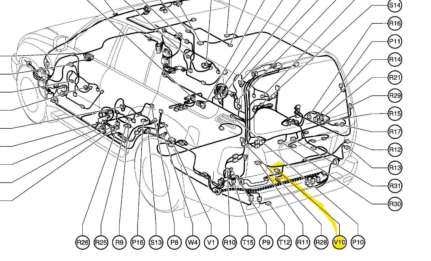

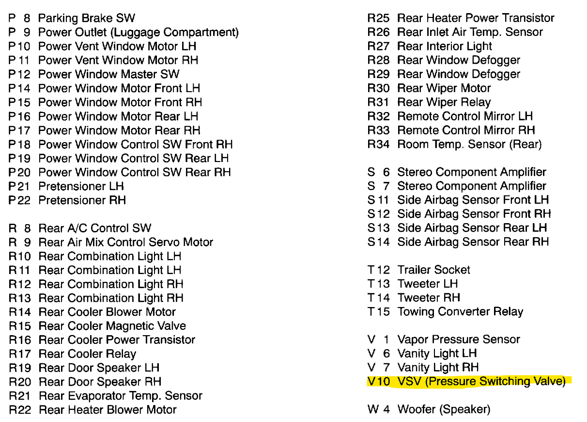

The last component on the circuit is the VSV Pressure Switching Valve, it's located under the rear of the vehicle, diagrams 5 and 6. Check this last after going through the other components.
