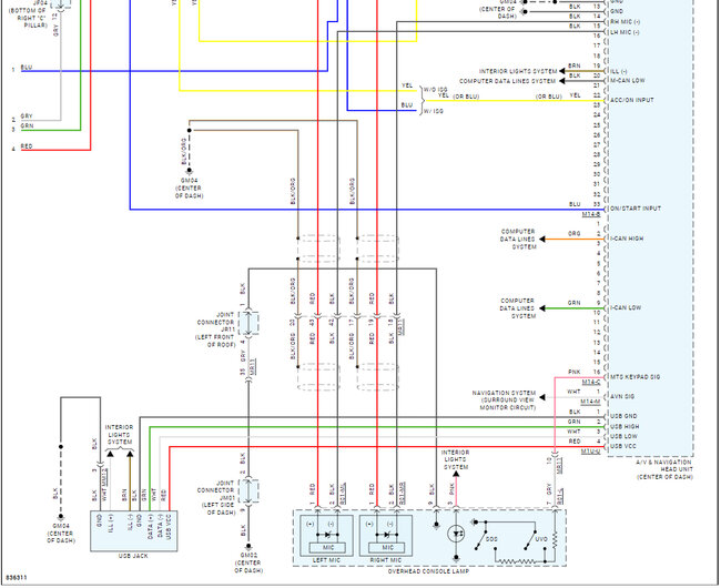

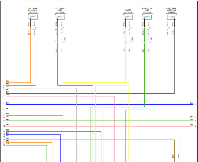

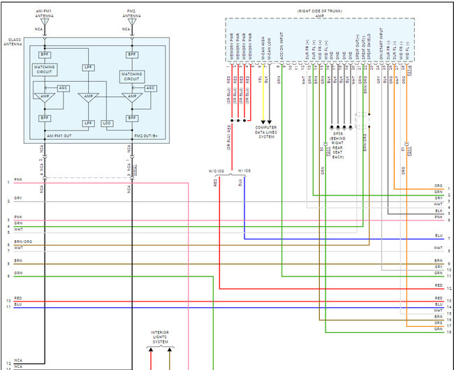

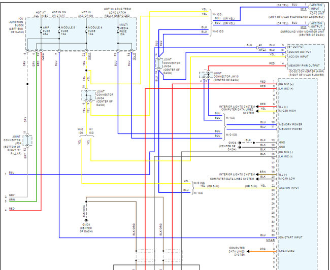

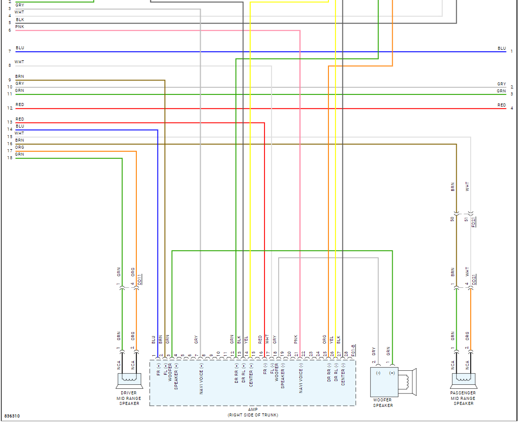

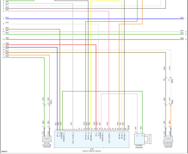

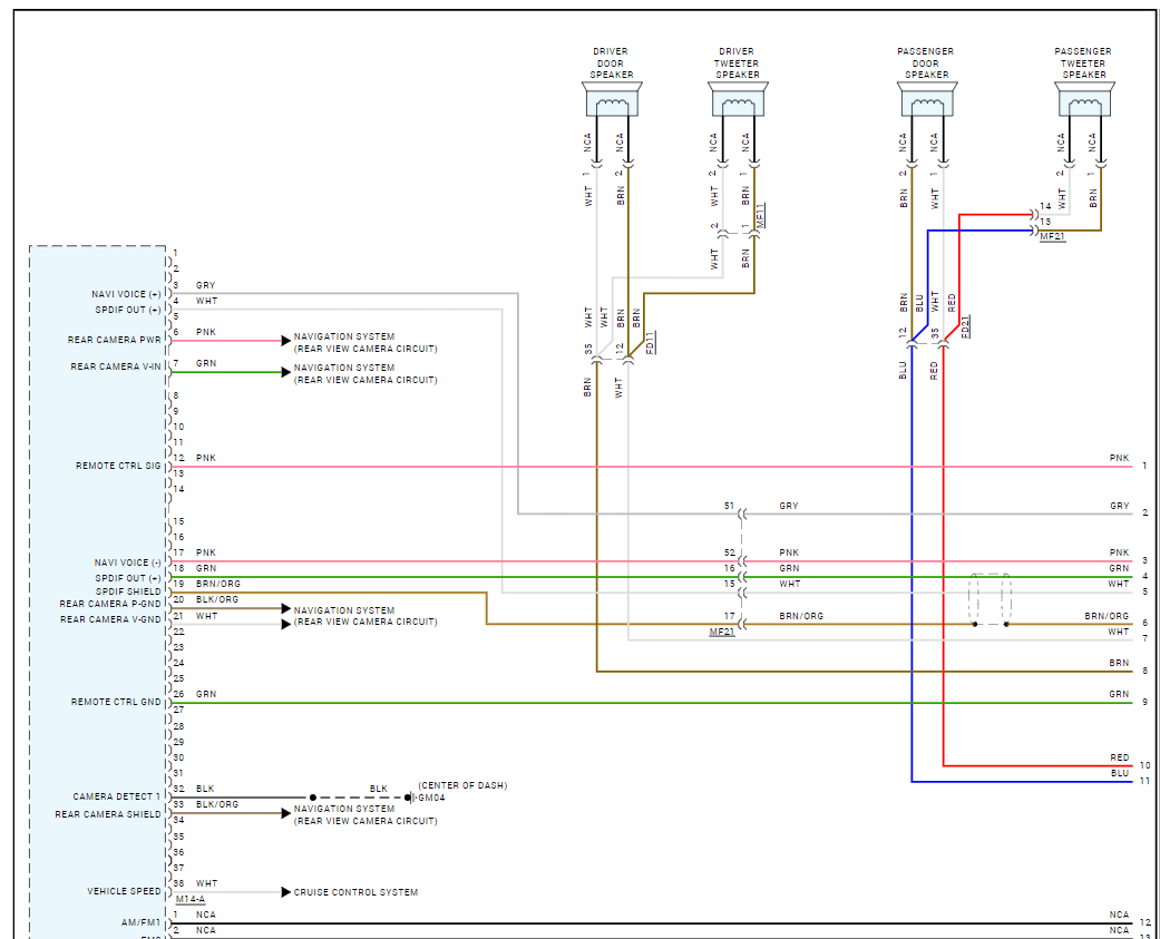

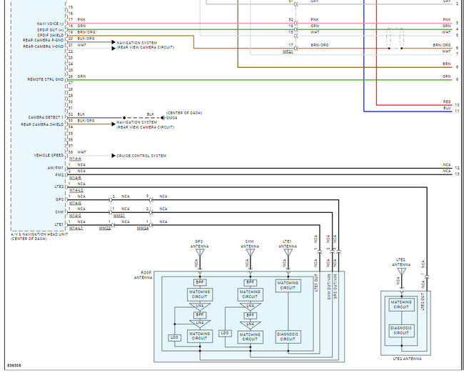

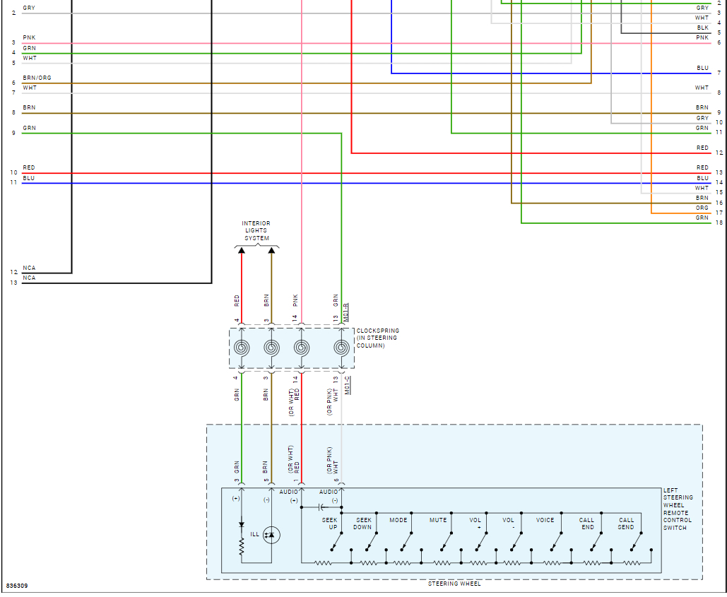

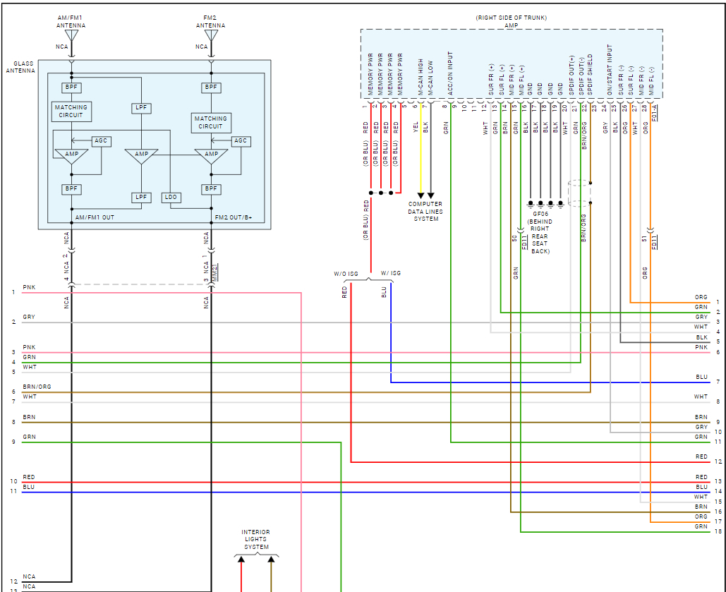

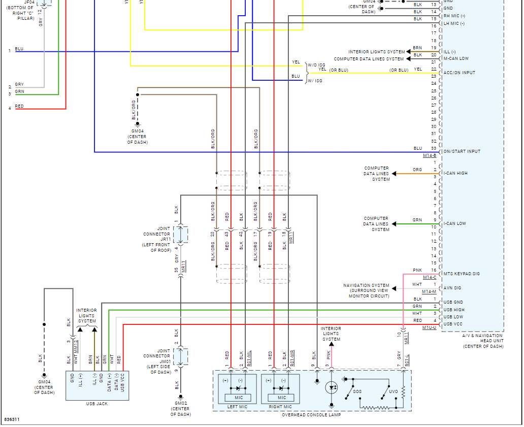

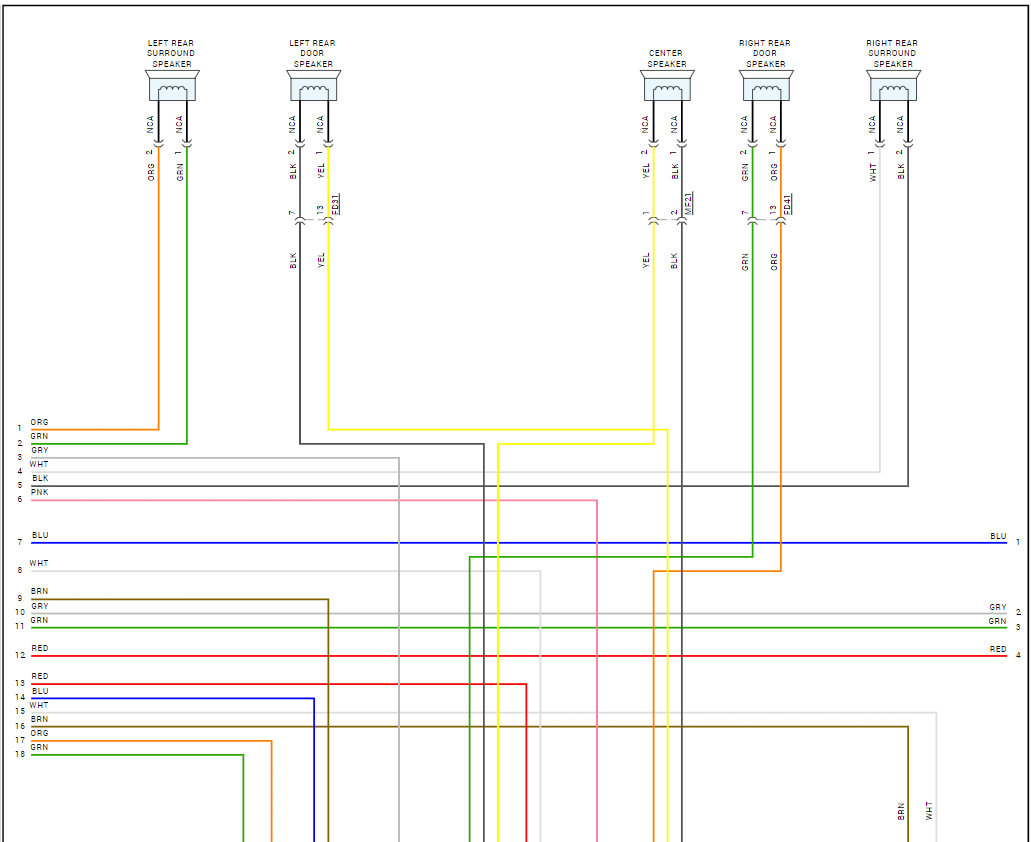

Hi, I have an EX-model which includes a Bose system. I saw on another post a condensed wiring diagram of the speakers themselves however I was hoping there was a chart/pathway diagram that shows the signal/wiring path from the radio to the built in amplifier and then a diagram chart of input/output of the amplifier itself
Apr 5, 2024 at 10:46 AM
  • 54,832 POSTS

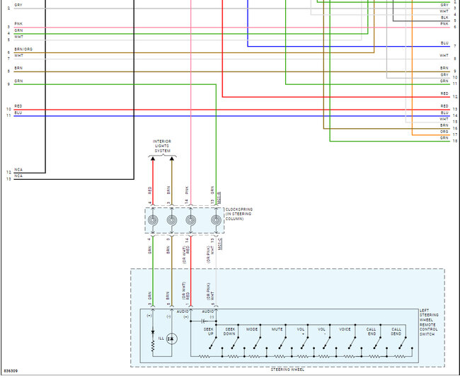

Sure, here is the radio, amplifier and navigation wiring diagrams with a guide to help you test the wiring connections.
Check out the images (below). Let us know if you need anything else.
