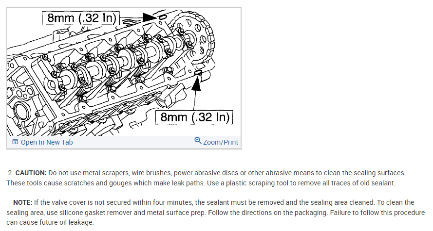

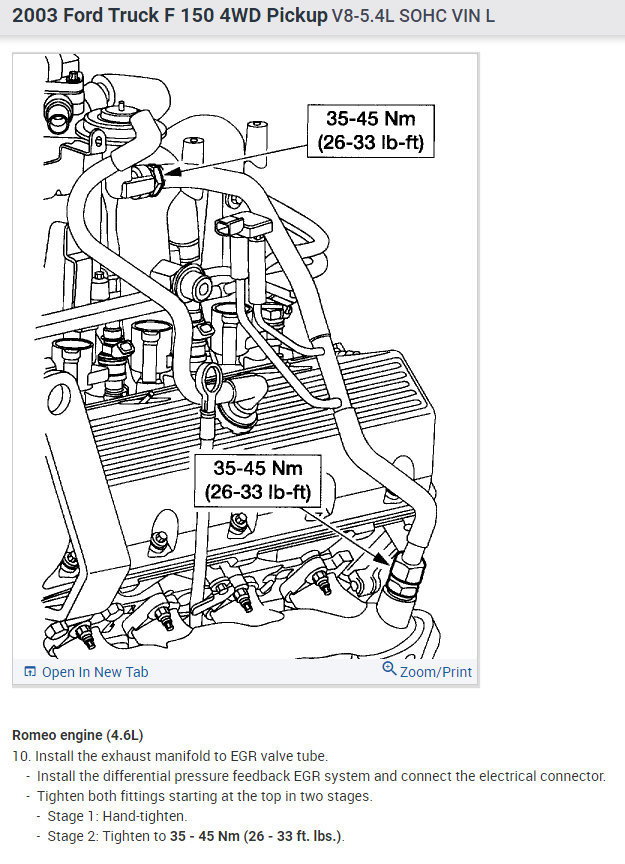

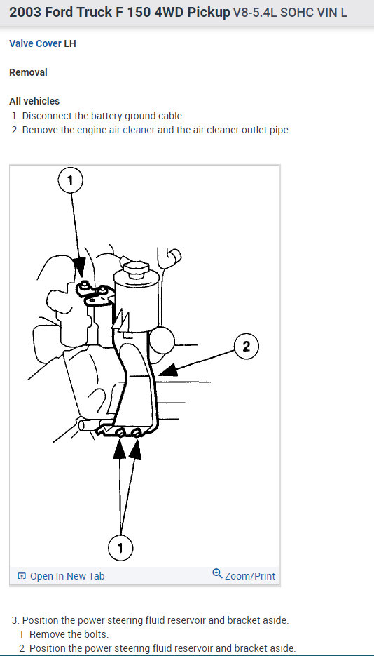

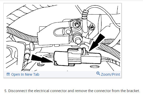

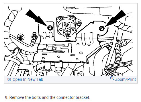

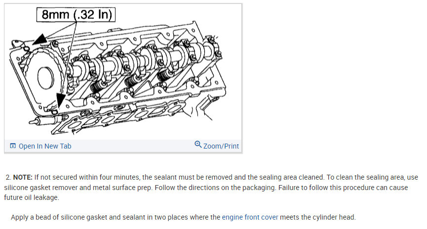

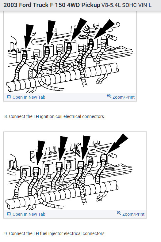

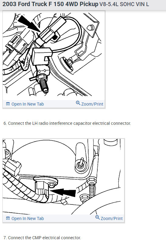

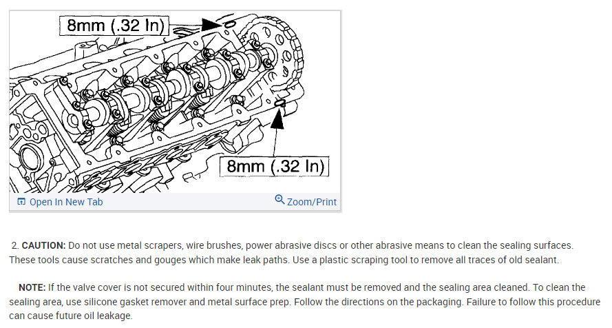

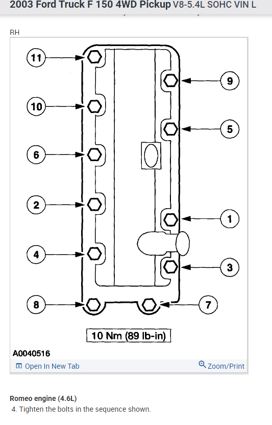

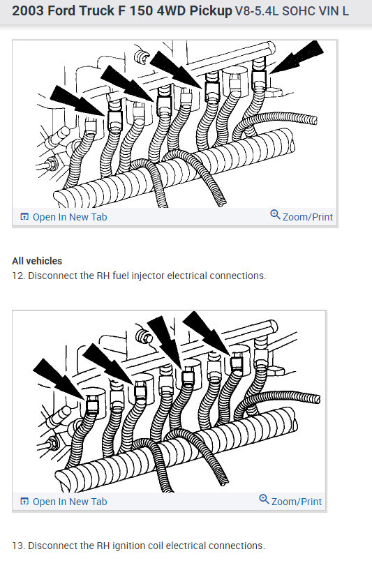

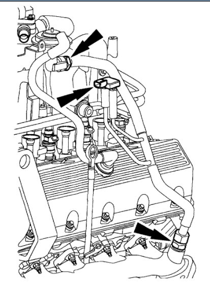

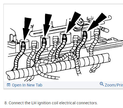

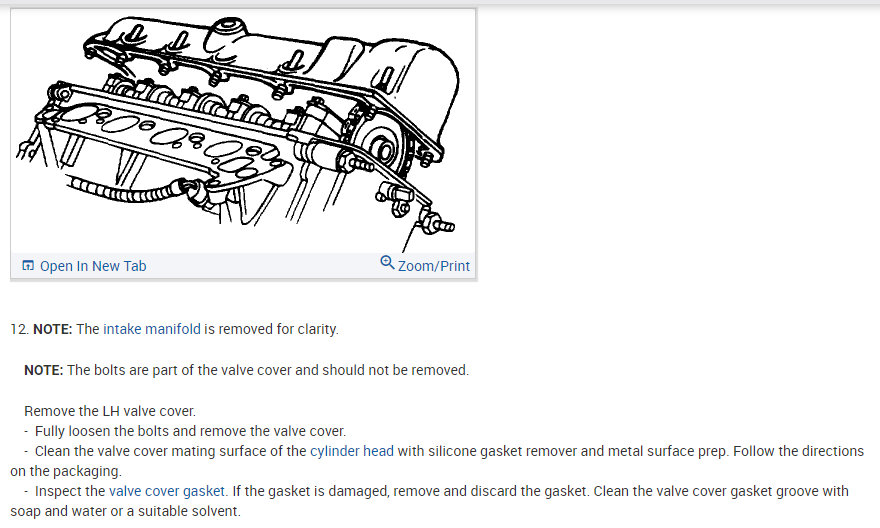

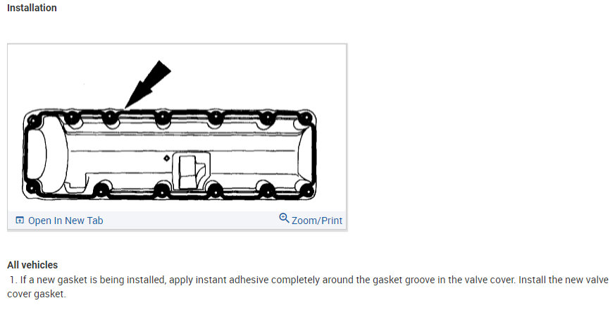

Does a valve cover gasket need to be hard to do? my friend says yes I say no.
Apr 28, 2017 at 10:25 AM
SQM
  • 6,383 POSTS

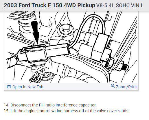

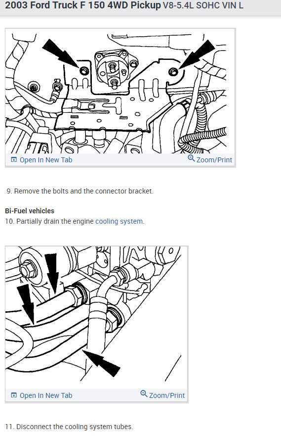

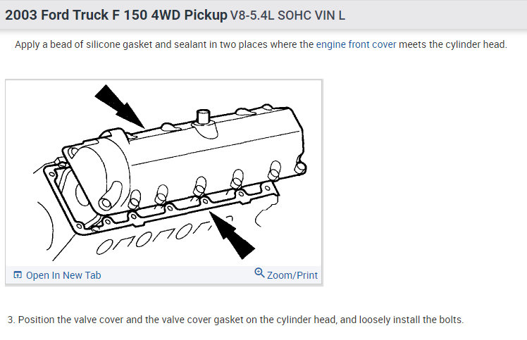

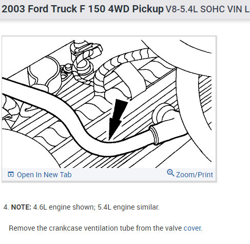

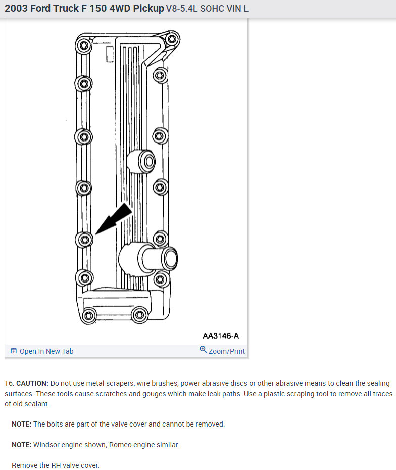

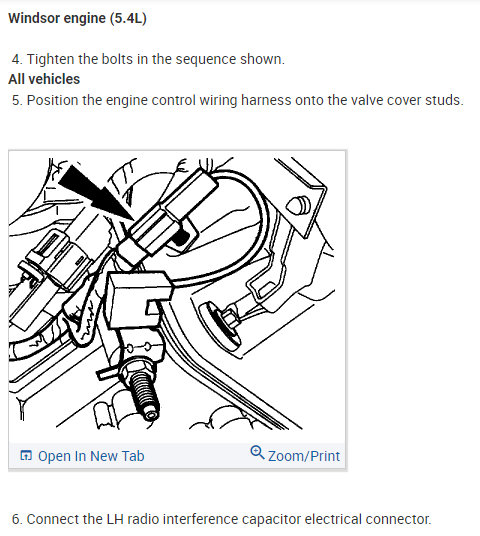

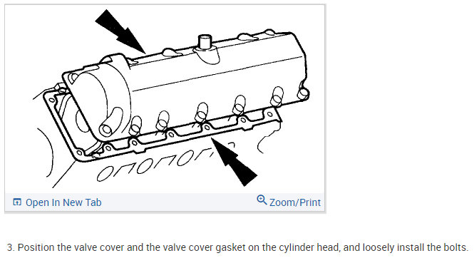

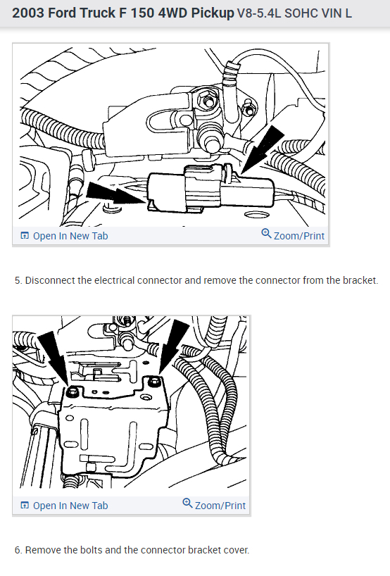

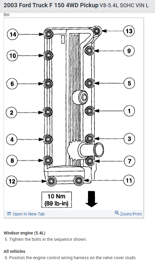

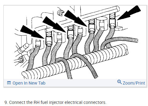

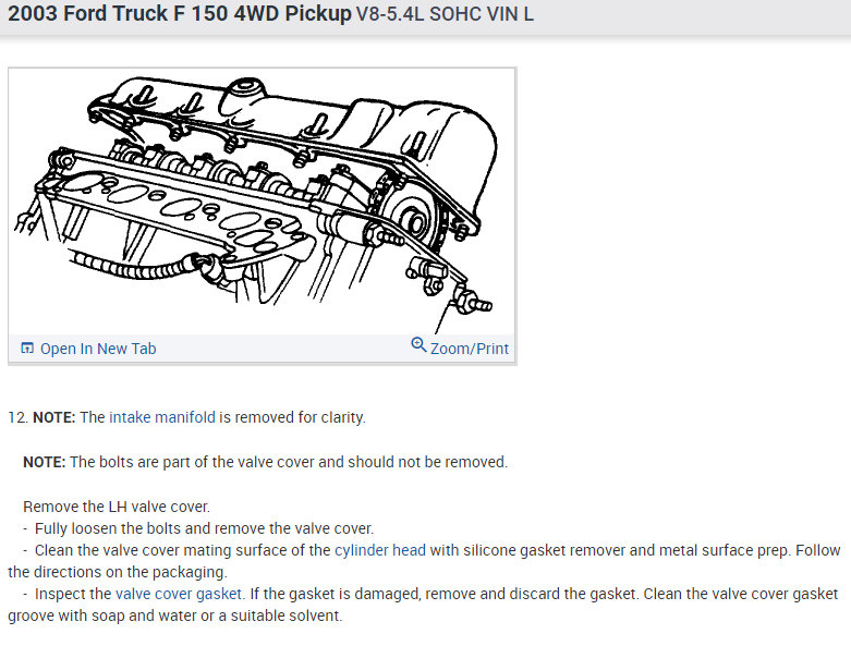

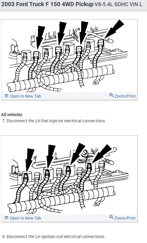

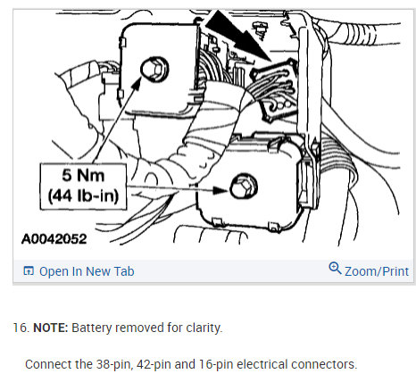

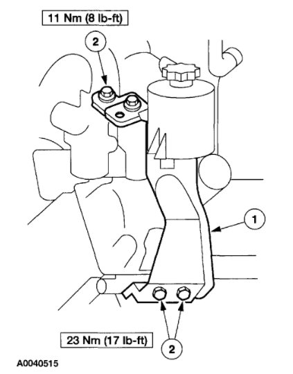

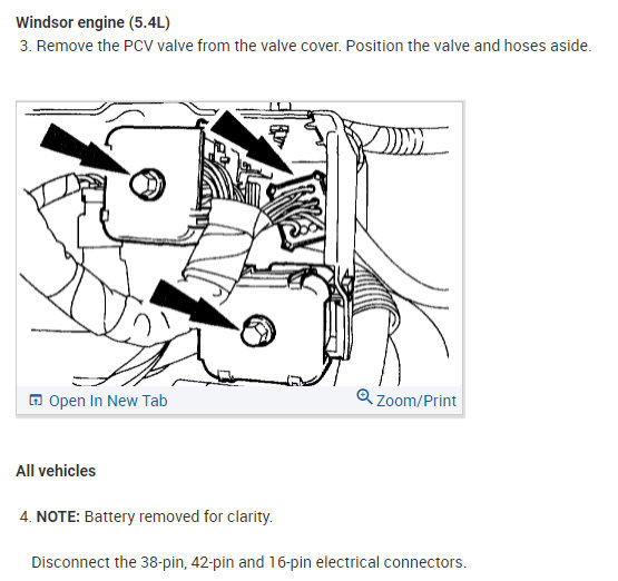

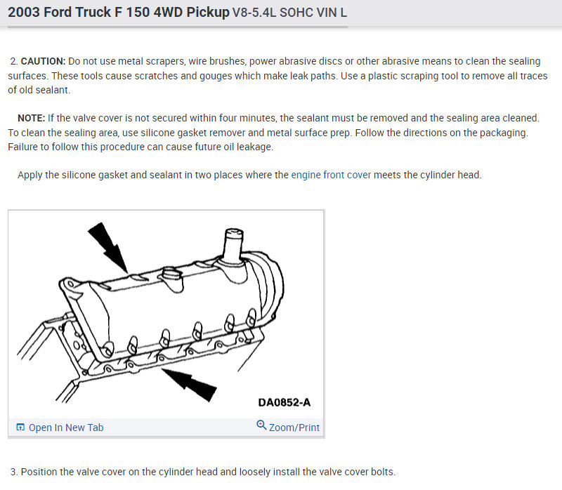

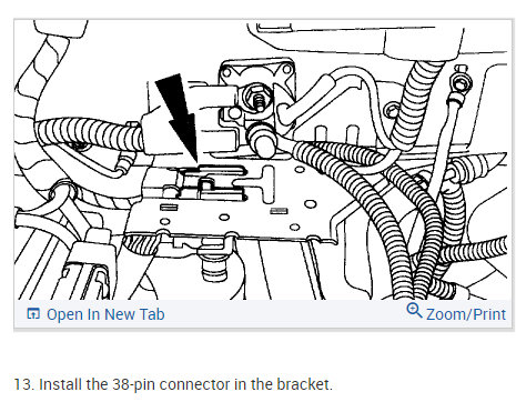

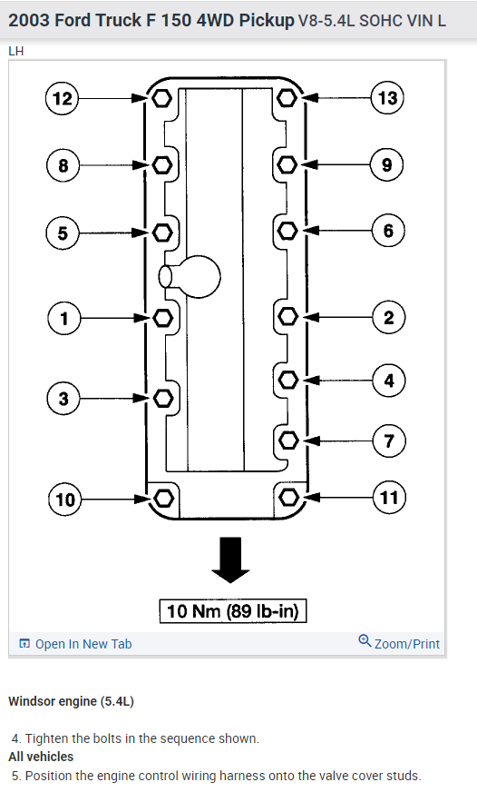

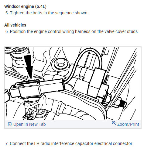

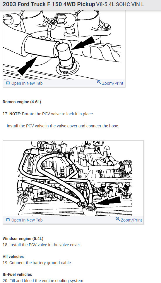

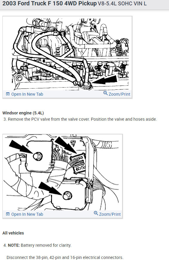

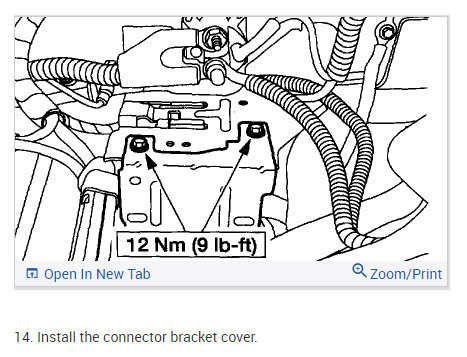

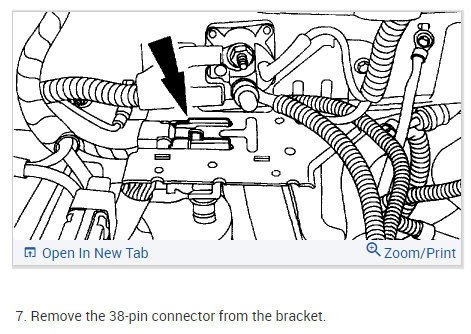

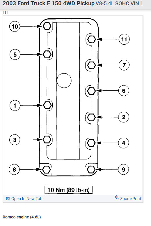

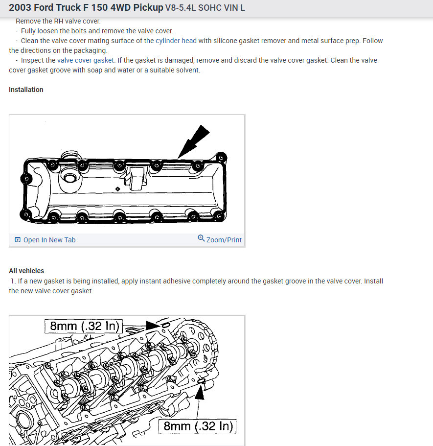

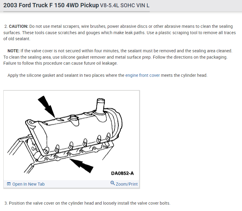

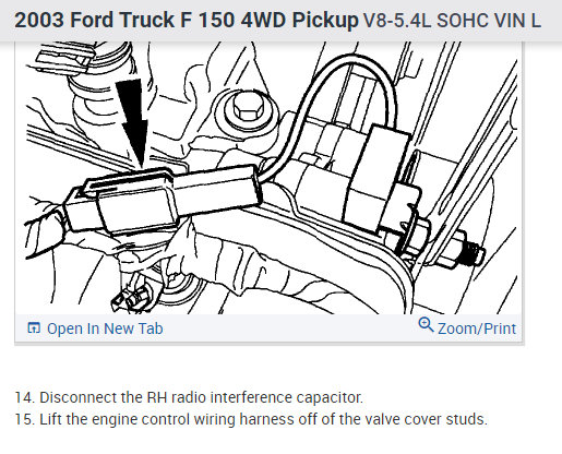

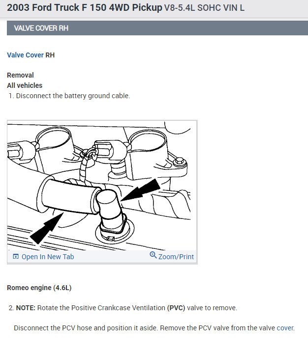

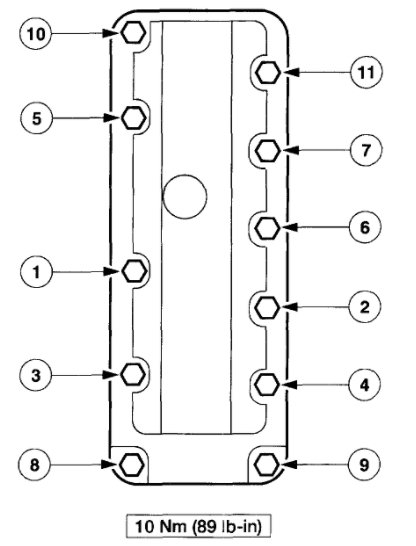

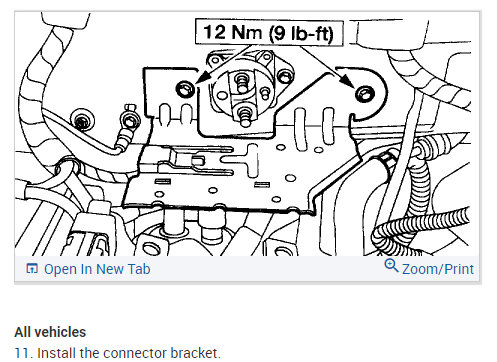

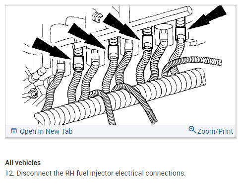

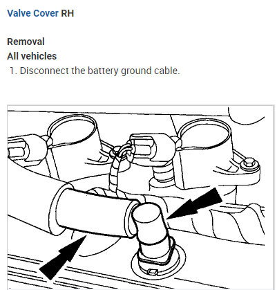

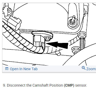

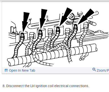

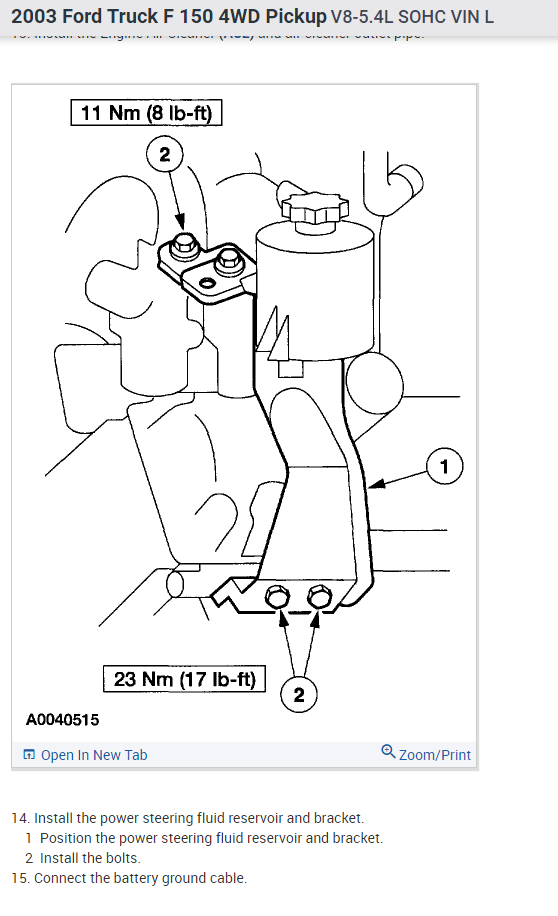

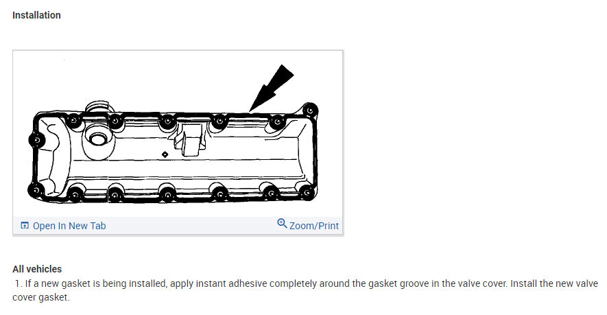

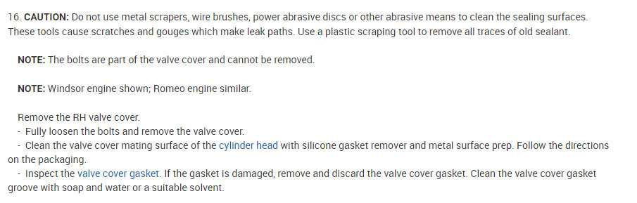

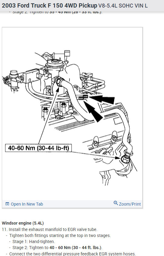

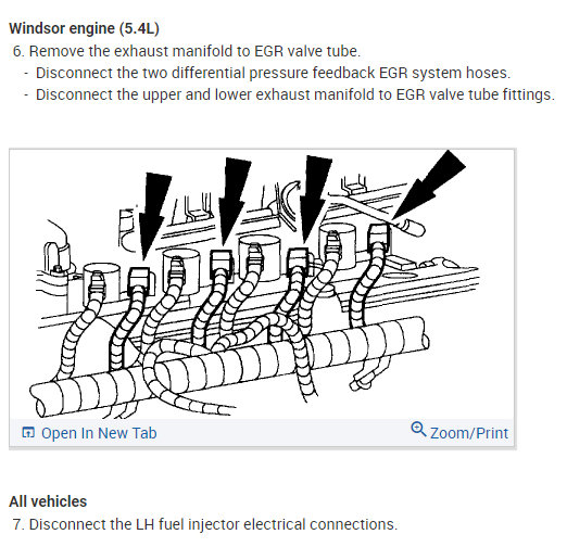

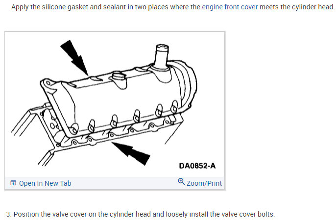

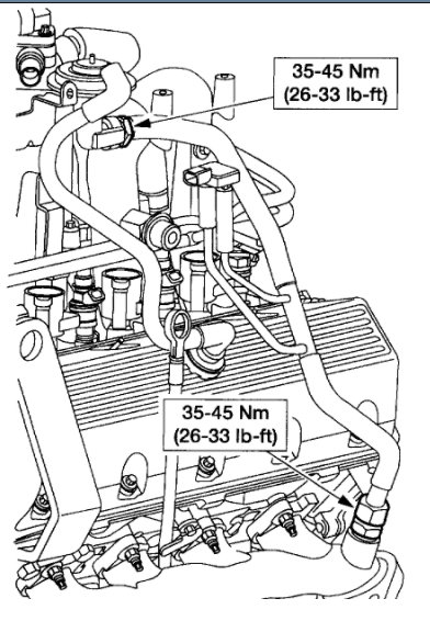

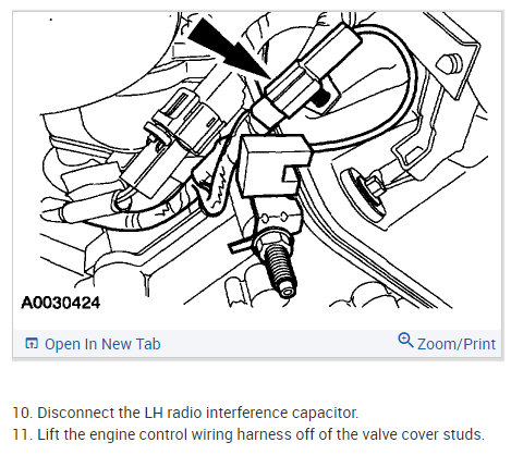

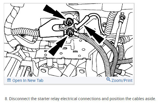

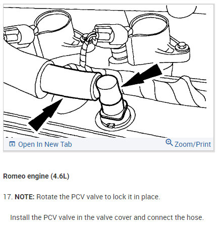

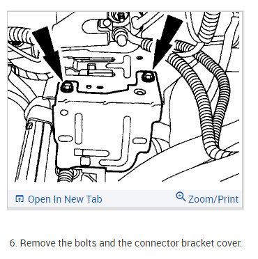

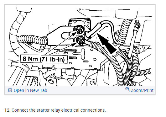

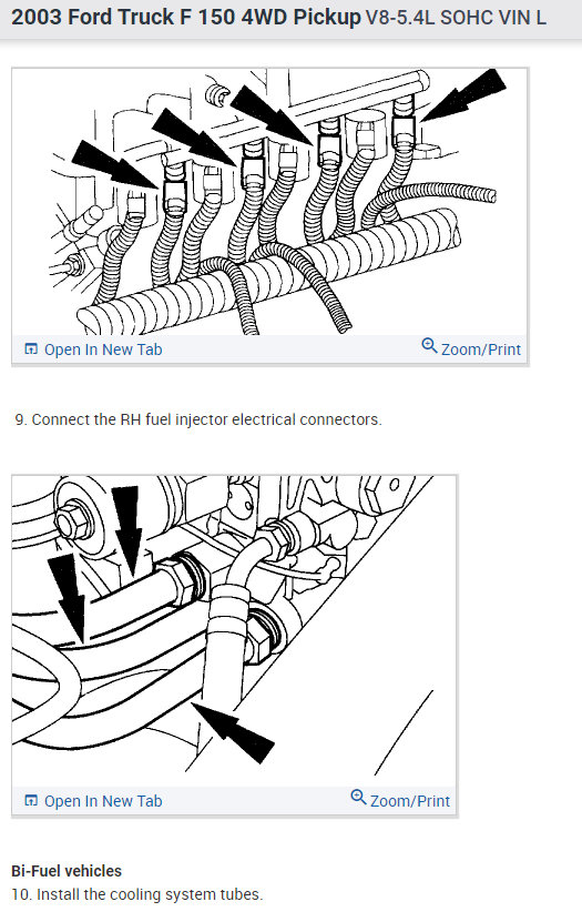

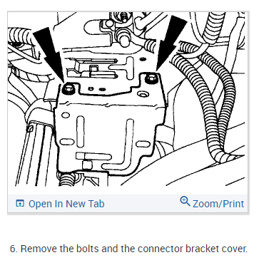

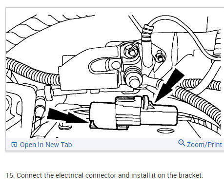

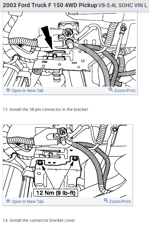

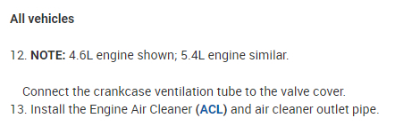

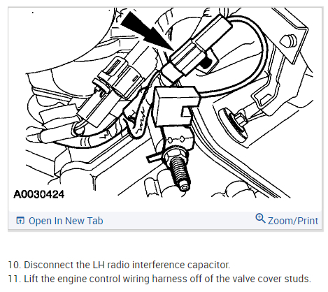

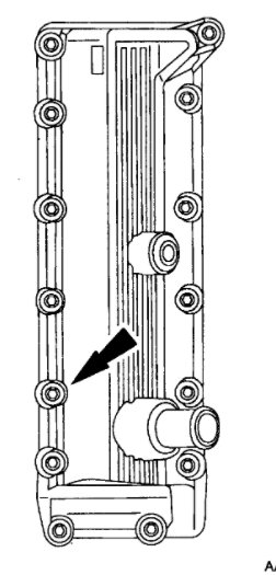

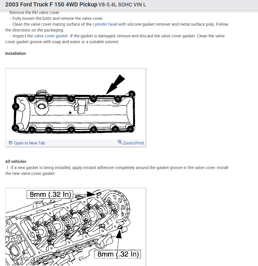

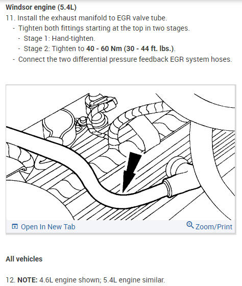

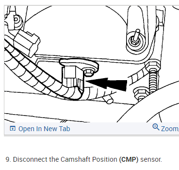

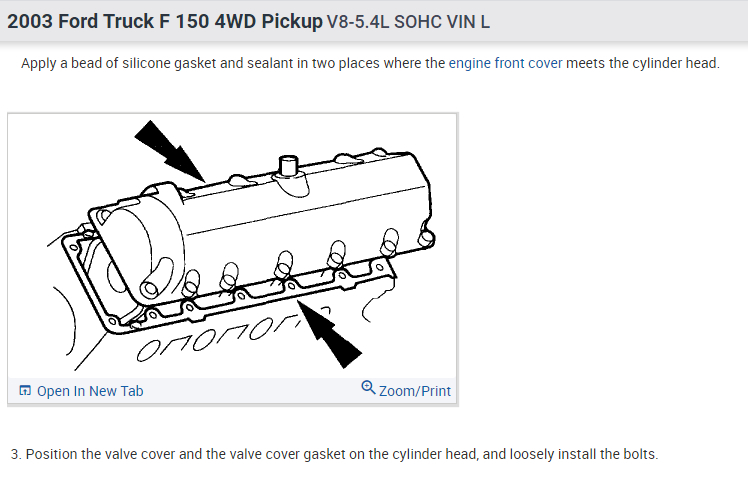

Replacing the valve cover gasket does involves removing several parts. It is not terribly difficult and can be done mostly using simple hand tools. You will need a torque wrench unorder to torque down the valve cover bolts properly.
Here is a helpful article:
https://www.2carpros.com/articles/replace-valve-cover-gasket

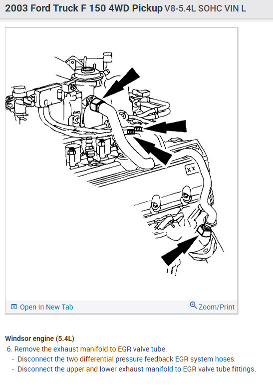

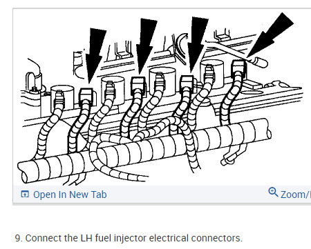

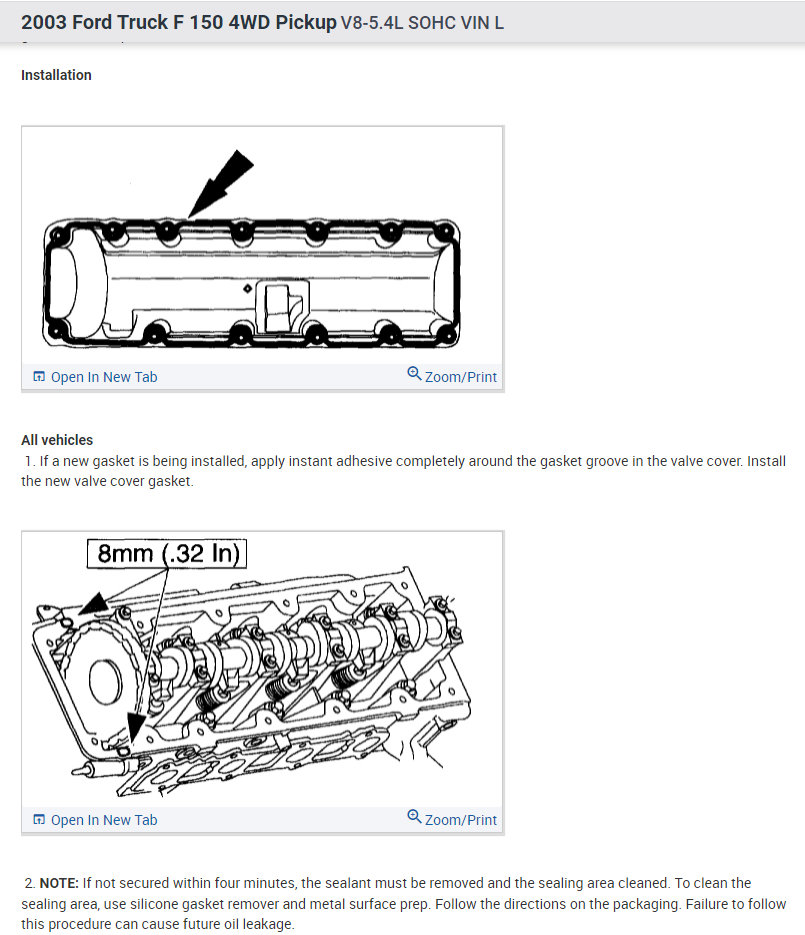

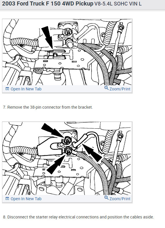

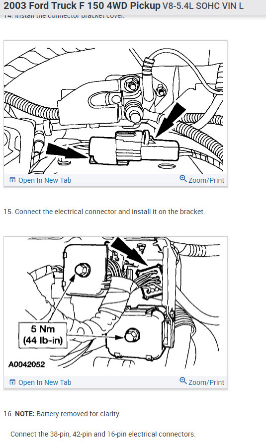

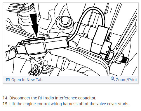

I have attached the complete replacement procedure for your reference.
Sep 14, 2021 at 9:52 AM
DANNY L
  • 5,648 POSTS

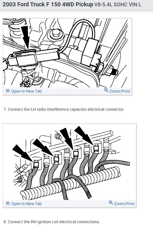

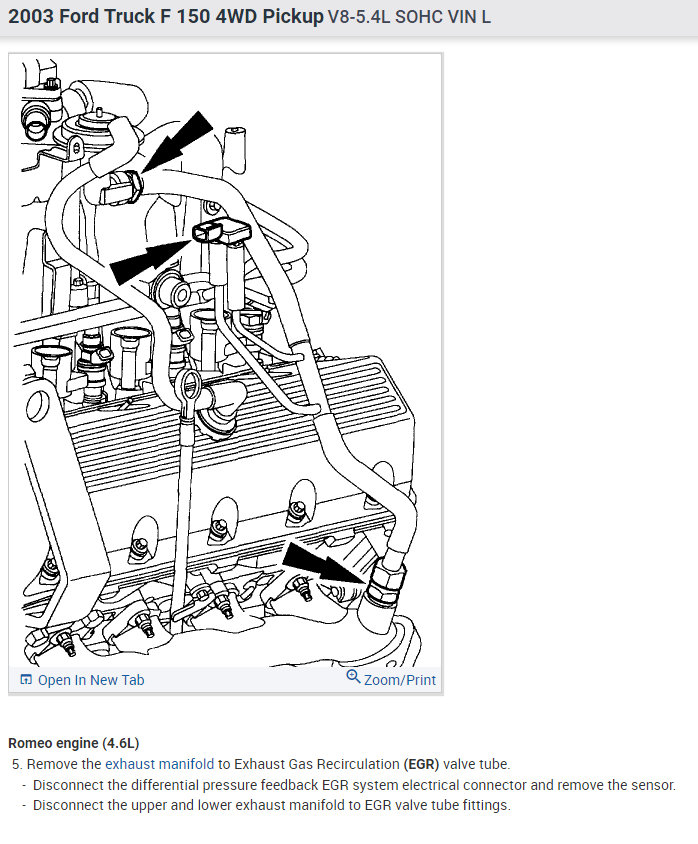

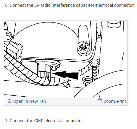

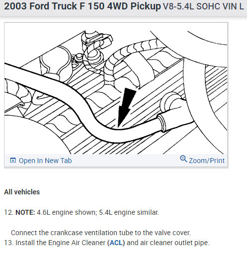

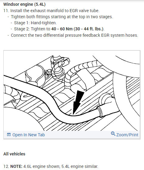

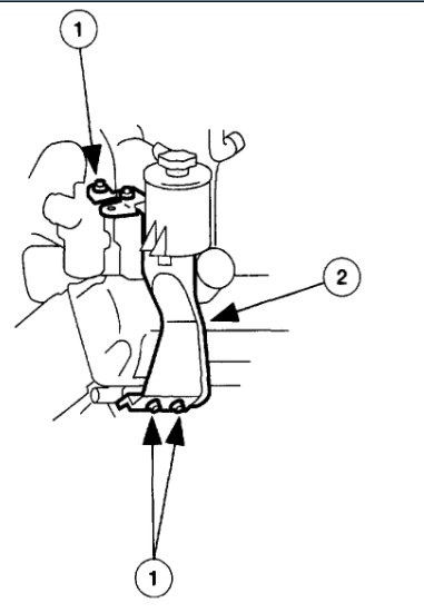

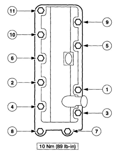

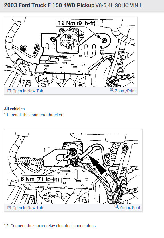

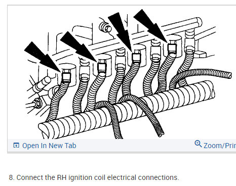

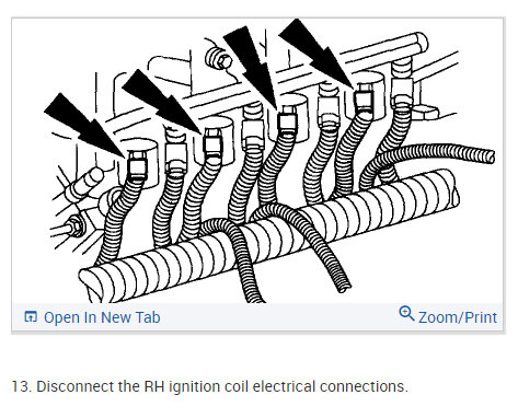

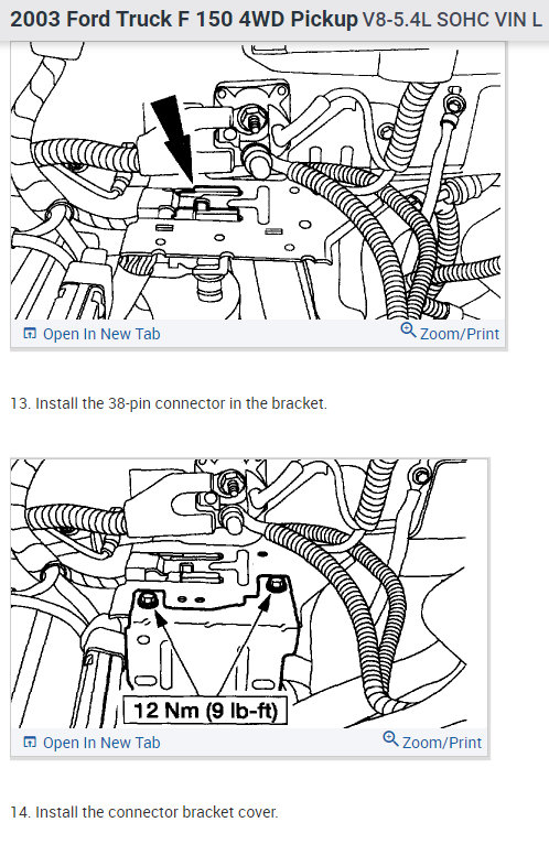

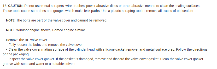

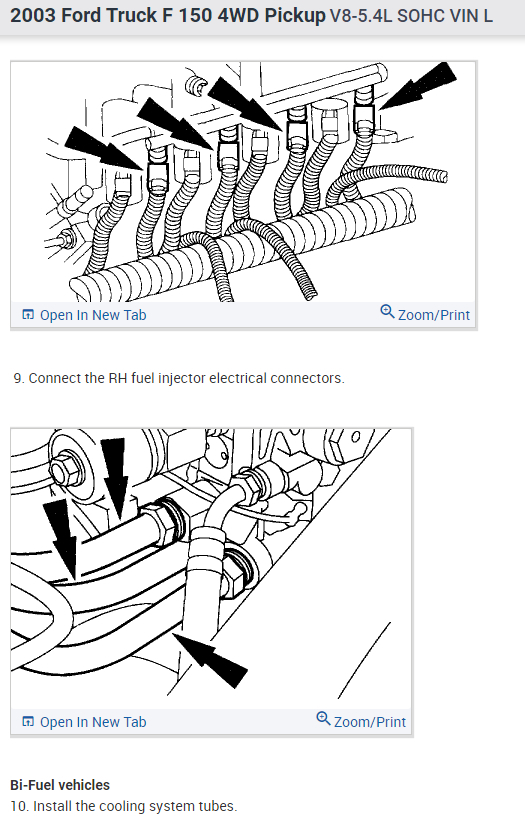

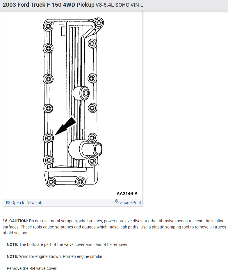

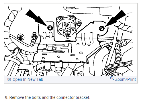

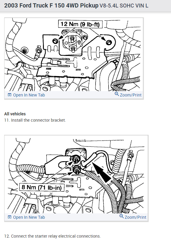

Hello, I'm Danny.

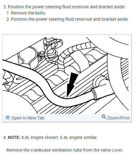

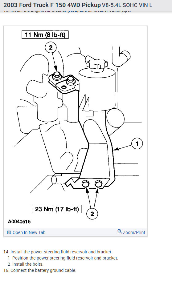

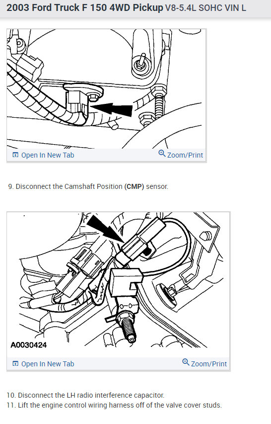

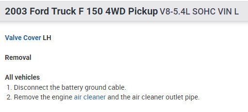

Valve cover gaskets are relatively simple. Here is the information you requested for valve cover gasket replacement. Here is a tutorial for valve cover replacement:
I've attached picture steps below for valve cover gasket replacement for both left and right side on your F-150. Hope this helps and thanks for using 2CarPros.
