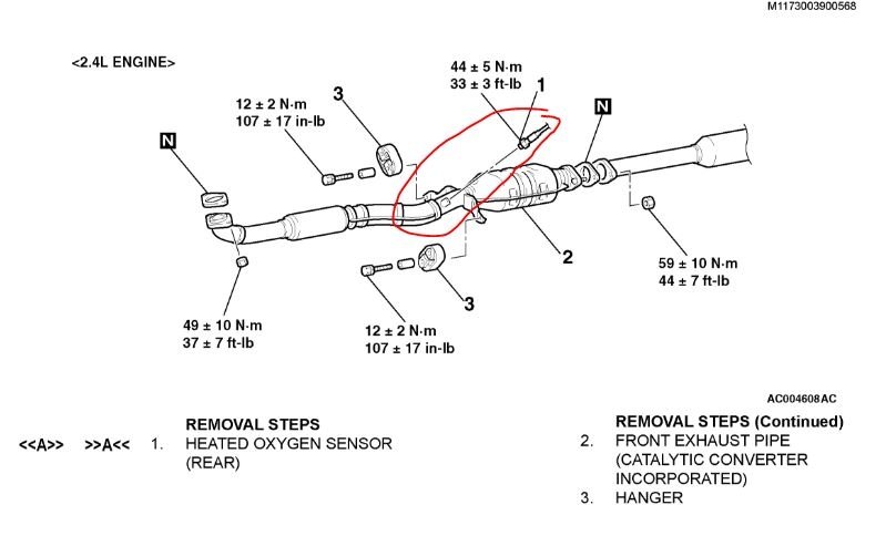

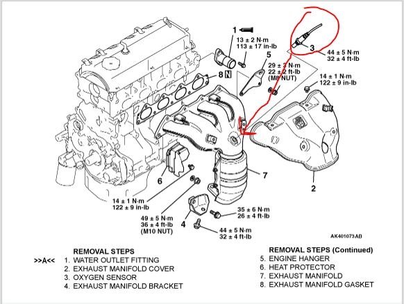

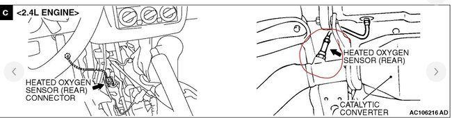

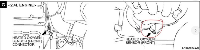

All I want to know is how many 02 sensors does my car have and where are they located?
Jun 22, 2019 at 10:39 AM
  • 110,236 POSTS
Welcome to 2CarPros.
There are two on the vehicle (4 cylinder). One is near the catalytic converter and the other is in the exhaust manifold. I attached four pictures with different views, but there are only two sensors. Please check the images below.
Let me know if this helps.
