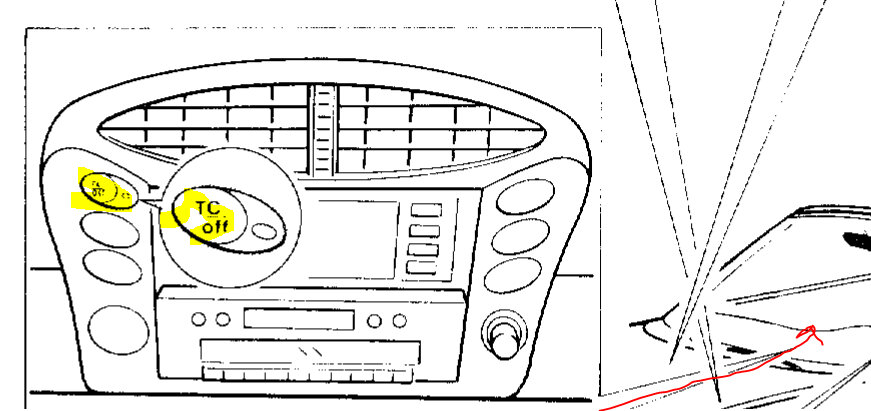

If you are referring to the lamp under the odometer, that is the traction control lamp. By any chance, have you checked the traction control switch to make sure it wasn't turned off? The light is for information and isn't a warning.
Let me know. If the switch makes no difference, you may want to consider having the can-bus scanned for codes.
Here is a link that explains how it's done:
I attached a pic below showing the switch location.
