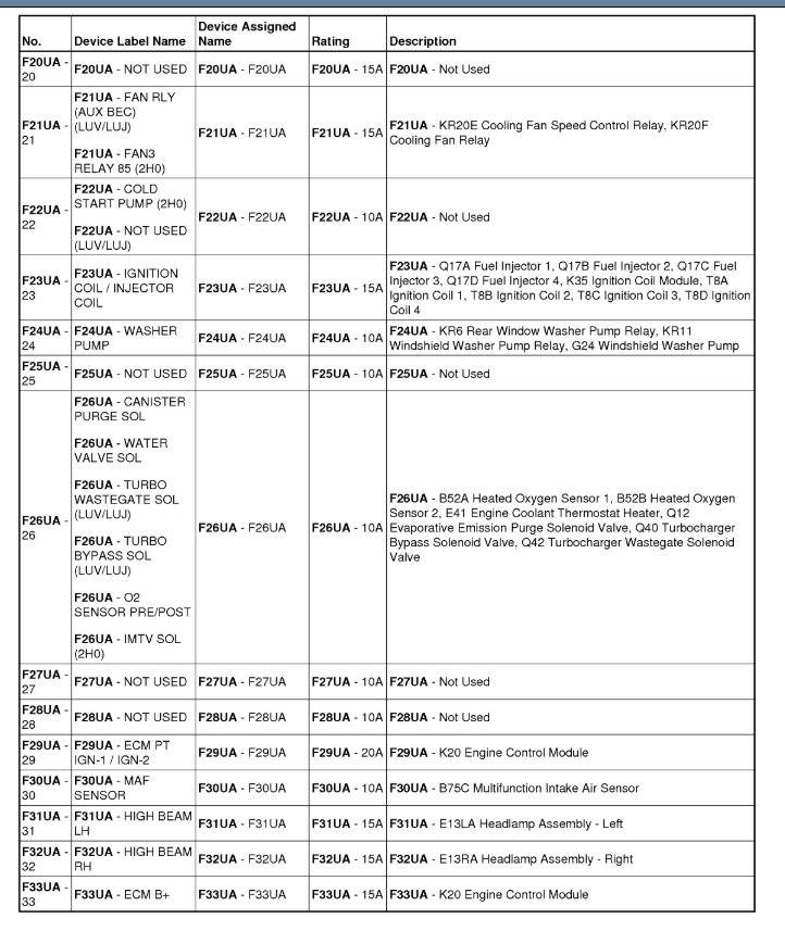

I did find a 10amp fuse under the fuse box cover that didn't seem to have a home, checked all fuses there isn't one missing and no blown fuses under hood or under dash.. I wonder with the different models if it would effect the computer at all?

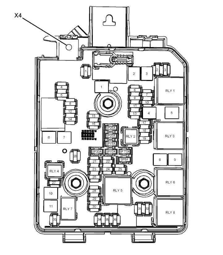

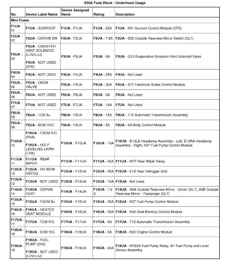

Okay, lets clear the codes, then with the codes cleared turn the key on without cranking the engine to see if any codes come up this will be the one we chase it should if the others. If no codes come up crank the engine then read the codes again. Can we check fuse #18 for power (key on) here is a guide to help and the fuse location in the diagrams below.
