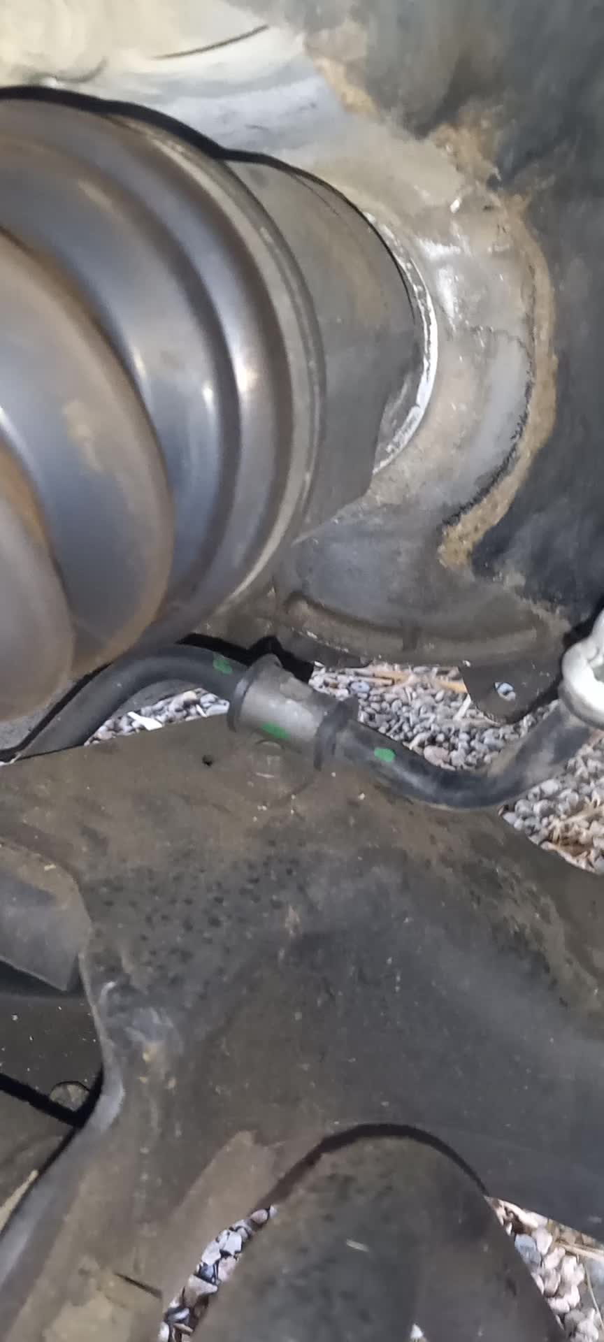

Just replaced cv axle is this to much play?
2005 FORD FIVE HUNDRED
120,000 MILES • 4WD • AUTOMATIC
DAVENOOB
  • 371 POSTS
I just replaced the cv axle and now it looks and sounds like this while spinning the wheel hub. It doesn't spin freely not sure if it's supposed to. Could this be the wheel hub assembly?

Completely normal. That is the play in the internal gears that allow the gears to move without binding as they heat up from friction.

Ok thanks. I just replaced this part. After 500 miles started making weird clunking sounds and brakes were sticking. I went through and retightened everything. One caliper bolt was loose maybe that was the issue. Cab you think of anything else that it could be?

Loose caliper bolt could cause those issues as the caliper can move around. If it is the caliper bracket to steering knuckle bolt I put blue loctite on those. Then if it's the slide bolts, I use blue loctite and torque them but I usually put it inside the threads on the caliper bracket so it doesn't get on the outside and bind anything. The play you have is in the gearing, it's there so that all of the internal parts can move without binding. The transfer case and rear differential also will have some movement like that. If you have ever used 4 wheel drive on a solid surface and felt the truck "bunny hop" when trying to turn in a tight circle, that is torque wrap. The hop is caused when one of the tires loses traction and all of the play in the driveline frees up, then it gets removed as soon as it has traction again and the cycle repeats until you stop the tight turning or something breaks. The other item that can make a clunk in the driveline are the universal joints. They can wear and become loose or they can start binding due to seal failure letting moisture in. For those you get either end of the truck off the ground and try turning the driveshaft, listen for squeaks or clunks if you rotate the driveshaft back and forth.

Thanks. Once test driven I'll update. From information you provide I'll ask another question. Have a great weekend!

Seems fine a quick spin around the block thanks.
