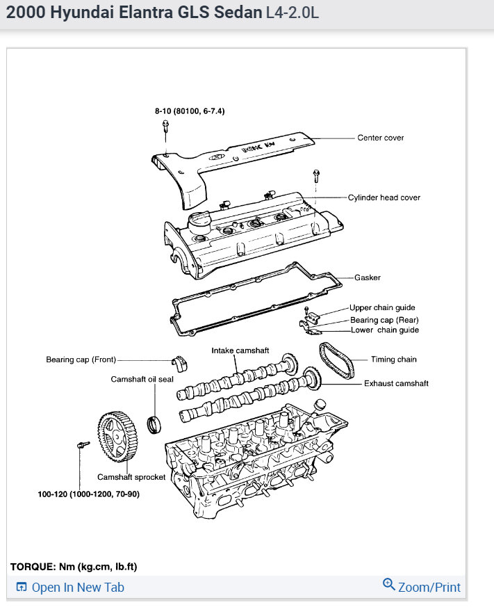

process and torque specs for valve cover gasket?
2000 HYUNDAI ELANTRA
149,455 MILES • 2.0L • 4 CYL • 2WD • AUTOMATIC
AZDANNO04
  • 348 POSTS
If you can send me process and torque specs for valve cover gasket and lower gasket by manifold. Also believe leaking by oil pan. Oil pan gasket may need replacement.
Aug 18, 2023 at 6:16 AM
  • 54,840 POSTS
Here is a generic guide to help you step by step with instructions in the diagrams below on how to change the valve cover gasket on your car:
https://www.2carpros.com/articles/replace-valve-cover-gasket
Cylinder Head Cover Bolt 8 - 10 Nm
Check out the images (below). Please let us know if you need anything else to get the problem fixed.
