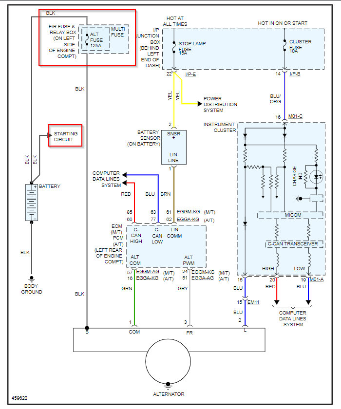

Sir, at battery positive terminal fixture 2 cables lead off; 1 leads to starter motor. Where does other cable lead? Thank you
Jun 20, 2020 at 1:20 AM
Great question. It indirectly leads to the alternator but directly leads to the fuse box that I circled in the attached wiring diagram. As you can see the other wire leads to the starter as you mentioned.
Let us know if you need more info. Thanks
