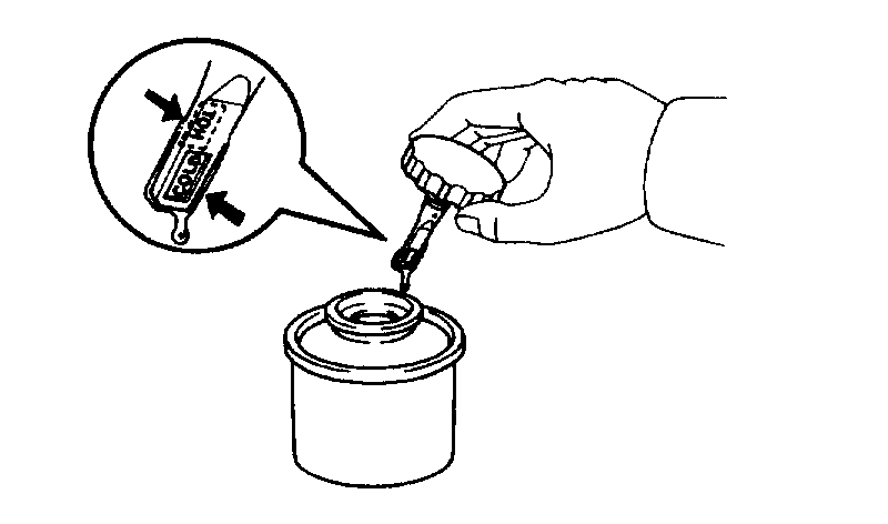

2. Check fluid level in the oil reservoir, with the engine stopped. If necessary, add fluid.
Fluid Type: ATF DEXRON II or III
NOTE: Check that the fluid level is within the HOT LEVEL range on the reservoir cap dipstick. If the fluid is cold, check that it is within the COLD LEVEL range.

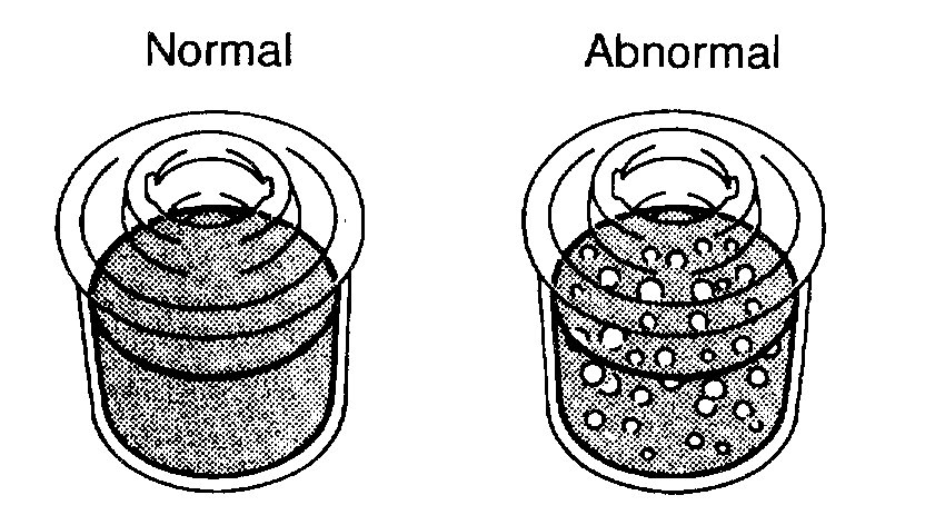

4. Check for foaming or emulsification. If there is foaming or emulsification, bleed power steering system.

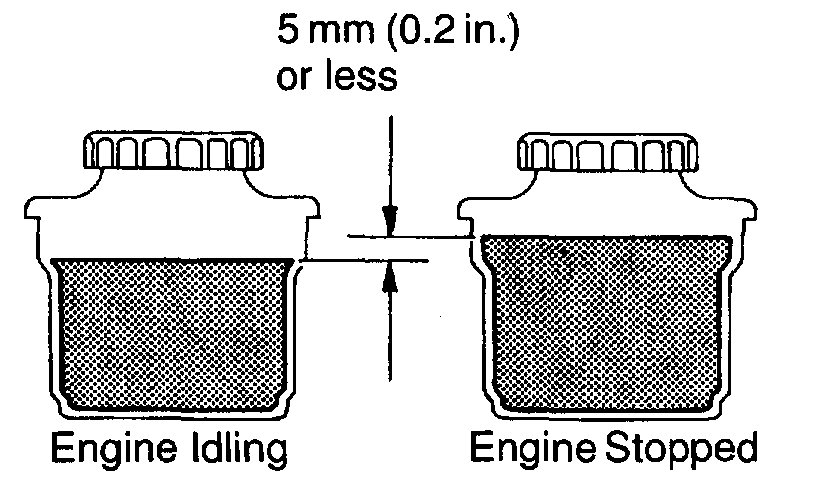

5. Check fluid level rise.
a. With the engine idling, measure the fluid level in the oil reservoir.
b. Stop the engine.
c. Wait a few minutes and remeasure the fluid level in the reservoir.
Maximum Fluid Level Rise: 5 mm (0.20 inch).
NOTE: If a problem is found, bleed power steering system.
