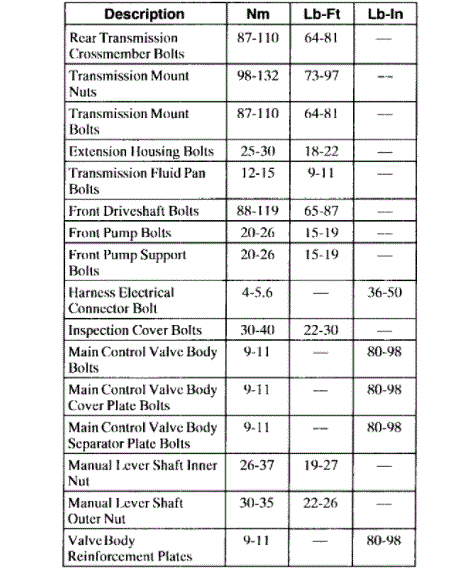

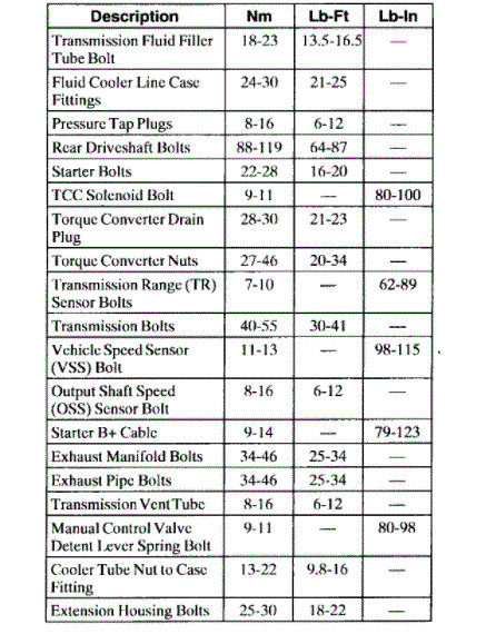

After replacing my transmission what are bolt tightening specs and how much oil to add
2002 FORD EXPEDITION
195,012 MILES • 5.4L • V8 • 2WD • AUTOMATIC
RANCHERA
How tight my bolts have to be? once I tighten my bolts put my oil do I just start it? sorry, I'm a girl doing this by my self. I had a friend helping me but had quit on me and left me the job for me to do. help please
Sep 6, 2020 at 3:45 AM
Good afternoon,
The spec is 30 pounds on the bell housing bolts. Add at 5 quarts of transmission fluid before starting. That is if the transmission has no oil in it at all.

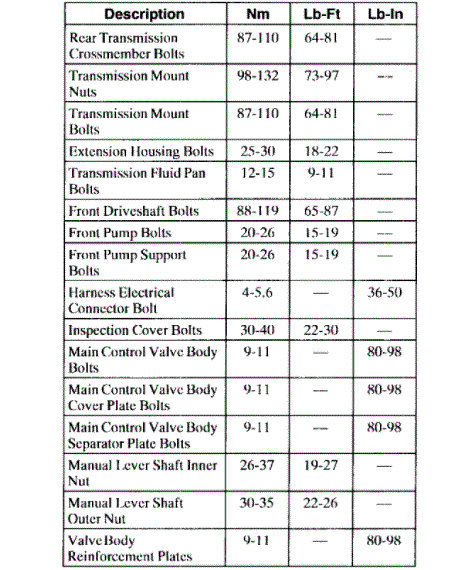

I attached all the torques for all the bolts for the transmission.
Sep 6, 2020 at 4:14 AM
