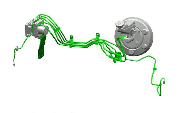

if a dual circuit system had a leak on one of its circuits, does the brake fluid all leak out after repeated pumping?
Jan 11, 2021 at 7:55 PM
Good evening,
The answer is no. Only the chamber with the leak will drain and the other will remain at its level.
https://www.2carpros.com/articles/how-to-bleed-or-flush-a-car-brake-system
https://www.2carpros.com/articles/brake-pedal-goes-to-the-floor

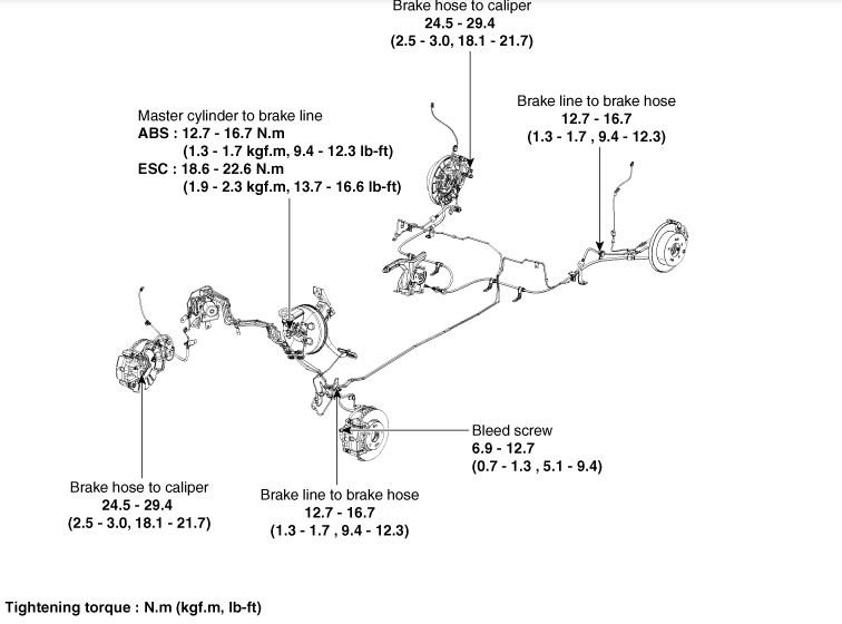

I attached the diagram of the system for you when you are looking for leaks.
