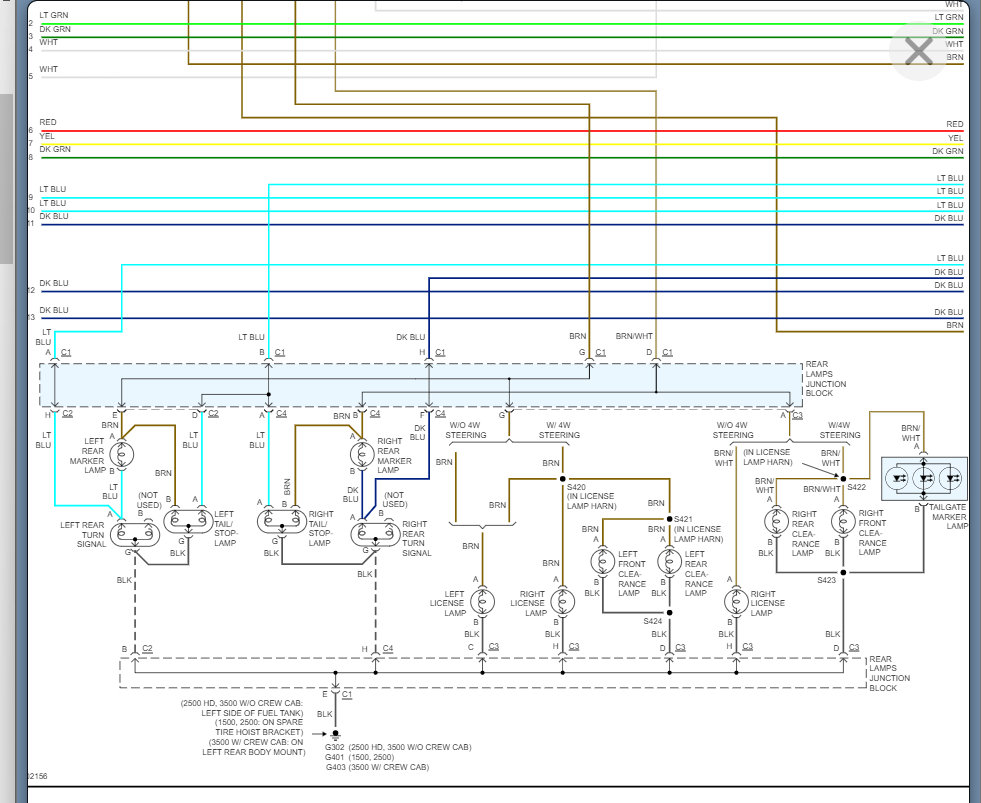

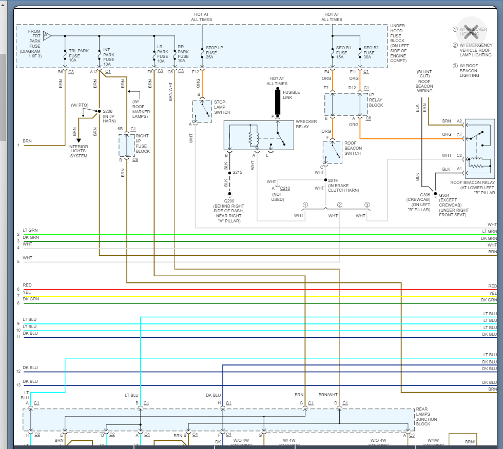

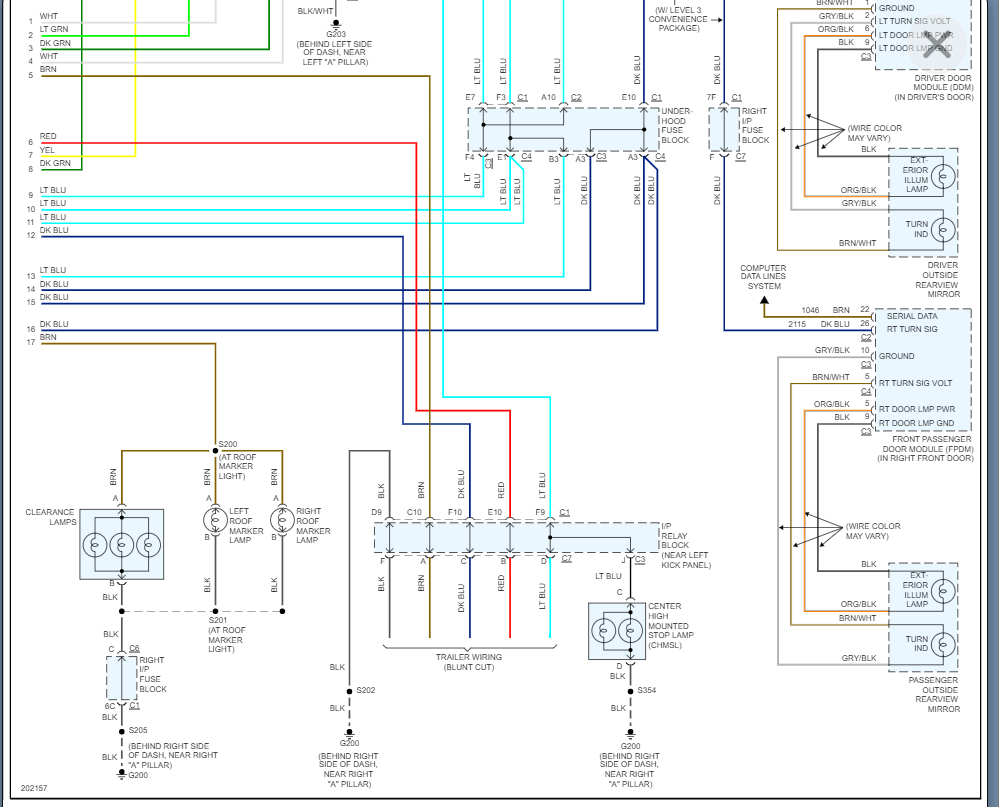

I tried to test the voltage for a trailer electric hook up. There is no voltage to the power pins on the junction box.

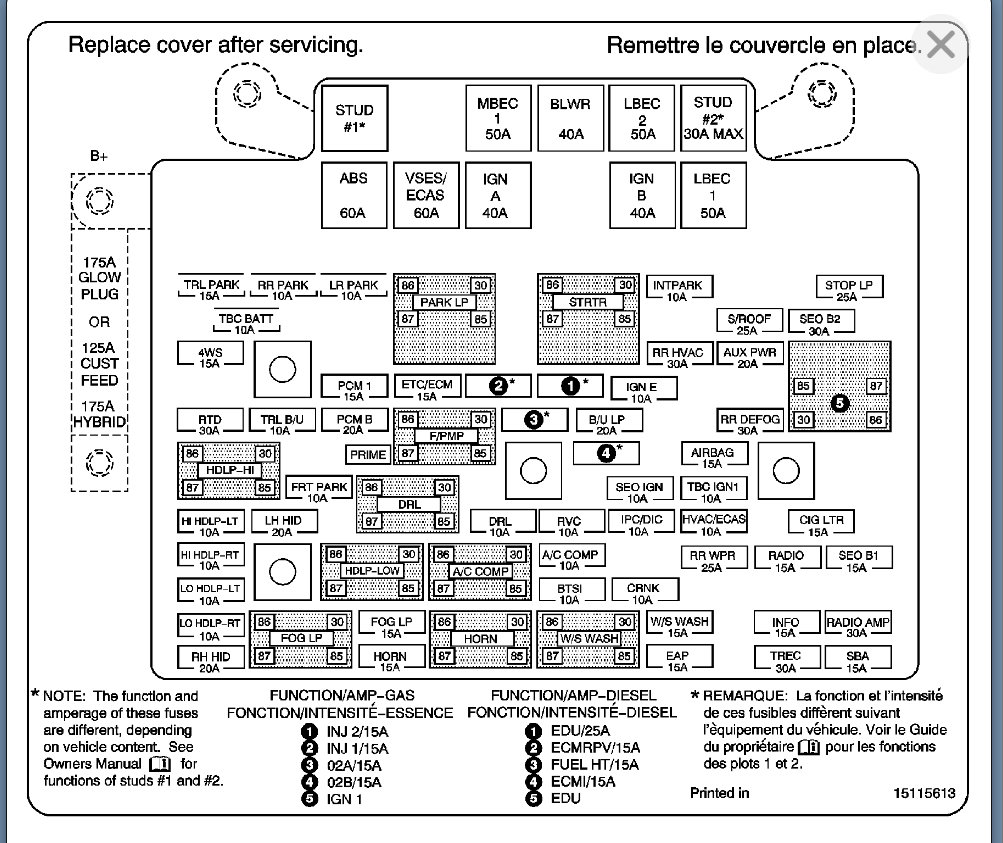

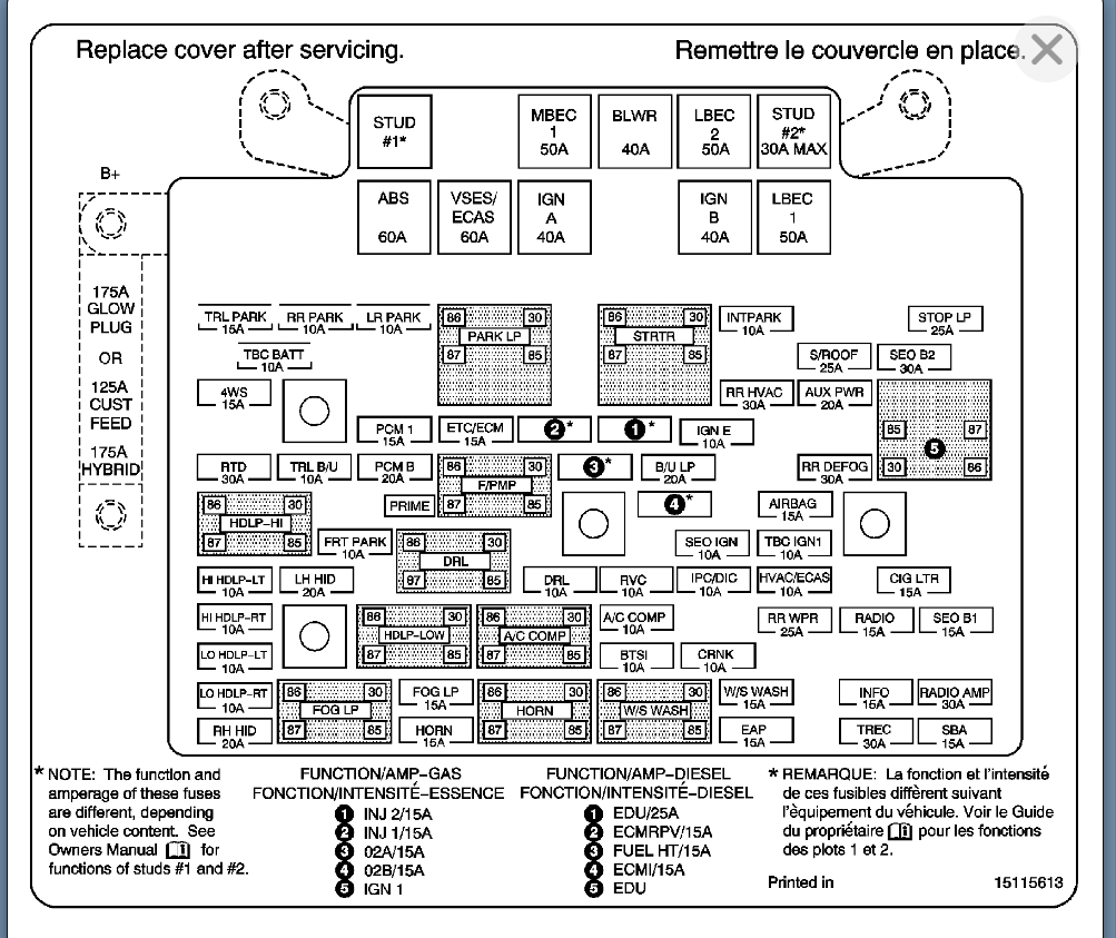

If so, we need to check the fuse in the under-hood box that is the 40-amp fuse labeled stud 1.
If you have power here, then we should have power to the connector. If you don't then you have ground issue or a wiring issue.
