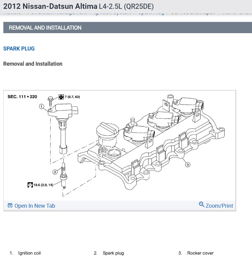

Hi, my car is jumping when I accelerate too fast. The check engine light isn't on, and I just got my front and rear shocks replaced last week. It doesn't jump every time I accelerate, just when I do so too quickly. I haven't noticed any noise or smell when it does it either. What does this mean?
Aug 14, 2023 at 11:50 AM
  • 55,721 POSTS

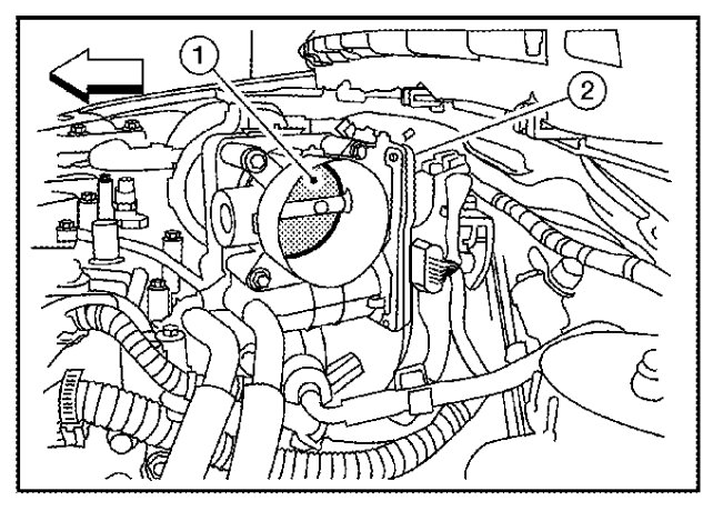

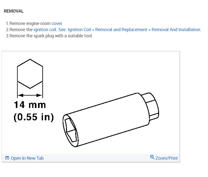

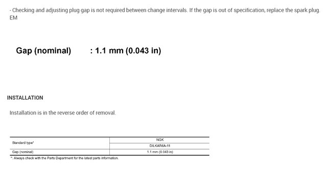

This happens when the engine starts to misfire. I would do a full tune up with a throttle body service. here are two guides to help you fix the problem:
https://www.2carpros.com/articles/how-to-tune-up-a-car-engine
