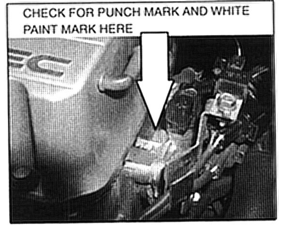

There is a service bulletin to improve the idle quality which requires an ECM update and replacing the camshaft.

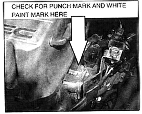

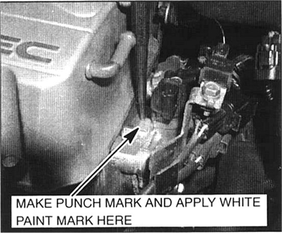

1.  Inspect the rear of the cylinder head for a punch mark with white paint.
    a.   If there is NO punch mark with white paint, go to Step 2 for camshaft replacement.
    b.   If there is a punch mark with white paint, go to Step 3 for valve clearance adjustment.

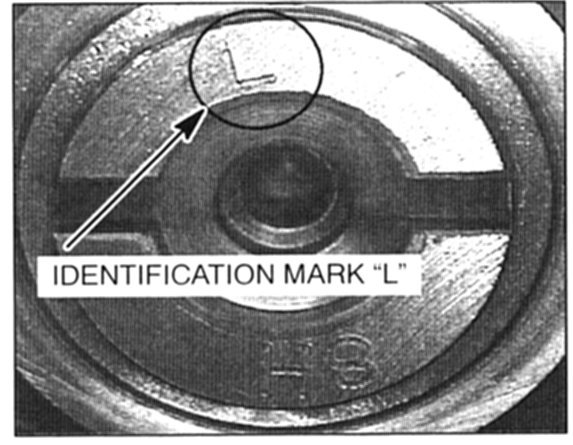

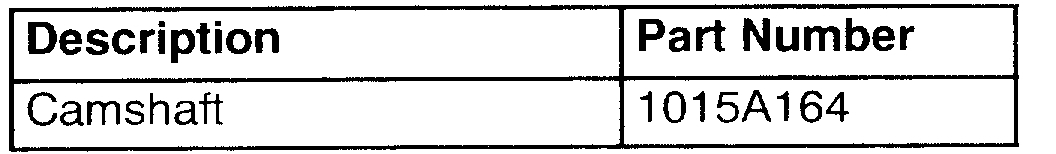

2.  Replace the camshaft, using the part listed in the PARTS INFORMATION section of this bulletin. The new camshaft has an "L" identification mark.
    Refer to Group 11 A in the 2004 Galant service manual for replacement procedures.
    IMPORTANT
       Replace the camshaft and reprogram the PCM only if the VIN is before 4E107228 (Federal emissions) or 4E108924 (California emissions).

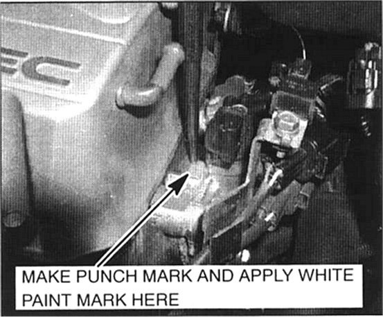

a.   To identify the new camshaft for future servicing make a small punch mark at the rear of the cylinder head, then apply a white paint mark over the punch mark.
         Continue with Step 3 for valve clearance adjustment.
3.  Adjust the valve clearances to the following cold specifications:
    Intake: 0.11 mm (0.004 in.)
    Exhaust: 0.20 mm (0.008 in.)
4.  If the camshaft was replaced, reprogram the PCM as described in TSB~04-13-010.
