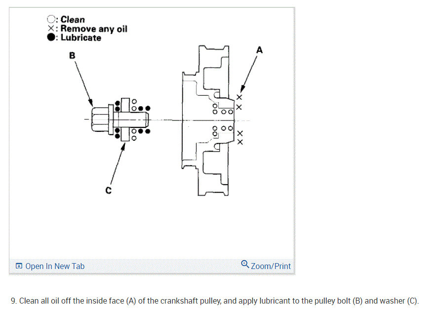

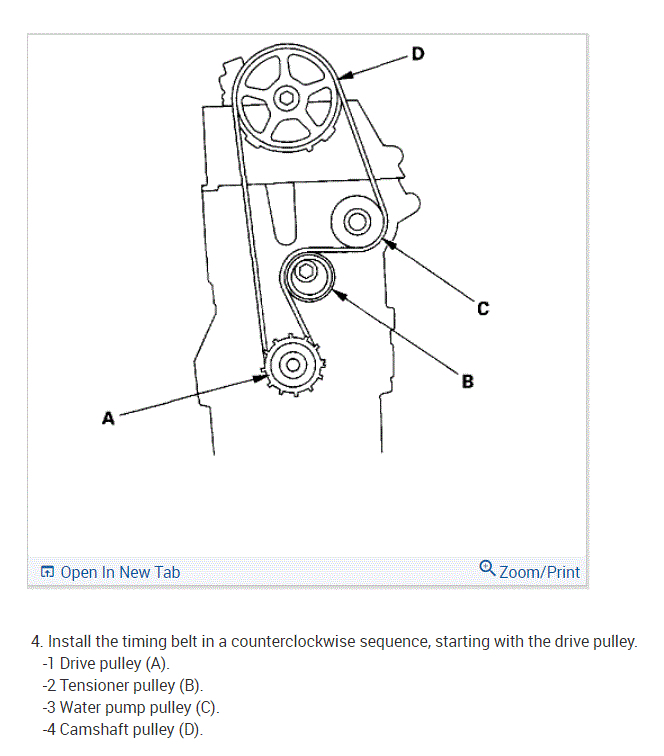

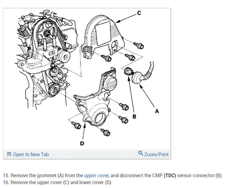

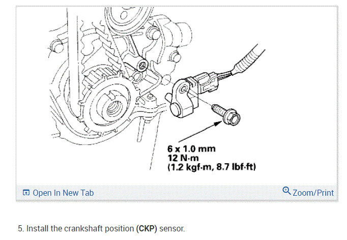

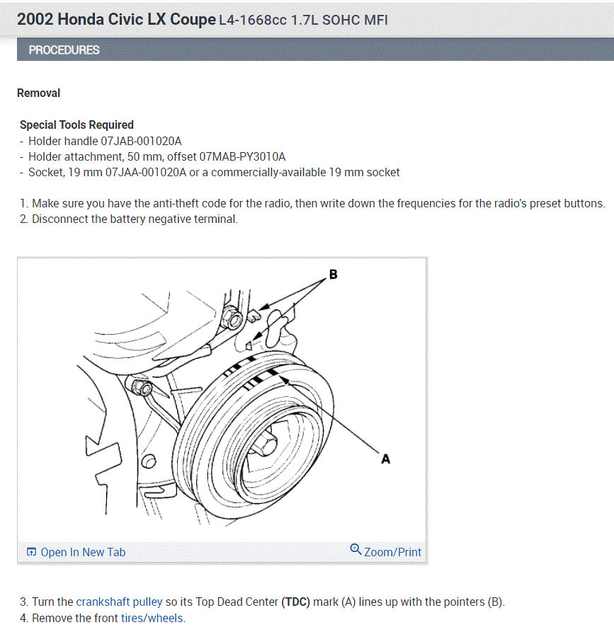

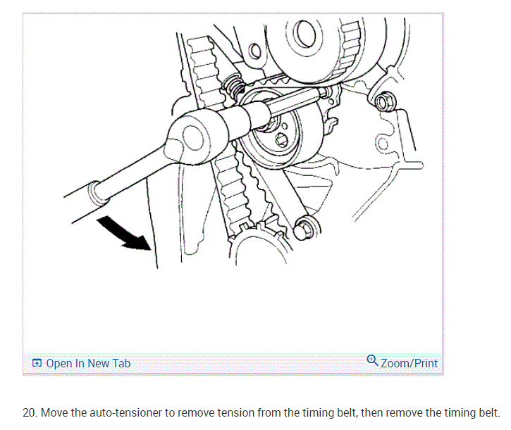

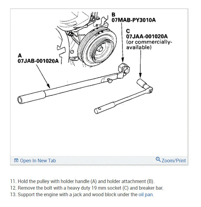

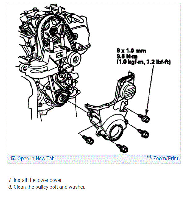

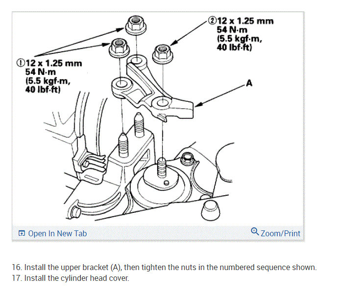

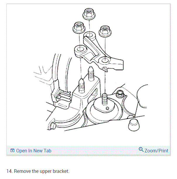

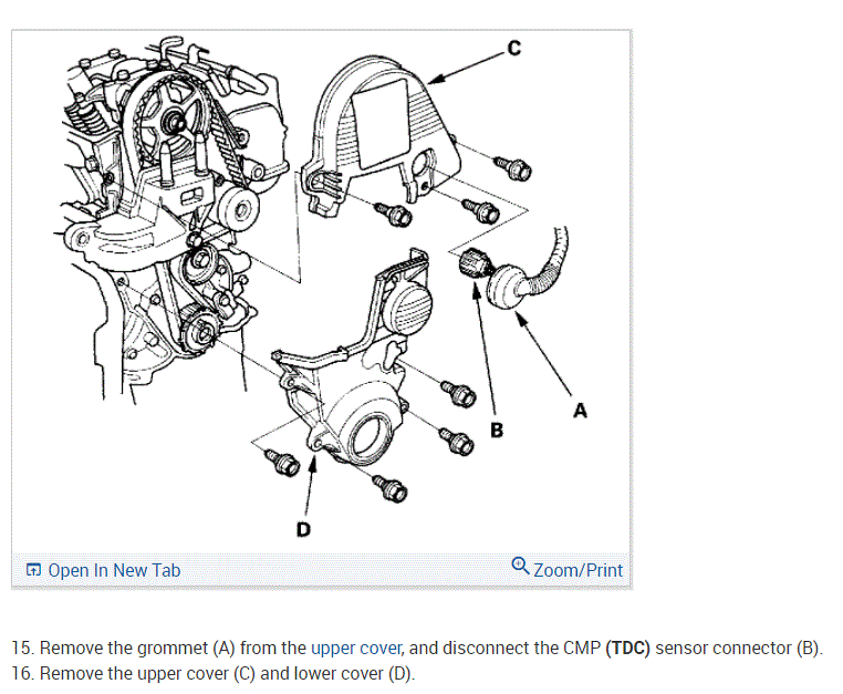

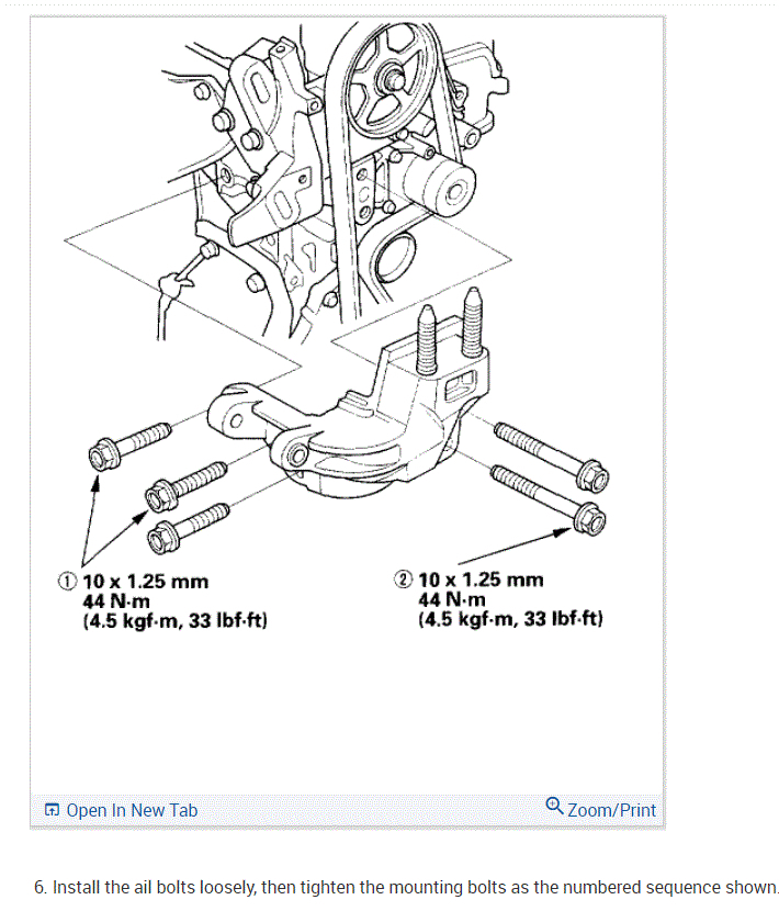

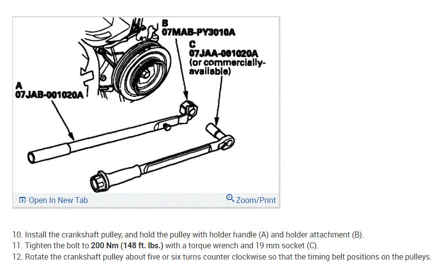

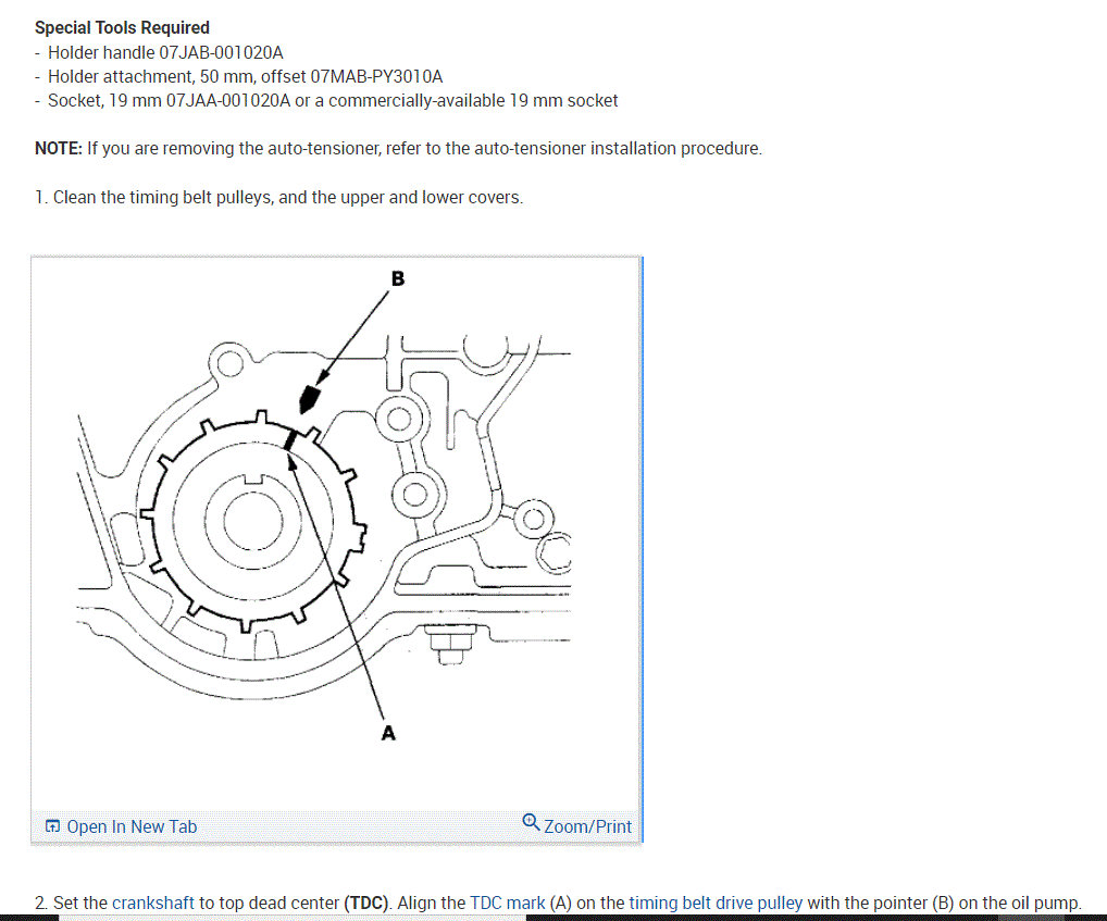

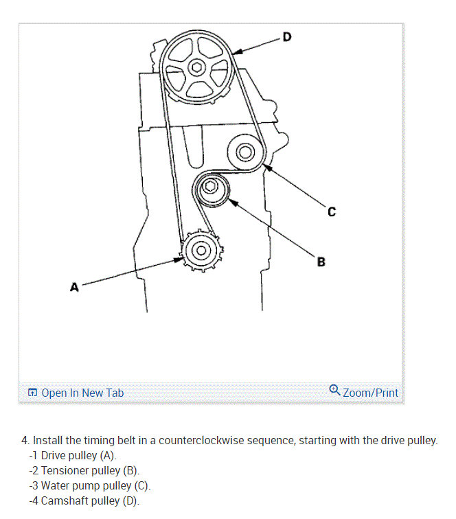

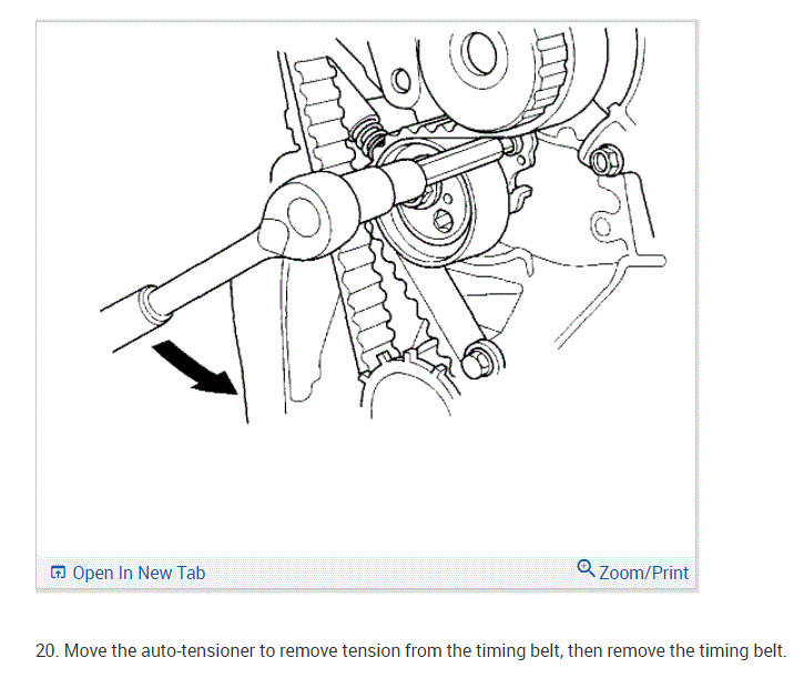

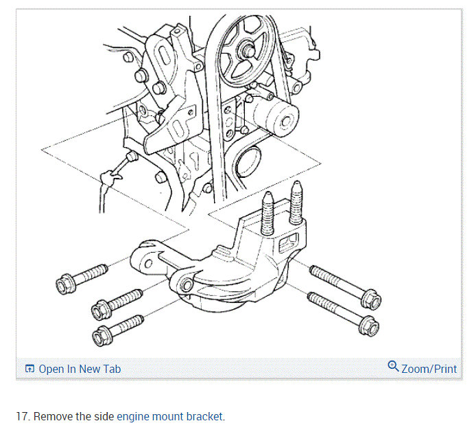

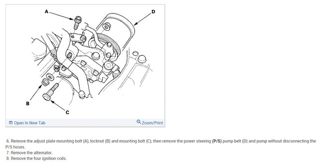

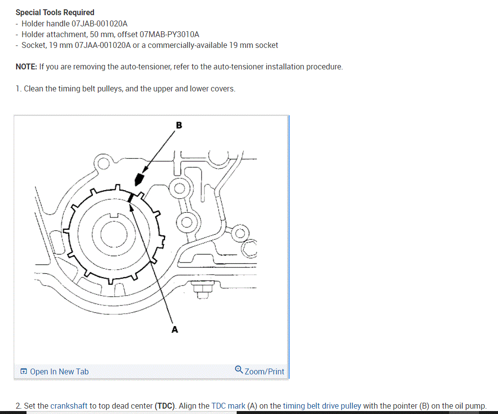

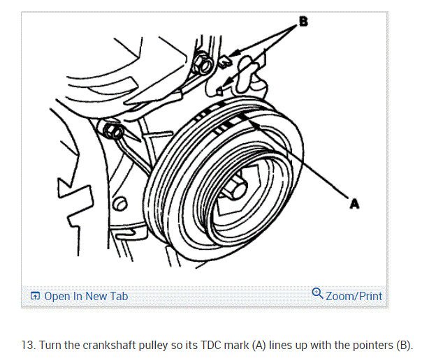

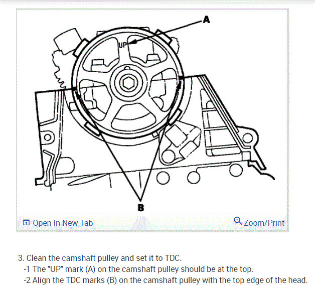

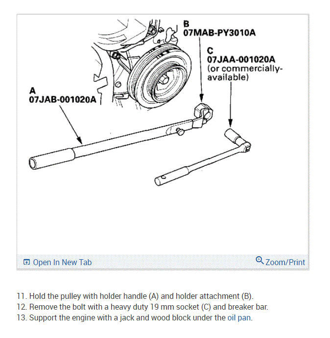

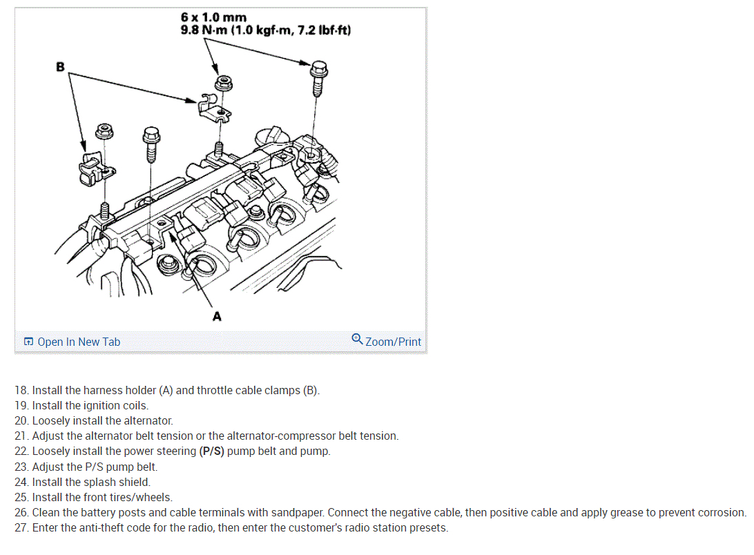

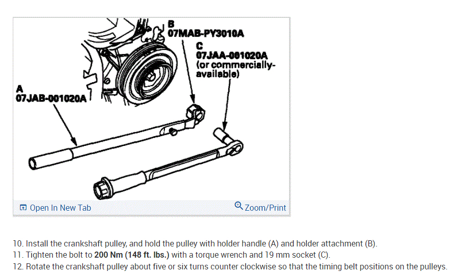

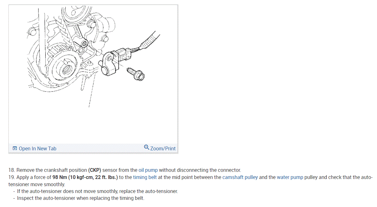

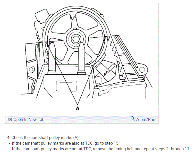

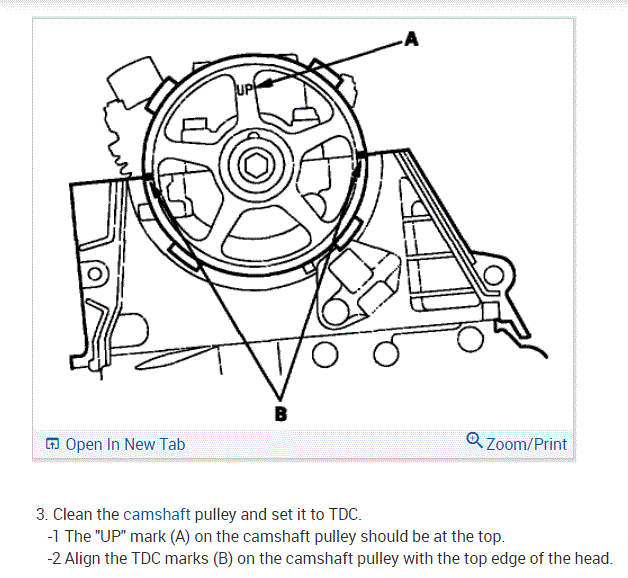

The car started backfiring. replaced timing belt. Now the key doesn't want to work or it just wont stay running.
May 29, 2021 at 4:43 PM
  • 110,194 POSTS

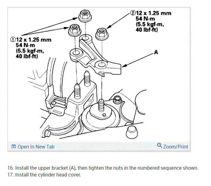

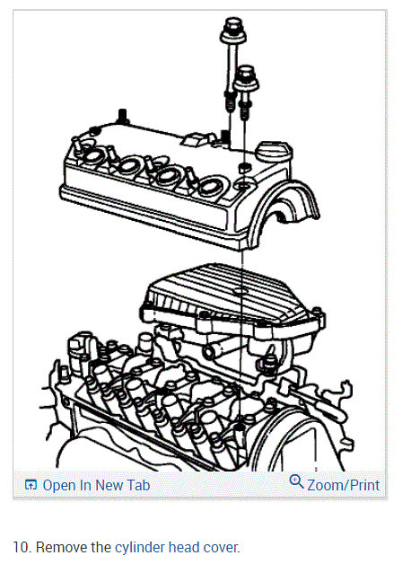

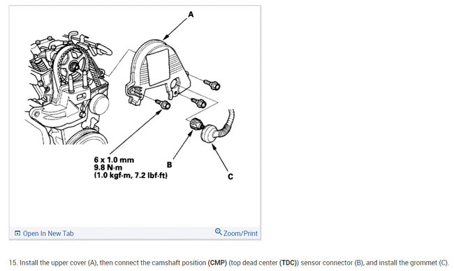

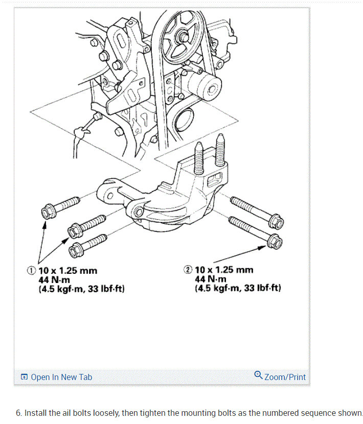

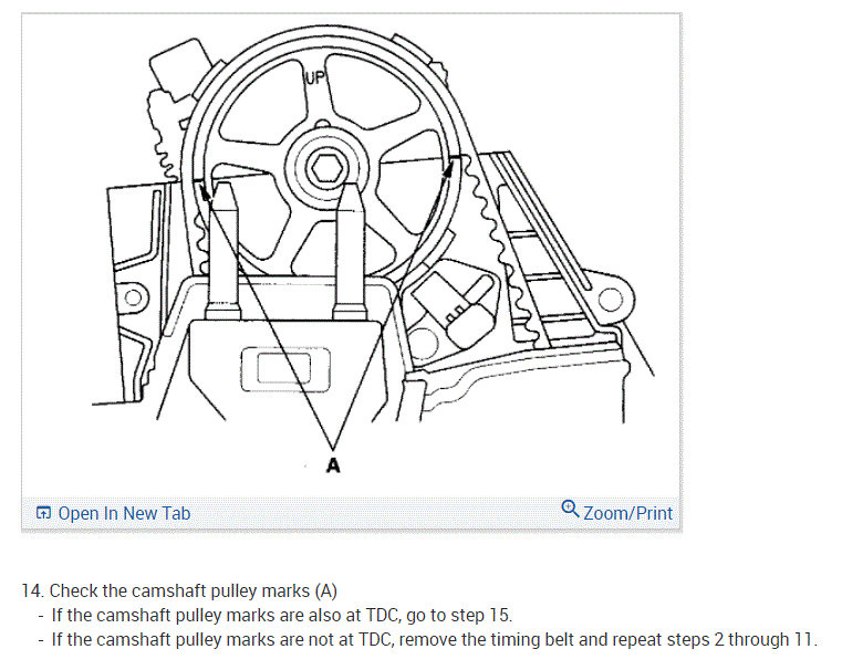

Are you able to keep it running? Also, how far did the timing jump? All but a couple of v6 Honda (3.0L and 3.2L) engines are interference engines. Something internally may have been damaged if the belt broke or jumped.
Do me a favor. Record it cranking and starting and upload it for me to hear.

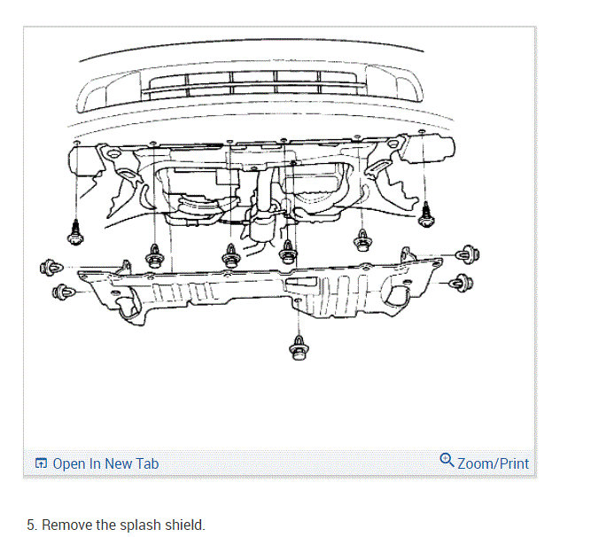

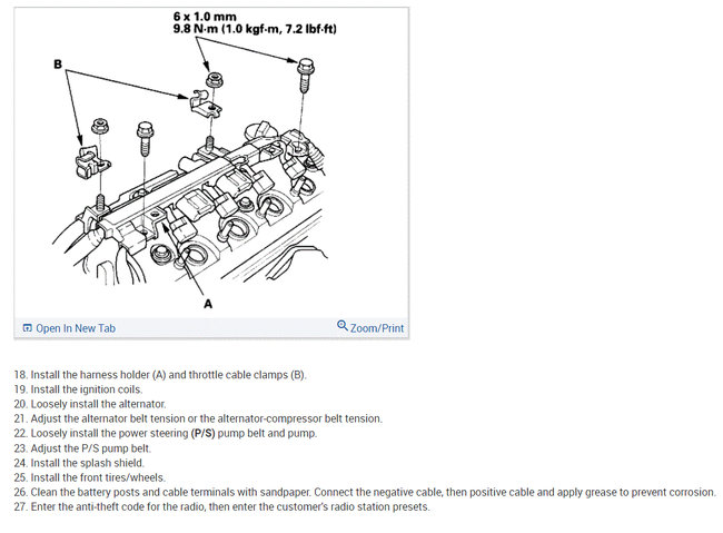

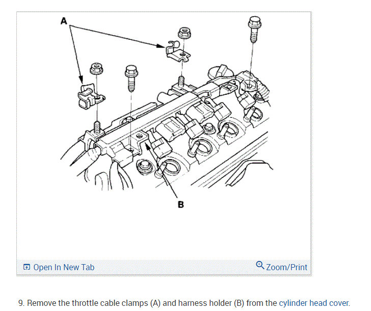

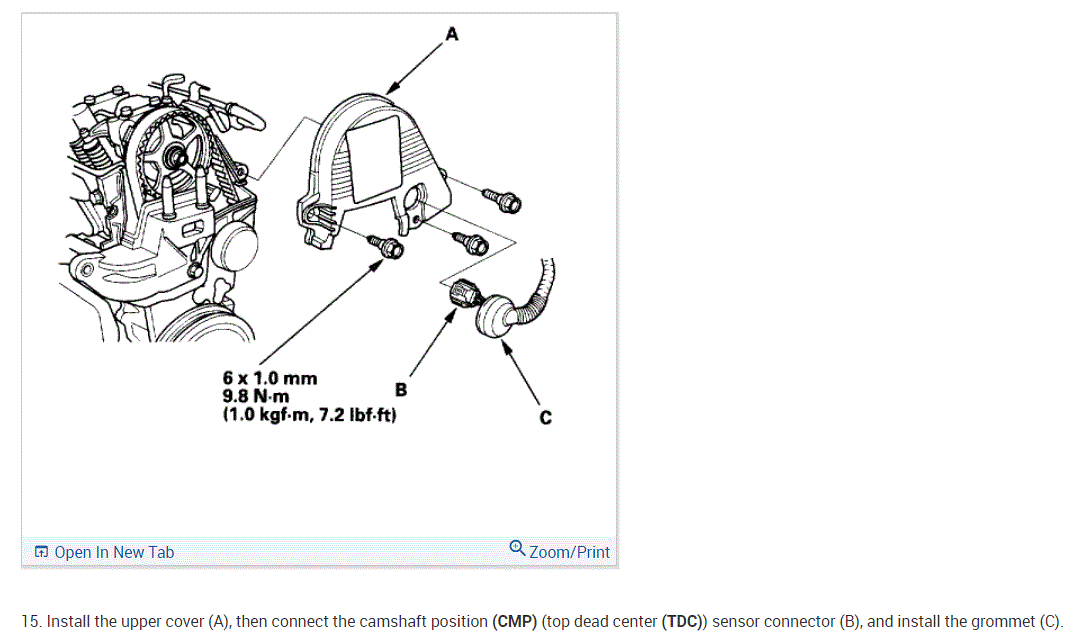

I attached the directions for belt replacement below. Review them and see if there is anything you missed.
