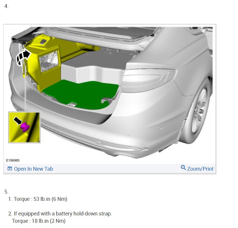

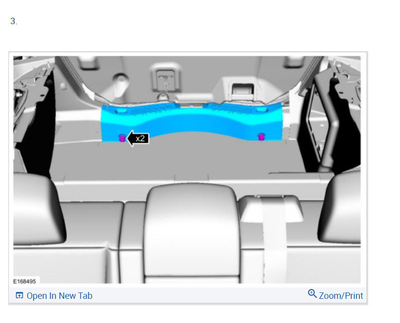

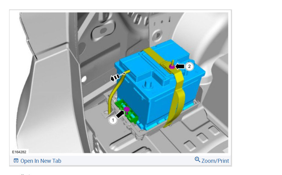

Can my car listed above be jump started by a 2017 Chevrolet Silverado?
May 20, 2021 at 2:01 AM
Experienced Mechanic
55,627 POSTS

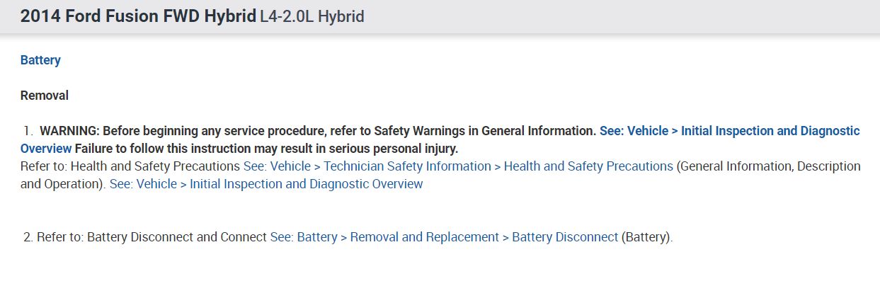

Should be able to. this video will help with the battery location in the diagrams below:
https://youtu.be/a9Ycibu9cwY
Images (Click to enlarge)
