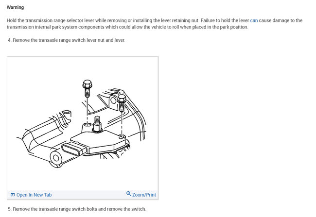

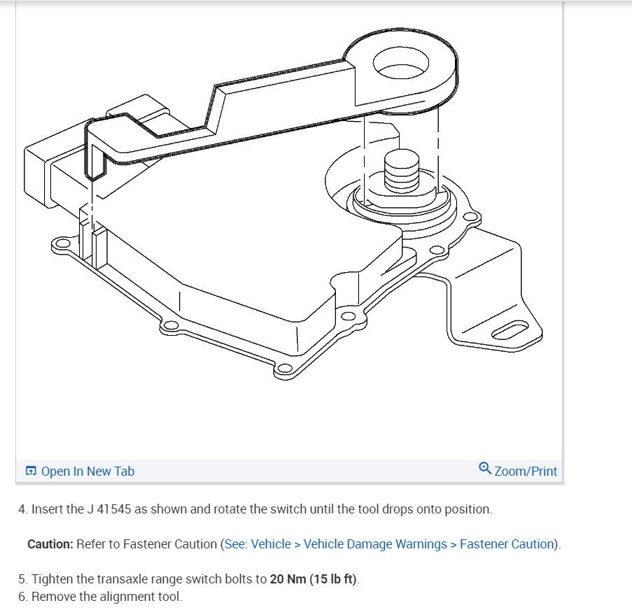

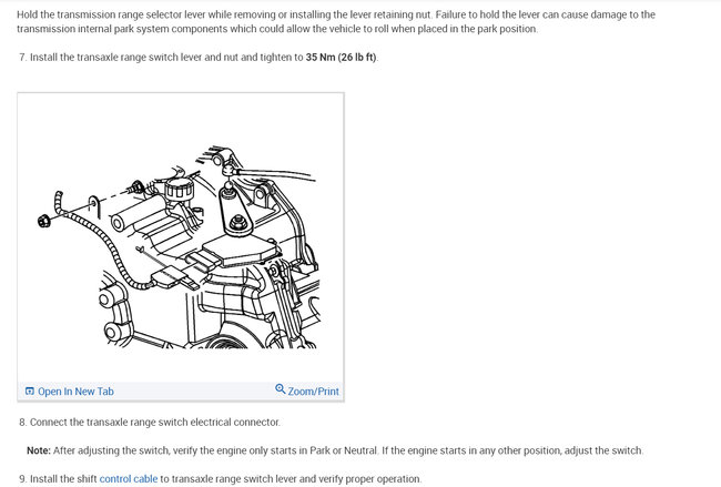

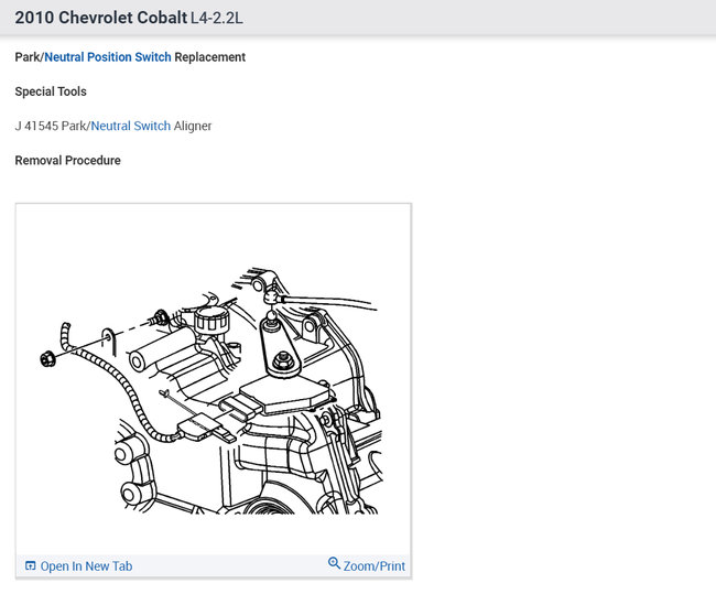

I am trying to repair the transmission on My granddaughter's car. I put two shift solenoids in it and put it back together. No more check engine lights on anymore. I found, as others did too, that when I have it in park it works but all the other positions make the car go forward. I was checking the different gears and I found out that each gear except park makes the car go forward even reverse. In researching I saw other posts that spoke of the pnp needing a tool that indexes the shifter. It said it is a J41545. Where can I find one of these? Thank you

Here is one from eBay for $75.00:
https://www.ebay.com/itm/265839514803?chn=ps&norover=1&mkevt=1&mkrid=711-117182-37290-0&mkcid=2&itemid=265839514803&targetid=1645685074768&device=c&mktype=&googleloc=9031538&poi=&campaignid=16730423415&mkgroupid=135815925780&rlsatarget=pla-1645685074768&abcId=9300841&merchantid=118858209&gclid=Cj0KCQjw0oyYBhDGARIsAMZEuMu2vWaPnd_ThsCO4S2s4391QPaP6fIXs3Vd8Q6rUe_S04KXGZ6faaYaAuSYEALw_wcB

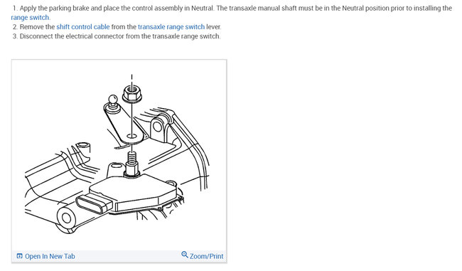

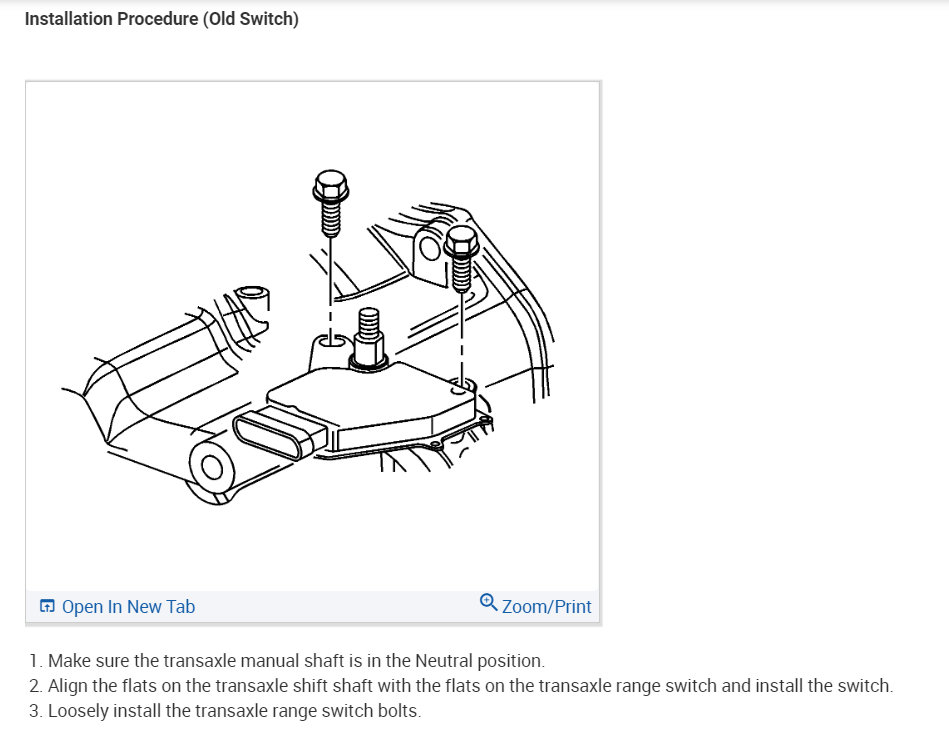

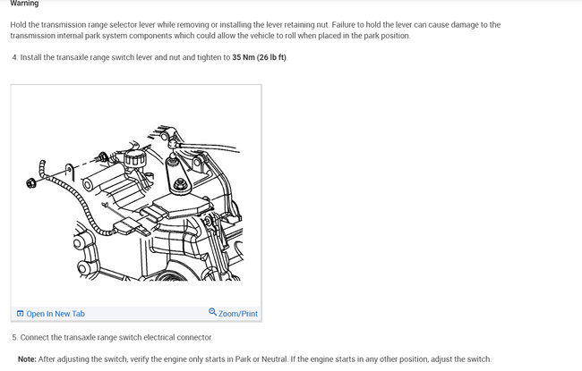

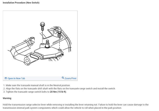

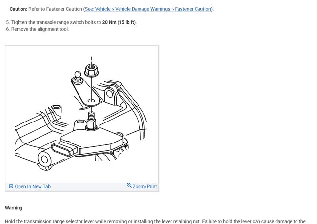

Here is how to use the tool when setting up the gear range sensor/switch. Check out the diagrams (below). Please let us know what happens.
