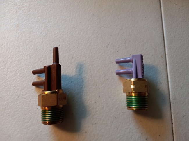

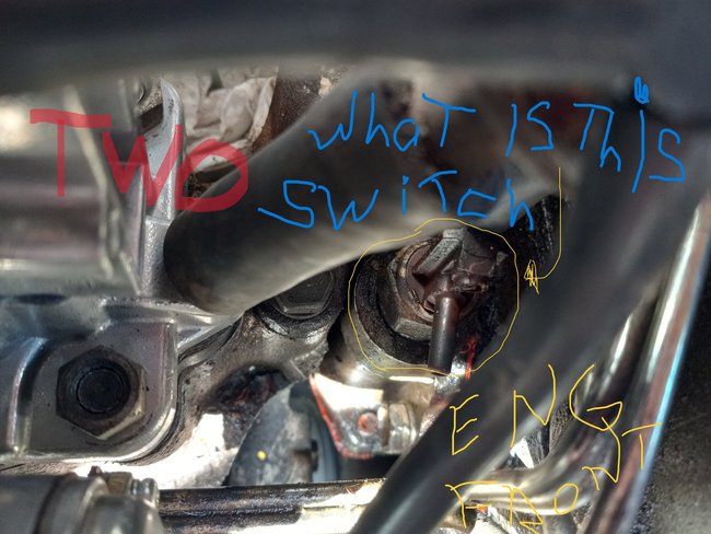

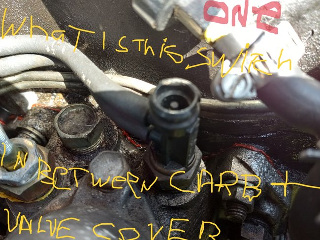

Joe, what are the switches in the two pictures? Remember this is the 1993 engine that was converted to a carbureted engine. So, do I order a 1993 engine or the 1987?
Thanks Joe.
PS,
Picture, one has three lines running to it.

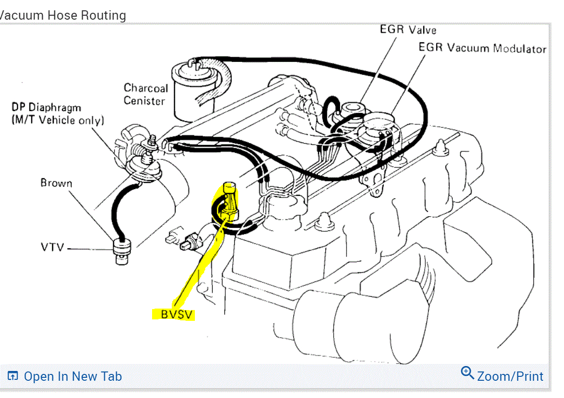

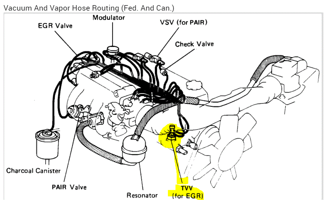

Pic 1 is the BVSV (pic 1 below) and I can't tell the location for sure in the second pic. I do see a vacuum port on it, but I believe it is a temperature vacuum valve. Take a look at pic 2.
Note that I'm only seeing two vacuum hoses to the BVSV. There should be a cap on the top of it.
As far as the year is concerned, since you basically have turned 1993 into 1987, that is what year I would go with, the 1987.
Let me know if this helps.
