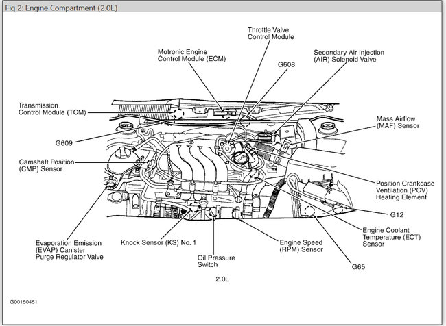

Engines starts and runs for approximately fifteen minutes. Then it shuts off and will not start for forty five minutes.
May 2, 2018 at 5:06 AM
  • 55,748 POSTS
This sounds like a crankshaft angle sensor gets hot and quits which will make the engine stall. Here are two guides one to show you what you are in for when changing the sensor out and the other which will run you down all most of the possibilities:
and
https://www.2carpros.com/articles/engine-stalls
Here is the location of the sensor,l they call it an engine RPM sensor.
Crankshaft Position Sensor - 06A906433C - $154.95 list you can get it cheaper on Amazon.
