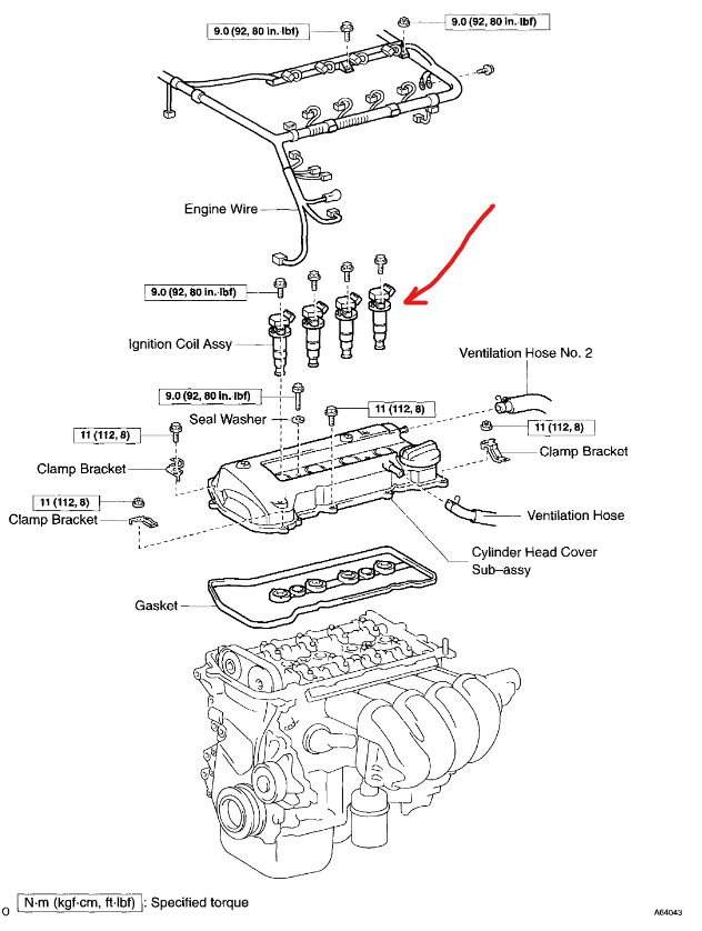

I have just finished a engine overhaul. A week ago-my Tazz 2E 1300 suddenly started jerking when pulling away. once at speed she isn’t jerking as bad the Oil light on the dash is also blinking intermittently and fuel consumption is high. I am getting about 150km on 19 liters.

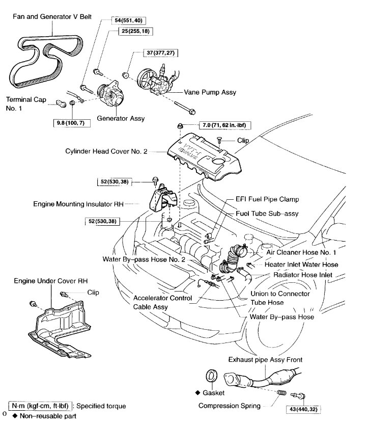

The jerking can be an engine misfire, I would run the codes to see which ones are stored, I can tell you a cracked spark plug or bad ignition coils is common for an engine misfire. These guides can help please go over them.
and
RECOMMENDED SPARK PLUGS:
. .................... SK16R11 (DENSO made)
. .................... IFR5A11 (NGK made)
Check out the images (below). Please upload pictures or videos in your response of any problems so we can see what to help you with.
