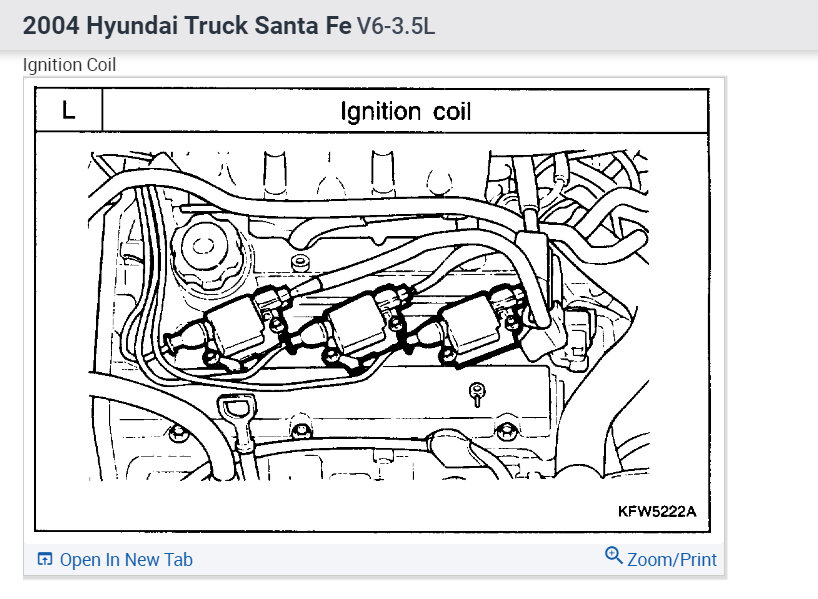

Starts drives but will start idle high jerking then check engine light comes on then jerks and stops and light goes off. When on freeway 60 MPH it idles 5,000 RPMs and doesn't seem to shift. Transmission fluid is dirty. Other than that, it's fine.
May 6, 2023 at 7:53 PM
  • 55,721 POSTS
This sounds like an engine misfire which can be intermittent. I would start by doing a tune up which this guide can help with including ignition coils:
https://www.2carpros.com/articles/how-to-tune-up-a-car-engine
This guide can help as well:

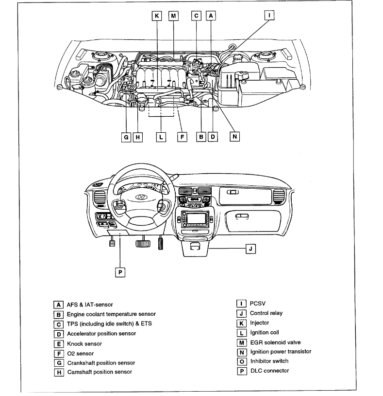

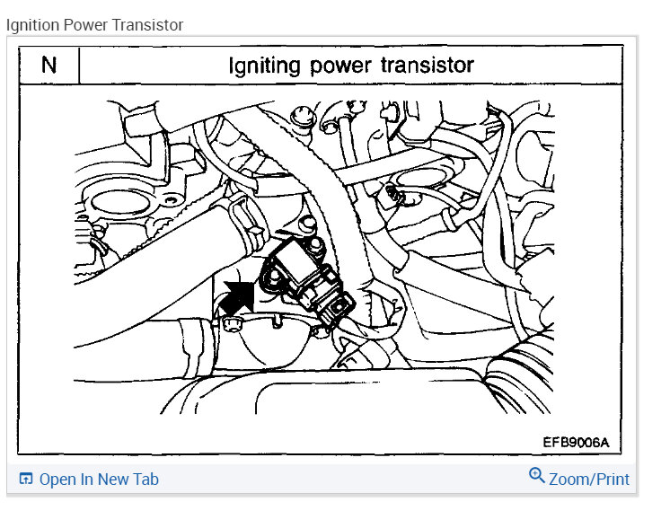

To confirm the misfire the PCM has stored the code for retrieval.
NGK .................... PFR5N-11
CHAMPION .................... RC10YCPB4
Gap .................... 1.0 - 1.1 mm (0.039 - 0.043 in)
Here are the instructions for your car in the images below. Let us know what happens and please upload pictures or videos of the problem so we can see what's going on.
