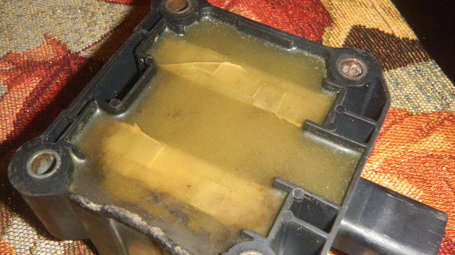

Thanks, Ken. I bench tested the ignition coil pack. First, I can see cracking inside the coil pack. When I test it, my primary readings are 0.9, which from what I can find is too high. My secondary readings are 11.4, which looks within range. So this looks like it has gone bad to me. So I am off to buy a coil pack, and I will let you know how it turns out. I hope this fixes the thing! I never would have thought the ignition coil would cause it to jerk like that. Don't go away yet, though. I'll let you know how it turns out.

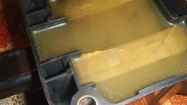

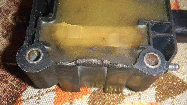

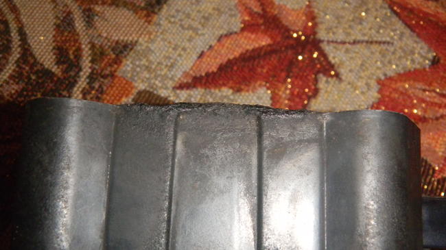

Thought I would add a couple of pics to show you the old ignition coil. Just to make sure this is what is meant by it being cracked. Just to give a visual, and try to confirm that was at least part of the problem. I also noticed one side of it is kind of melted. I assume that can't be good. I attached a picture of that too. Any idea what could have caused that and if it could be linked to the car bucking and lurching and jerking and driving me nuts? Thanks again for your help. If this is getting too in depth, I can make another question and donate a little more. I know it's the holidays and people are busy, but I really appreciate your time. Thanks again!

Hi Hugaporcupine83,
Sorry for the slow response, thanks for the pics you can see the arcing which is not good, but you can return it if needed, btw did you replace the spark plug wires when you did the coil? Also can you recheck the spark plugs, the oil down inside the well can cause the misfire, if there is oil present, replace the valve cover gasket and clean the plugs, please let me know how it goes and have a happy Thanks Giving :-)
